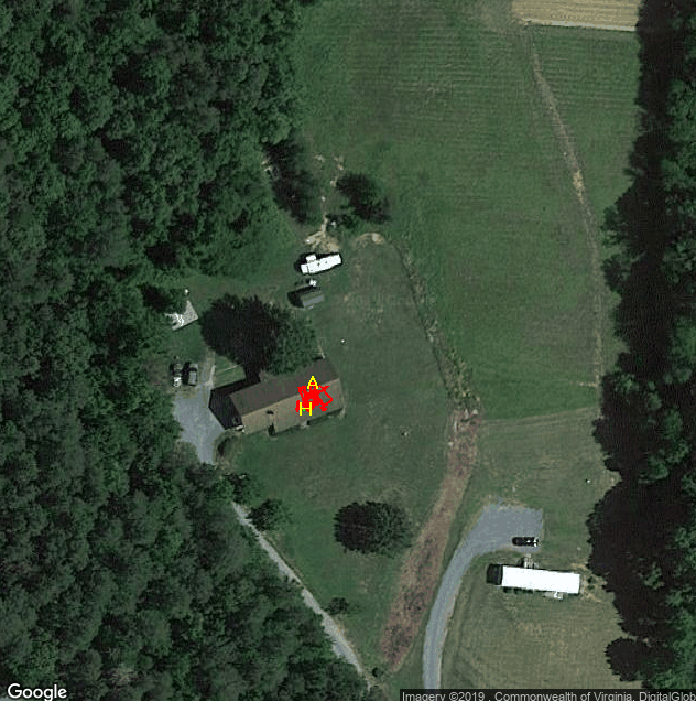

Plus that pic is not my house. Maybe my daughters house. The date and time has to be wrong on the aircraft.

Oh sorry now I can see it better. That is my house. But I definitely did not fly it indoors.
That is over the room where my pc that I connected the p4 to. Whould a Simulator run look like that?

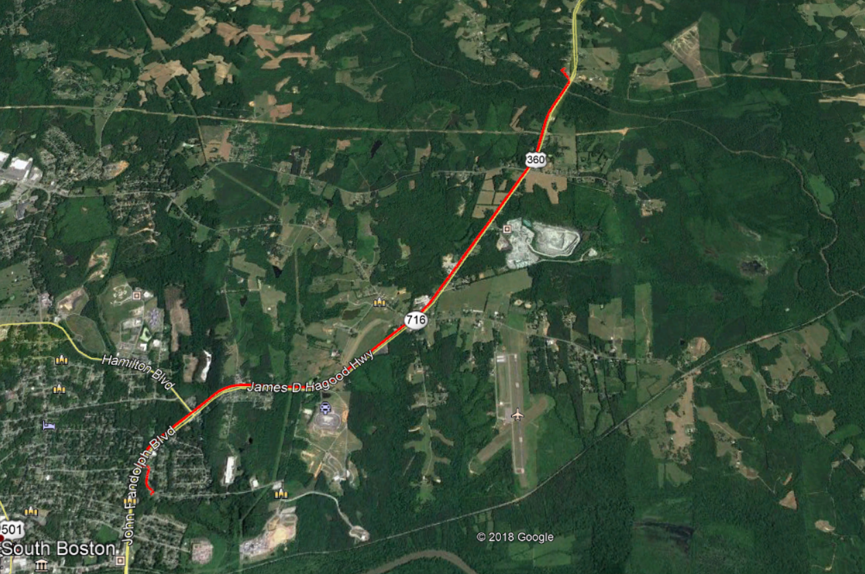

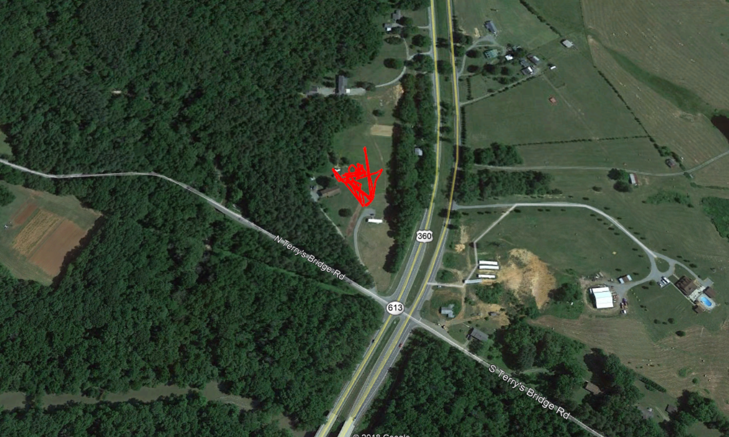

You need to look for additional .dat files after the ones you uploaded. We have everything from FLY023 to FLY037....Nothing in these are related to the shutdown. These two images below ( According to the log file dates ) are both from March 28th flights if this helps with the date's in question.
FLY023
FLY025
@Klloyd99 .....and Yes, upload the device log as well. We can compare the dates there as well. If you locate the log file from the incident we will know which .dat file you need.
The first pic was at my house. I didn’t fly at my house that day and the second was when I went to my daughter house to use the Internet cause mine was acting up I left there and went to the store but I’m pretty sure I **** the unit down but by the pic it looks like I didn’t. Either I accidentally downloaded the wrong date or the date has to be wrong on the drone
@Klloyd99 ...That explains why that FLY025 data was so odd. I thought that you may have left the aircraft on in transit since there was basically no altitude data at all. That was about 20min worth of data. Like I said before, if you upload the device file from the incident, we can tell you which .dat you need and compare the dates. Also, did you make a firmware update on or about the 28th or 29th?
