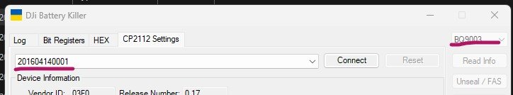

Did you Unseal the battery?
I did have to play around with the 2 settings that I underlined in the attached screenshot of DJI_Battery_Killer
Once you connect successfully, you should be able to unseal the battery, clear the PF flag and then reseal the battery.
I selected the serial number (9999 other choices, selected the BQ30Z55 CHIP and then selected Read Info. That is where the errors showed up at the bottom of the log.

I finally figured out what was wrong. First, the leads needed to be on the inside pins on the CP2112. Second, I found some information on how to remove the PF flag by manually writing with OO OO24 command in the bottom window and then again with 00 0029 write commands. The reset was a success and is now taking a charge.
Thanks so much for the help! I hope this might help someone else trying to do the same with a P4 battery.
