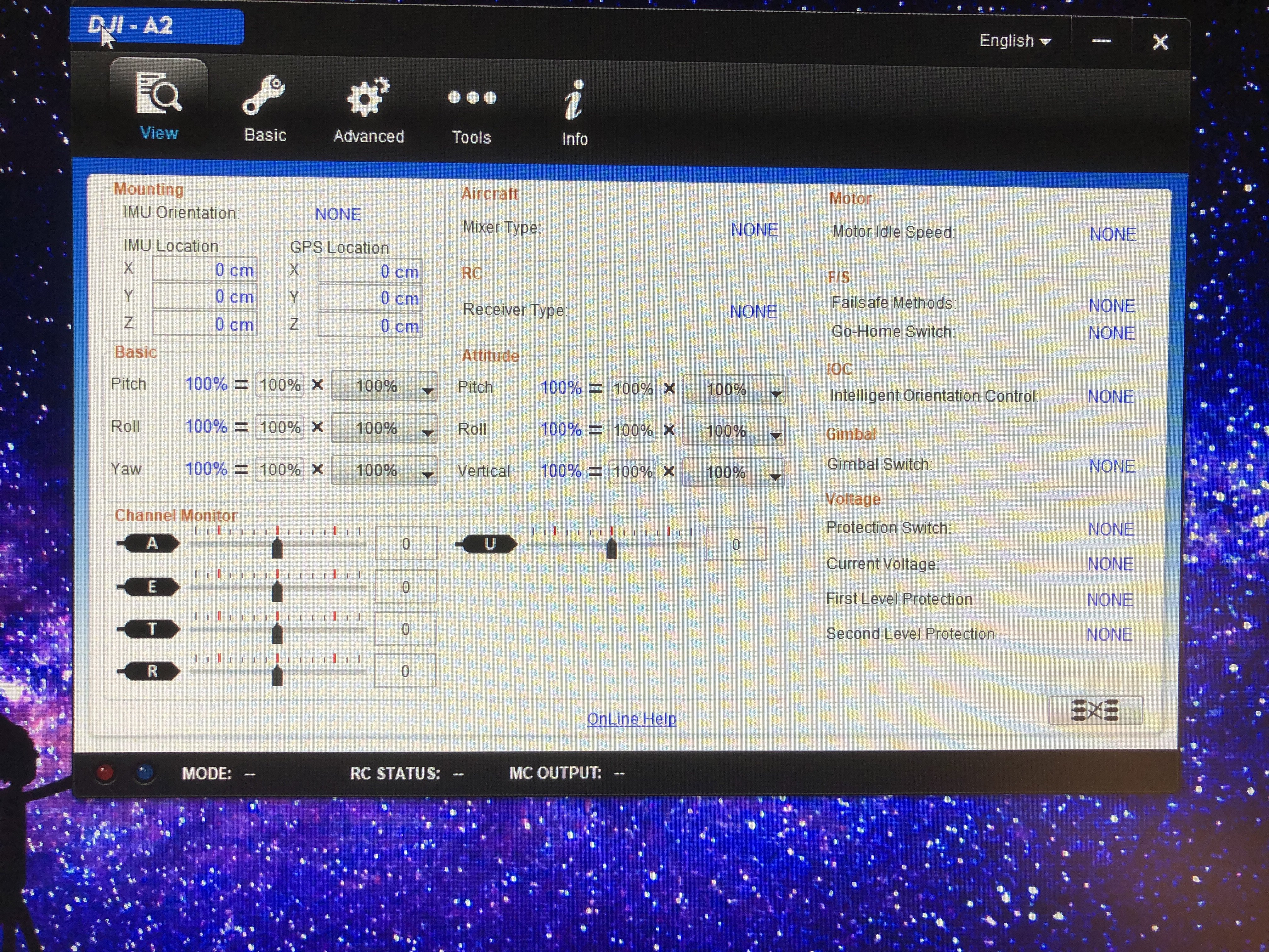

I have the aircraft connected to the computer and the app up and it’s not recognizing it.
Do you have the aircraft powered up?
Make sure you have the new version. Then take a look here: ( Tutorial Video )... P4 .Dat Extraction

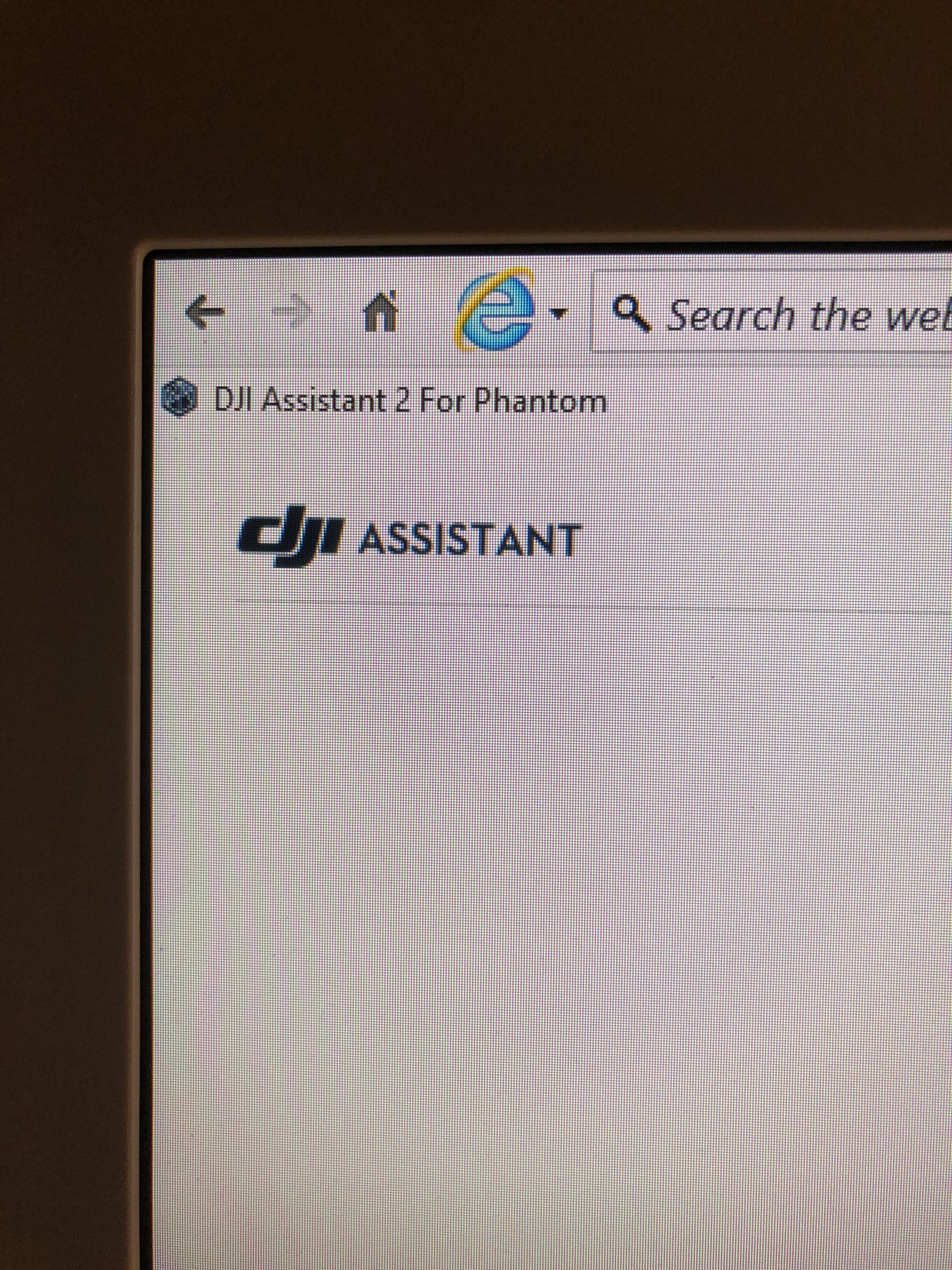

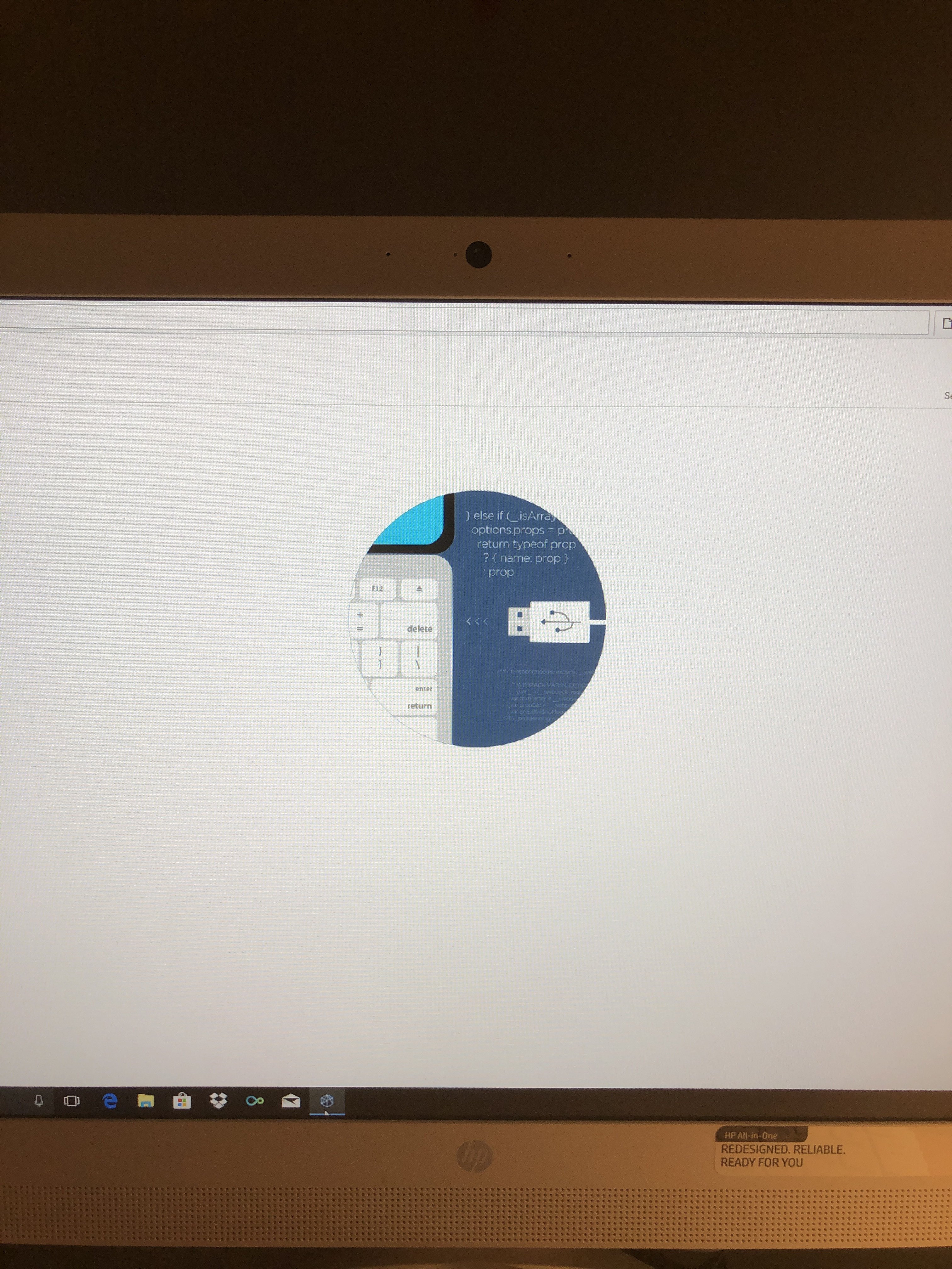

I did both. One was like the pic I sent u and the other looks like this which I don’t have anything to click on
First, after install, reboot your PC. Second, after re-boot, connect the aircraft via USB. Third, Power on the aircraft ( You may need to also start the RC ( See the video link above Post #12 ). Fourth, Start Assistant 2. See if that sequence works for you.
