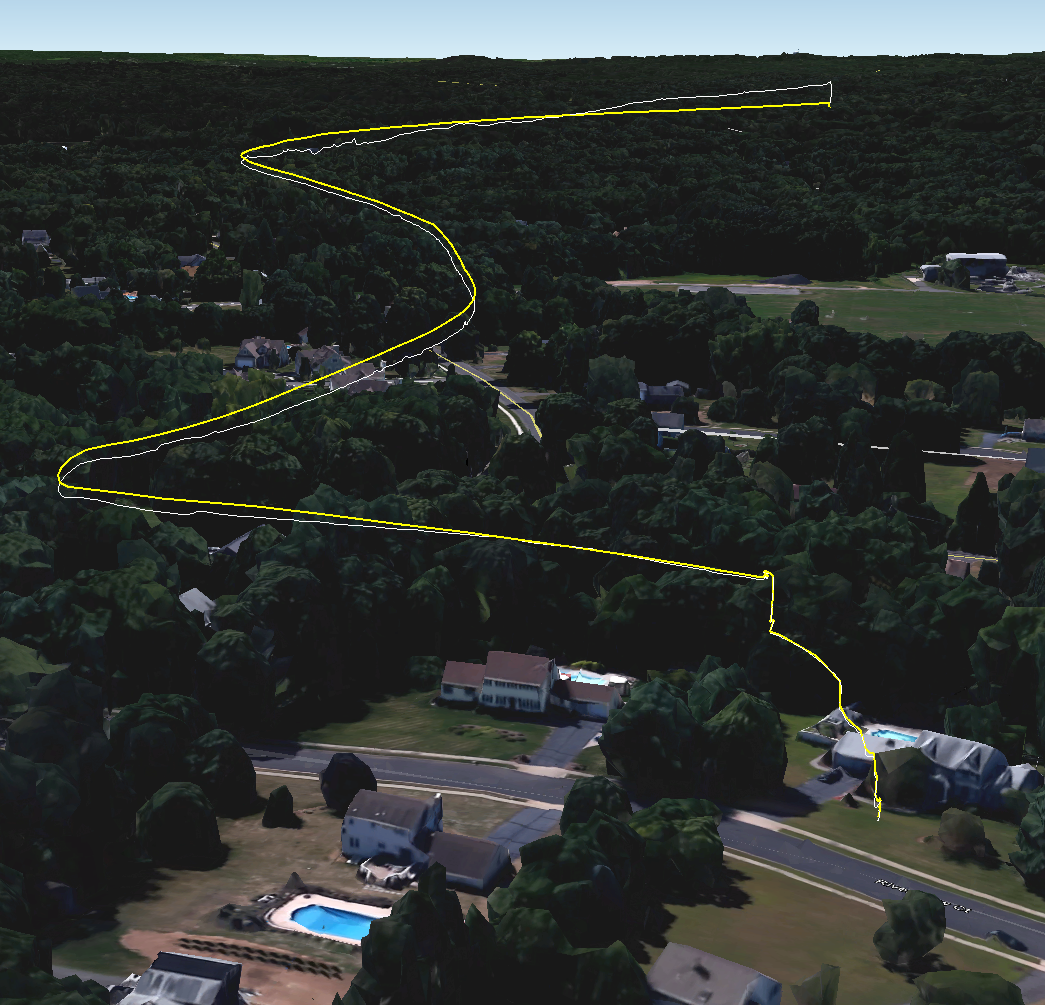

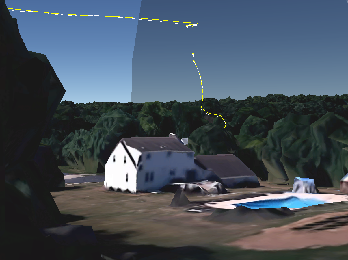

So both KML files have equivalent height, though it appears that the HealthyDrones accounts for HP elevation (somehow?). My guess then is the debate irt the crash into the trees or into something above the trees is a matter of visual perspective. Can you run the HealthyDrones KML through Google Earth and screen shot it w/ the same perspective as the one you did? I have a feeling they are going to be equivalent.

Both paths overlapped, same perspective
And the entire flight overlapped
There are some dicrepencies, but I would bet thats only because one KML is a LOT bigger than the other, leading to more guesses for the healthydrones file
That first image is the LAUNCH point.
There is a big difference between the crash points. The djilogs KML shows the drone is much higher, and falls further. The HealthyDrones file shows it much closer to the trees, and less of a descent.
