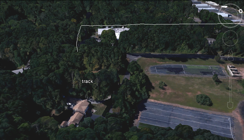

To me it looks like this is where you started to have signal loss issues:
And this is the corner it crashed. Probably into that very tree.

From Google Earth. This shows the trees you hit:

This really makes it look like the crash was due to my misunderstanding of the elevation; specifically thinking it was relative to currently location, not starting location.

From everything I've been shown/I can deduce, the crash was due to me hitting a tree because I thought I was 47M above the current location, not 47M above my starting location.
47M = ~155Feet.
There was a ~120 foot elevation change between the launch point and the crash point. That puts me at ~35 feet? Above trees.

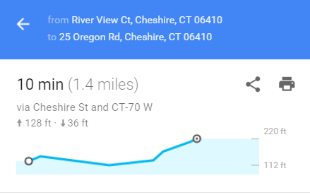

I haven't dug into the actual log file, but just based on your flight path, there is a 128ft change in elevation from your HP to your CP.
That was my first impression but I didn't know what his elevation change was. Good find bbfpv

I've attached an image showing the KML exported from djilogs.com. This one shows me WAY above the trees with a much sharper drop. Any idea why this would be? Which one is more accurate?

Is that likely at night? Either way, it looks like I hit *something*. What I don't like is the disparity between the djilogs.KML and the HealthyDrones KML. If anyone has any insight on this I'm all ears.
