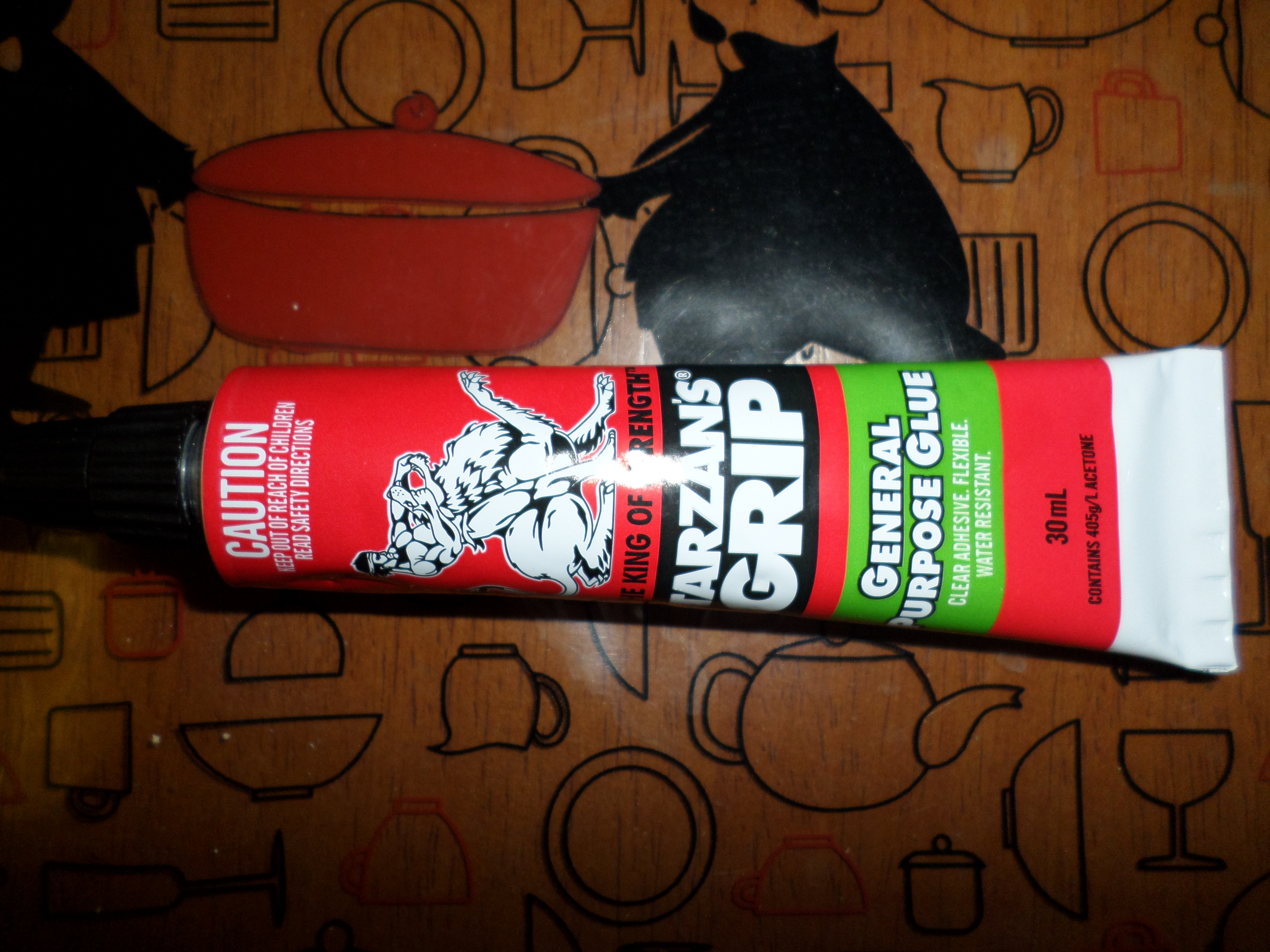

Hey Atlantic Surfer yes who needs stress cracks on P3P..have you ever heard of "Tarzans Grip" worth a go!
Ok but seems to be a local product ! No way I can find this in Europe !
I've had a look at the safety data sheet for Tarzan's Grip adhesive and it's made up of:-

I'm no expert, nor a chemist - but I would guess that it's similar to the specialist plastic glues produced and sold in Europe by the UHU and Bostik companies, for example. However, I know that acetone is a serious plastic solvent and I, personally, would be wary of using such a product on my drone as it may change the chemical composition and physical properties of the plastic shell, thus possibly causing some unexpected and catastrophic failure in the future.
Does your comment 'worth a go' mean that you have actually used Tarzan's Grip without any problems so far, Alan Russel? If so, how long ago did you apply it?
Thanks for this warning Steeve
