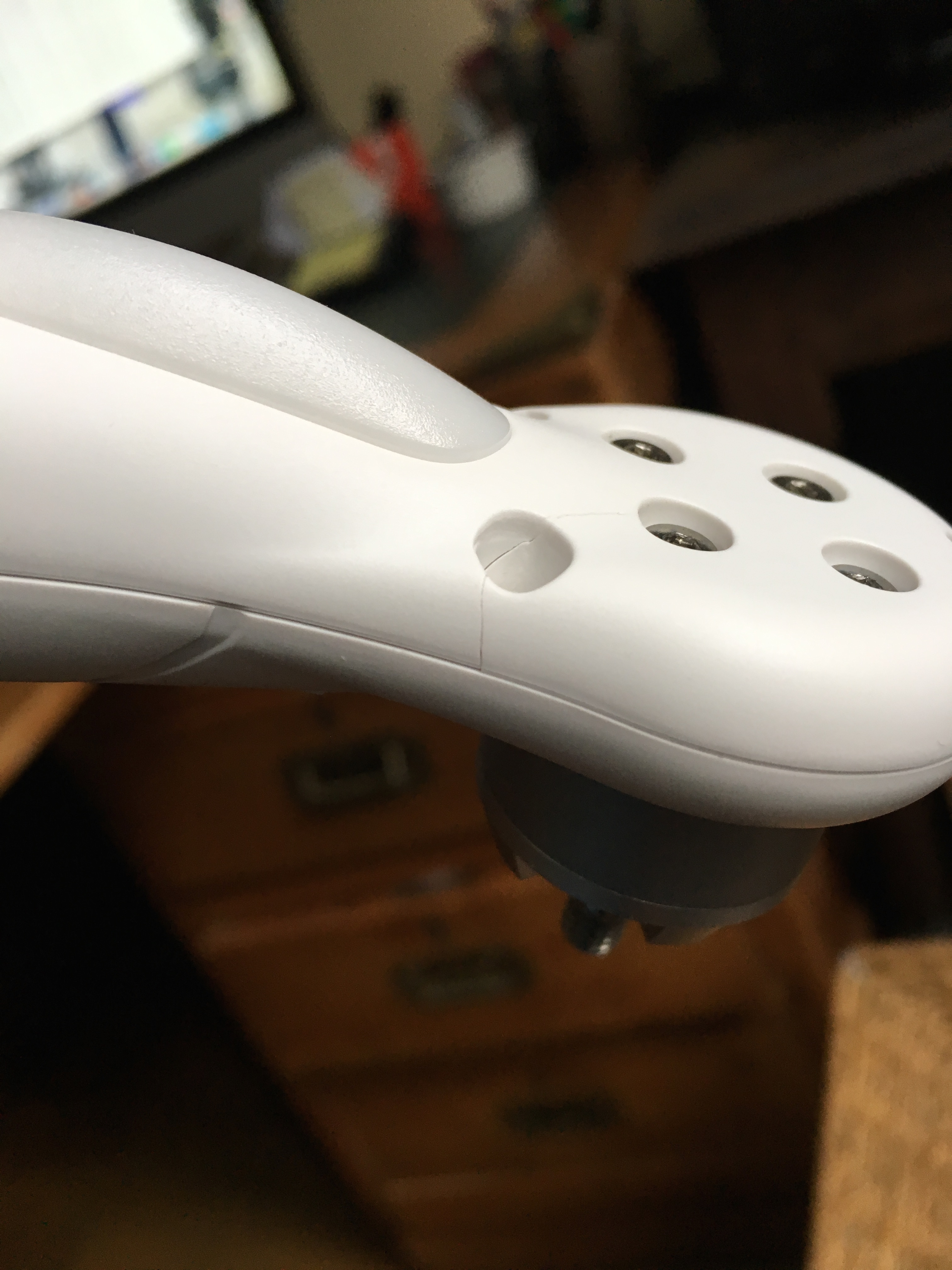

Not a big surprise but always a bad news : my P3A is cracking too !!
And of course out of garantie.
To be fair with DJI, it's just after loading it with a 365 g auxiliary battery not well balanced. Cant push the limits and cry when you reach them ...

Thanks guys
And what about Superglue (cyanoacrylate ) or epoxy ?

I used the 2nd gen shell and PLASTIC epoxy on the bottom shell on all 4 arms where the motors attach. I filled them all the way until it was even with the 4 post that the motor sits on. Make sure to fill them as equal as you can for balance but if not perfect its not a huge deal, just try. I have flown mine about 15 times with no problems. It flies straight and worry free. Some people have there methods and glues to use but for me and 2 of my friend that also got cracks this method worked great for us. Mine got cracks on the 3rd flight of my p3p and I was really pissed off. This is something that they need to address, but they wont. All they want to do is sell you the same original shell and have it crack again. The site that I provided you with is the 2nd gen shell and to date I haven't had any problems with the way I modified my bird (for the better) Make sure when you tighten the screws up to only tighten light not over do it like they did from the factory.

I am curious if people that are posting these cracks are doing "maintenance" tightening of the motor mount screws?

Any pictures ? And what difference you do between Plastic epoxy and epoxy ?

I don't think either will adhere to the plastic very well, if at all. Cyano isn't designed to be used under stress. Any twisting will make the joint fracture again.
Haven't had problems and its better than most methods ive seen on this forum or anywhere. I agree under stress (flex) it might not work if you only put a small amount that's why I filled it all the way to the motor post so the glue will be attached to a lot of the structure (plastic) in the arm.
Not sure if your question is for me and if I understand it. Do you mean , releasing some stress off the body shell, unscrewing a little the mounts ?
If yes, the answer for me is No ! When all is working well, you (i) don't want to touch anything. I presume, there is some thread locker on each screw. So you have to unscrew 16 screws, clean the screws, re thread lock them, and put them back. With no information about which torque to apply ...

I'm not telling anyone to loosen 16 screws on their bird. I'm only saying if you are replacing your shell due to stress cracks to not go crazy and tighten up the screws like they did from the factory, which is the main reason for people having stress cracks. If you do replace your shell use the 2nd gen frame with a little better support, that's all I'm saying.

When my new P3P arrived in April the first thing I did (owing to having been reading here) was to slacken off the motor-mount screws very slightly, fit some prop guard mountings (although I don't ever use them) AND put a few winds of 5mm (cut to width myself) duct-tape around the extremities of the four arms.
So far, after quite a few flights, no problems at all (touch wood)... :)
