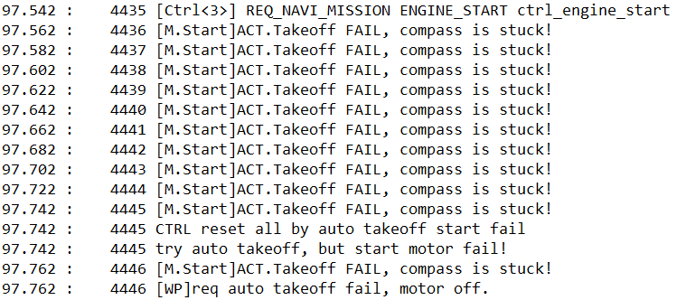

This appears to be why:
Wow! What a surprise. This AC flew fine yesterday. Then I went over to the new location, expecting everything to be OK and I had the no=start problem. I simply turned everything off, and then everything worked perfectly. Two perfect mission flights and some manual flying - all OK. That was a flight to give me more confidence on the new AC Maxwell. Instead it has caused more concern. Any more comments/data would sure help.
Joe
KC7GHT

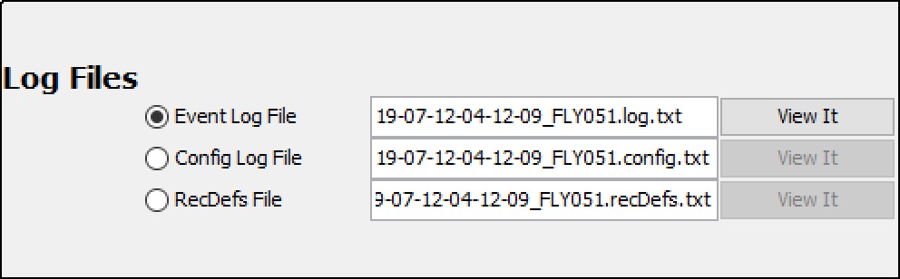

Fly Dawg, I am trying to follow you. Where/how did you find this data. I converted the DAT file to .csv and looked at the csv file with Excel, but I did not see this info. Maybe a another hint/ Thanks.
You need to look in the event stream. If you converted it with DatCon then choose the Event Log File option, which creates a txt file containing the event stream.

Now that we know that "The compass is stuck" and the motors won't start, and it all cleared when I rebooted everything, is there anything else we can gather from this episode? Will the motors start next time and the mission get underway and then have the compass fail mid-air probably causing a crash? The aircraft is bran new (two years ago) with only 15 miles of fight time. This is now my main aircraft. Everything seems to work OK with the two successful missions right after the stuck compass.
Thanks sar104.
I've not seen that stuck compass message before, so I don't know what might cause it. The magnetometer data in the DAT file might give a clue - did you check those?
