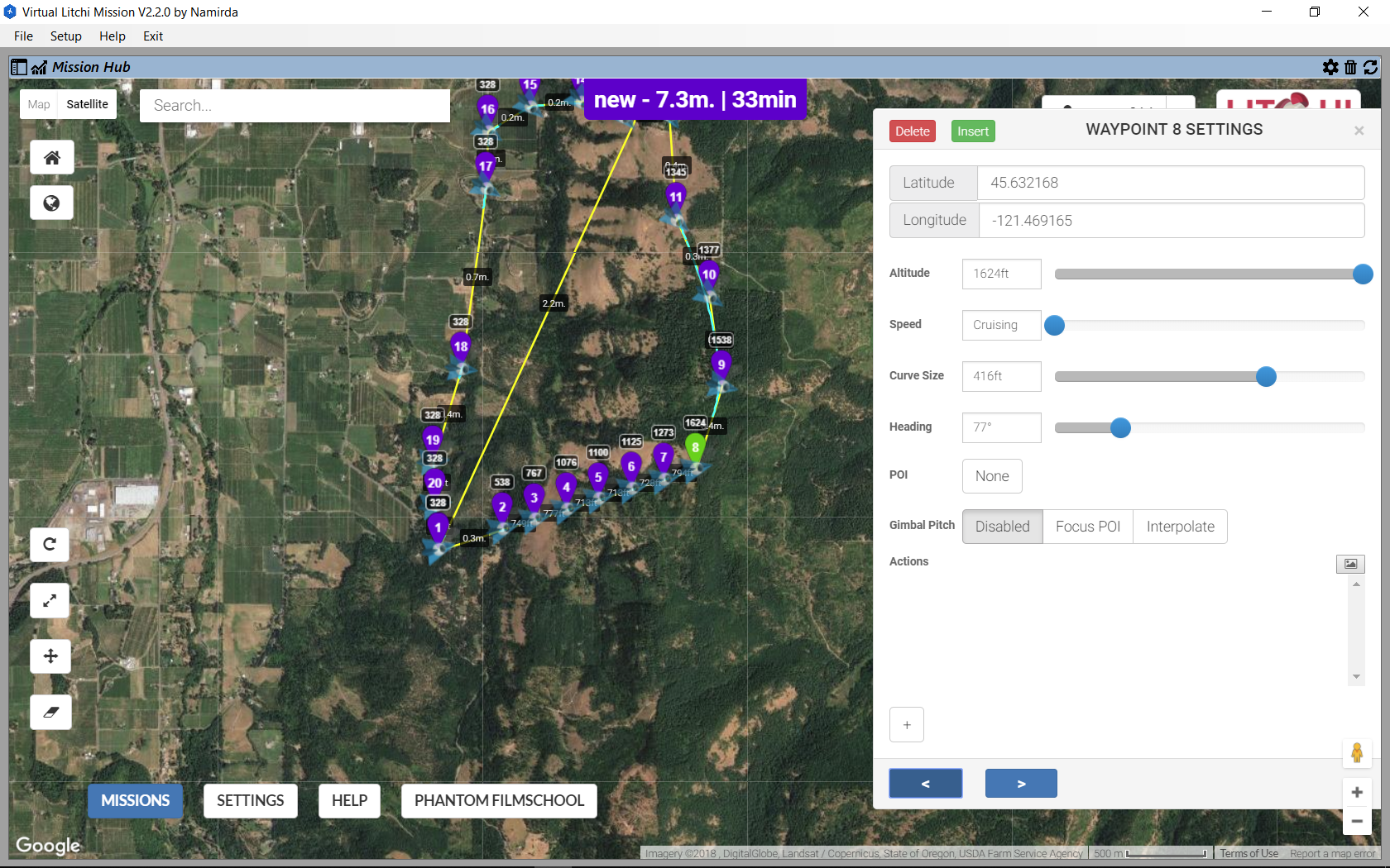

I have been tweaking a Litchi waypoint mission , which I am going to play and record for the four seasons. Just lately My Phantom 3 adv won’t even take off in many places. Where I have had no problem before. On the Waypoint mission, it loads then says “error cont -1008”. Or in normal flight load, when Zi try to take off, it simply won’t. Anyone got any ideas how to get around this ?

What firmware are you on? There was an SDK issue in earlier firmwares where this error would be reported by the SDK in some insatances. Power cycling your P3 might fix it- assuming you don’t have a genuine communication error.
What altitude limit do you have set on the aircraft? Looking at it, your altitudes for your waypoints are varying from 98 feet to 1624 feet. That will cause an error for sure
How did you select the flying altitudes?
+Your flight plan is 7 miles in 33 minutes. That's awfully optimistic on your battery's flight time.
+Your last waypoint is 2.2 miles away from your takeoff point. Do you have RTH selected in your settings?

You might want to take a look at this
Altitude Modes
By default waypoint altitudes are relative to the take off point (which is also generally the home point).
If you enable the "Above Ground" option in the waypoint settings, the altitude you enter will be relative to the ground below the waypoint.
When "Above Ground" is enabled for a waypoint, the waypoint's icon will show 2 altitudes, the altitude above ground (yellow) and the calculated altitude (white) relative to the take off point which will be the altitude sent to the drone.
Important To calculate these altitudes, it is assumed the first waypoint is in the same location as the take off.
I flew this mission a few times, you must have added a waypoint by accident. It is a 12min 5 mile mission.
