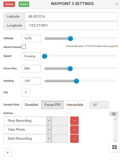

I am new to droning as well as using the Litchi app. I purchased a Phantom 4 Pro and had been getting used to flying it with the Go 4 app when I found the Litchi app and purchased it. I have created several practice missions and they do not work as planned and am wondering whether I am doing something wrong or whether the program simply does not work well. I created a mission to simply fly around my house using straight lines and numerous waypoints. I used my house as a point of interest. I started video recording at waypoint one and at waypoint two, I stopped recording, took a picture, and started recording again - supposedly. What happened at that point was that the recording stopped, no picture was taken and video recording never started up again. I modified my mission to simply start recording at waypoint one and take no pictures until the end. At the last waypoint, I stopped recording, took a picture and started recording again. This time, the recording stopped but the mission was interrupted. It simply stopped and hovered. Another problem I am seeing is that the heading is not staying focused on the point of interest very well. It points in the general direction, but it certainly doesn't keep it in the center of the frame. Any ideas? Anyone having the same issues? The Litchi app looks pretty awesome, but it doesn't appear to work like it should.

Looking at the mission plan, it looks fine. However, what you might want to do is put a delay in your actions. For instance in Waypoint 3 below. Put a "Stay for xxx" seconds between the actions. IE ... "Stop Recording"----"Stay for 1 second"-----"Take Photo"----"Stay for 1 second"---- "Start Recording". This will give time for the Photo to be written to the SD card before the next action begins.
