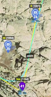

There is a bug in Litchi Hub that caused my Phantom 3 Pro to crash. I do not make this statement lightly. I have flown close to 200 Litchi missions without incident so I am not new to the software or the Hub. The bug is easy to reproduce.
Here are the steps:
1. Login to Litchi Hub and create a new mission
2. Add your first waypoint
3. Set your Altitude value (I used 164 feet)
4. Click on Above Ground and close the waypoint window
5. Add a second waypoint and close the waypoint window
After this step, you'll notice Litchi has already included the altitude information from the first waypoint and has checked the Above Ground checkbox. The second waypoint will include your above ground altitude in yellow and the actual altitude in parentheses. This is what should happen.
6. Click on Waypoint #1. This will open the waypoint window.
7. Click on Insert in the upper left and close the waypoint window
The inserted waypoint will now be labeled as Waypoint #2 but it will NOT have the altitude information set or the Above Ground checkbox checked. This is easy to miss because you expect the behavior to be consistent. I have included a screenshot from the fatal mission I ran yesterday. It has a total of 54 waypoints and 22 POIs. (only a few are in the picture) Unfortunately, the first one I missed caused my P3P to crash into a high ridgeline. I was concerned that I might run into a bug after the numerous changes made a few months ago.
This needs to be fixed.

Here is Litchi's response:
"Litchi Hello,
I am sorry to hear about your crash.
This behavior is actually intended and not a bug. Litchi will apply the settings of the last added waypoint to a newly inserted waypoint, but when inserting we chose not to apply these as in most cases it wouldn't make sense to apply the last added waypoint's settings to a waypoint that is potentially inserted in the middle of the mission."
My reply:
With all due respect, this decision makes NO sense. As you can see on the graphic, I'm decsending from 1164 feet at waypoint 41 to 814 feet at waypoint 43. Had waypoint 42 behaved like all the others, we would not be having this discussion.
I went back to the Mission Hub and dropped a POI at waypoint 42 (see attached graphic) and the height displayed is 1081 feet which is 92 feet higher than what is displayed on the waypoint. Why would you even think someone would want different settings when inserting a new waypoint? That, too, makes no sense. How can you say "Litchi will apply the settings of the last added waypoint to a newly inserted waypoint" when that is clearly wrong?
I posted this on phantompilots.com and a gentleman in England came up with the same result using altitudes of less than 25 meters. His comment was "So if I had not known of this problem I would have flown into the ground three quarters of the way up the hill." How can you say this isn't a problem?
I've been in the computer industry since the late 80s and I know that only the "show stopper" bugs are addressed prior to a new release. However, this requires a fix. Whoever made the decision to let this behavior stand needs to rethink the consequences. Your software isn't free and these drones are not cheap!

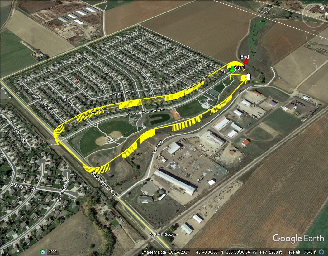

I have discovered another weird quirk when using the Litchi App (it may also occur in Mission Hub - I haven't confirmed it yet). I first created a 12 waypoint mission with a few POI's in the Litchi app, just to fly a perimeter around a small park nearby, and saved the mission.

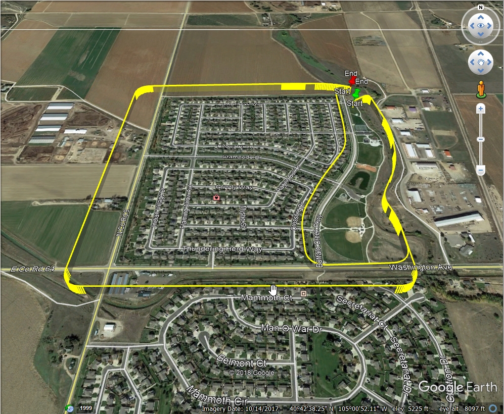

Next, I wanted to modify this saved mission by extending waypoints on three sides of the roughly rectangular perimeter flight path. To do this I load the saved mission, made my waypoint positional changes, checked my changes then saved the modified mission under a new name.
Then, through this forum, I learned about sync'ing missions between the Litchi App and Mission Hub, exporting a mission to a KML file and viewing in Google Earth! Great, wonderful. When I loaded the KML file into Google Earth I saw the new, expanded and modified perimeter of flight but it also showed the original, smaller perimeter of flight as well (and flight altitudes above ground were all precise and correct).
I exported the modified mission to CSV and opened it in Excel, only to find that the only waypoints listed were that of the expanded perimeter flight path. This must be a "feature" that someone has run across before.
Any ideas?
