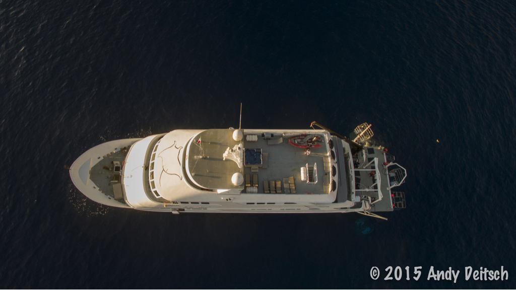

I took off from a metal boat a couple of weeks ago. Before doing that, I checked with some knowledgeable folks including a DJI insider on if I could do that and what I should do to prevent a fly away.
The recommendation was to not calibrate the P3 on the ship. I was told by the DJI insider that calibrating 150 miles away on land was sufficient.
When I started the P3, I held it above my head to put some distance between the metal deck and the P3. I then placed it on a wooden table where I launched it.
To make sure everything was ok, after launching I let it hover about 10 feet above the deck for a minute to make sure it was stable and then flew over the water.
I had two flights on two separate days with no problems. Here are a couple of shots from those flights.

View attachment 33368View attachment 33369
Hey Andy nice location. You could use the P3 to spot fish!
Was the boat mainly steel, fiberglass or aluminum? Or a combo?
GPS or Atti?
Cheers.

It was a steel hulled ship and I was using GPS.
Look closely at the stern of the ship and you'll see that there are shark cages being deployed into the water. So fish spotting for sure :)
