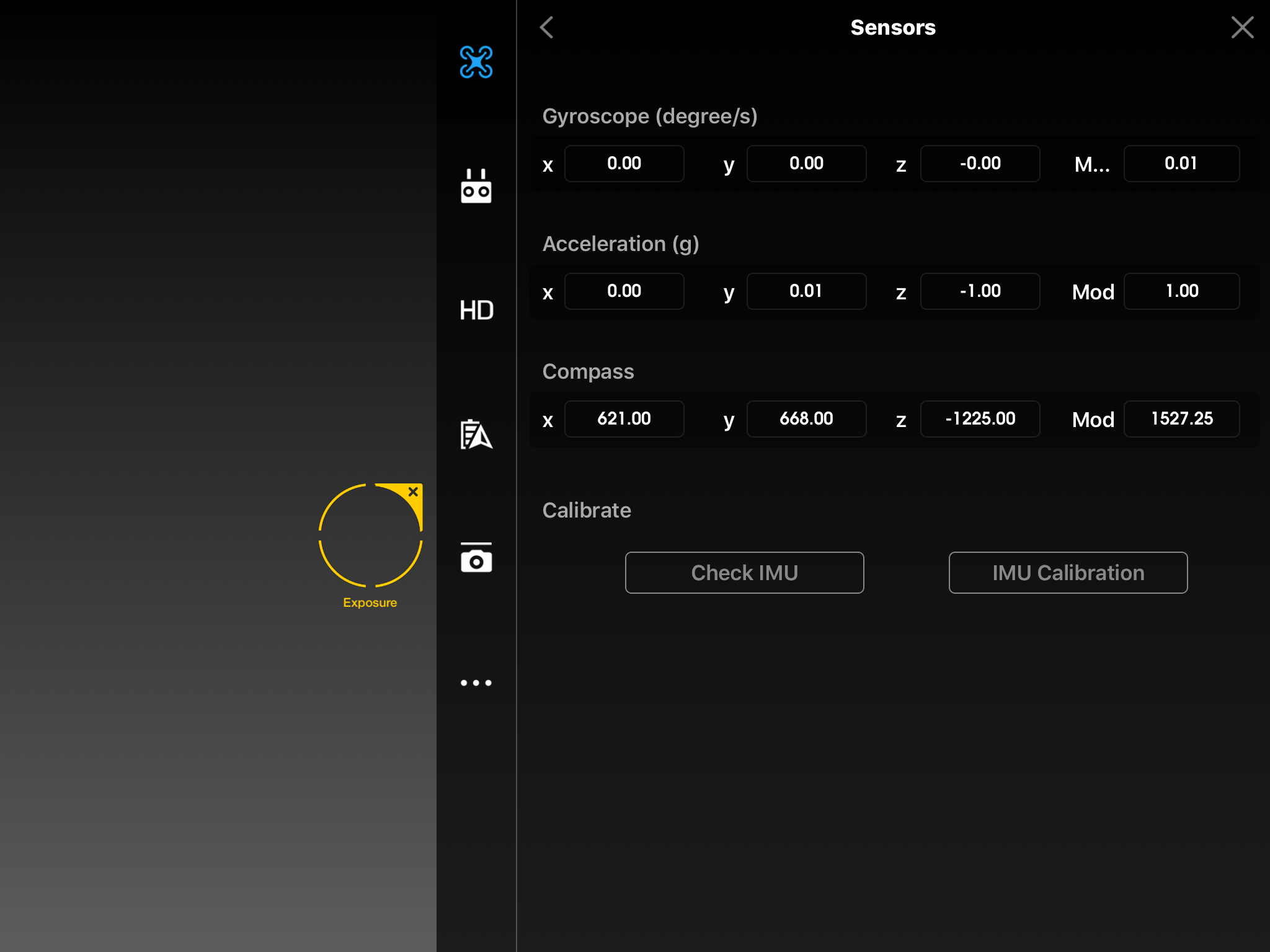

Installed new compass. These are my battery readings after many, many recalibrations in a proven safe spot. HELP!!!

Where do you need to go? What problem do you suspect you have?
That's what I need to know. The Z reading is way out of whack - the new compass didn't fix anything. What's next? I have tried degaussing (CFixer), waving a magnet as described in many posts here, installed new compass, and still no good. If there is anything I have missed, I would like to hear about it before spending $$$ on having it looked at by a repairer. The number of authorised repairers in Australia is very limited, and they can literally charge whatever they like. This is turning out to be a very expensive hobby - drowned my first P3P, now this.
Flown it - yep. Wanders around the sky like a lost sheep. I must admit to being a bit hesitant to give it a full workout. Is the Z value acceptable as long as the MOD value is within range? Mightr be a silly question, but bear with me - I am 67, and this is all new to me.
Reactions: skymonkey

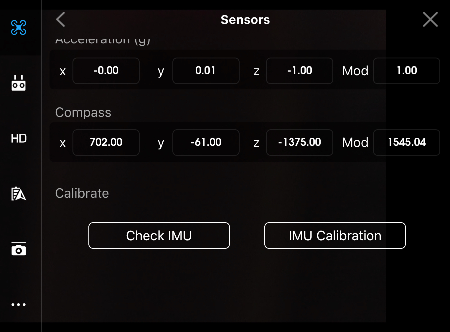

That mod value seems good- not sure about the z, I never paid much attention to it. I just dragged the old phantom out to check.
Looks like this.
I live just out of Canberra, in Bywong. Definitely not in ATTI mode. Too chicken to even try that.
Those figures give me some hope. I am going to go out tomorrow to a really open, tree free field, and give it another fly. Cross your fingers for me......
Still a mystery, she should be pretty stable in GPS mode.... Make sure you give yourself a bit of height, really close to the ground can actually be less stable.
