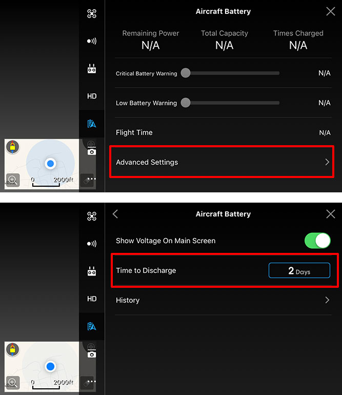

Oh ok. Isn't the default 10 days before it does this? Is it safe to store the battery at 100% juice for the 10 days until it automatically discharges?
Yes. If you want them to discharge faster, you can decrease that time in the following section of DJI GO:
That setting is stored on the battery, so you'll need to insert each battery in your Phantom one-by-one and change the setting.
