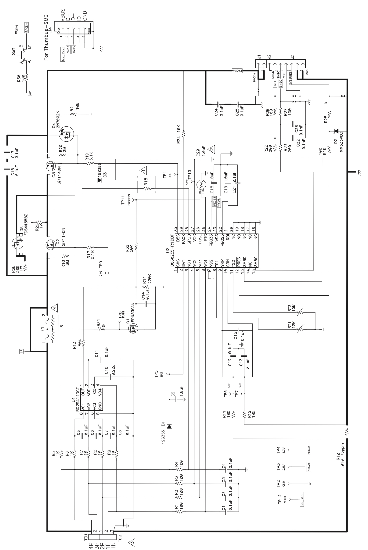

The DJI circuitry fails miserably to balance cells in what respect?
Below is the schematic for the DJI phantom 3 battery. It employs TI MSP430 MCU and a seperate IC to implement cell management and protection.
The resistors that provide for, what you call simple resistive discharge, are depicted bottom centre (R1 to R4). They are 100ohm and switched in as needed on individual cells to perform balance/discharge. At nominal cell voltage we are looking at 160mw/cell dissipation (600mw for the pack). By way of comparison something like an IMAX B6 might provide 5w total discharge capacity (presumably a similar load is available in balancing) however the B6 will handle higher capacity packs and can charge at greater than 1C rates also. It is likely that 160nw/cell is adequate in the current implementation for the DJI Phantom packs.
It would seem that the DJI implemwnted Texas Instruments battery management solution provides for significantly more than ineffective balancing and telemetry. None of my packs have ever come off the charger out of balance.
