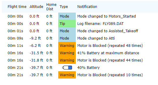

Looking at the flight info in Air Data, I found this... looks like a motor problem. Is there any way to tell which motor?

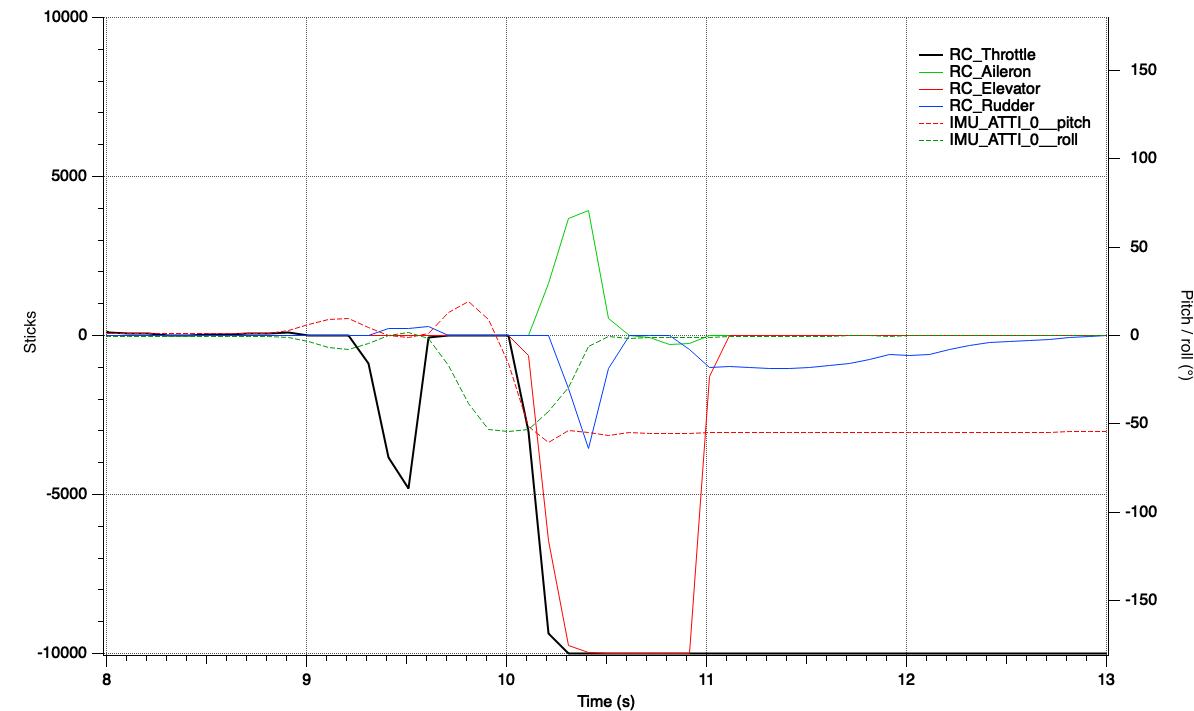

The motor obstruction is after it tips over. This is a common problem - you cannot take off like that. It requires full throttle to lift the aircraft off the ground. Anything less - and you gradually applied half throttle, and this is an almost inevitable result:

No really - always apply full throttle then release once airborne. That always works.

Catch 22 then. That tentative takeoff technique almost guarantees that it will tip over.
