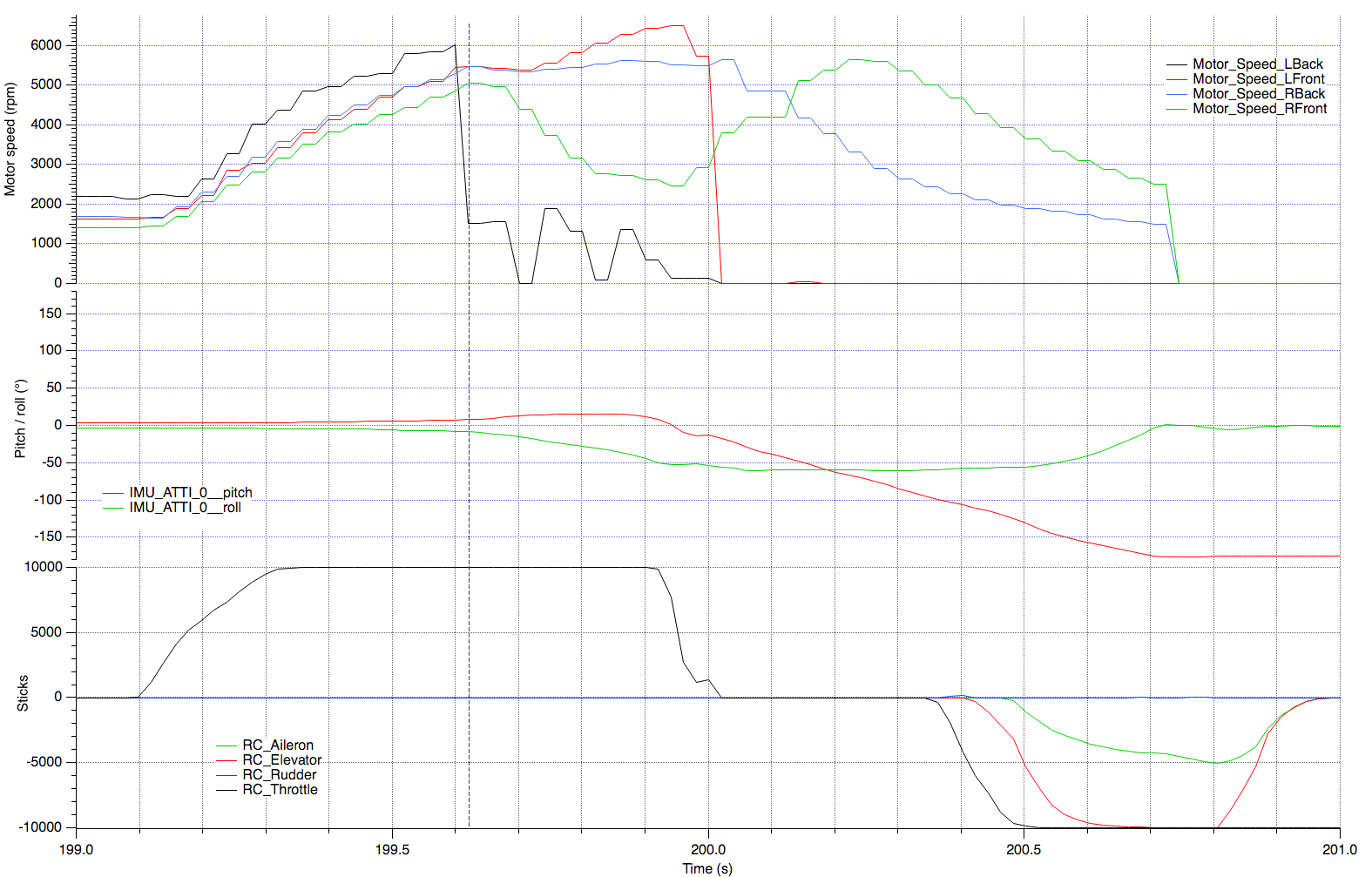

Latest DAT file:
FLY093.DAT

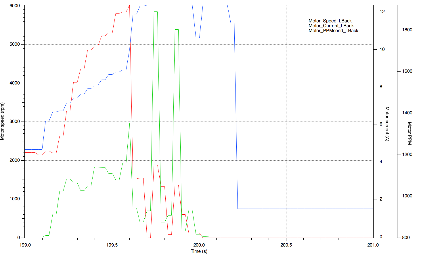

OK - looks like my guess was completely wrong. That shows a proper take off attempt that failed:
You seem to have a bad left back motor or ESC:

Is there any way to tel if it's a bad motor or the ESC? With my luck, whichever I replace first will be the wrong one. Schrodinger's cat and all.
View attachment 109518You seem to have a bad left back motor or ESC:

A new CCW motor will be arriving today. Fingers crossed. What are you using to view that data? That's a lot more information than I was seeing in the other app.

ESC of one of the engines could be the problem too, my p2 was flipping over frequently, sometime it was ok, sometime it flipped in the air making complete roll, if there was enough height it would continue to fly, if it was too low then it crashed, after one serious crash it begin to flip constanty, could not take off at all, since I had no flight data (p2) by my ear I figured that speed of one motor is not the same as the others, bought "new" esc and motor and thats it, its quite ok now.
