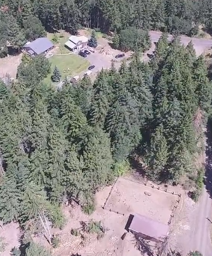

So here is what is kind of funny.
From this video,
In the pic is a horse barn, it has two back hoe tires full of dirt.
On the fence post nearest the tires is a IP camera, the upper part of the picture is were we were flying from. Seeing my house and my garage.
The next picture shows the front of my garage with an antenna that is pointing toward the IP camera, So you might say I am blasting the WiFi signal through the trees.
This is a 24" antenna. I am sure @Ojcze Nasz probably knows what the gain is on this antenna with out looking it up. Yes it is running Vertical and not Horizontal.
This Antenna is hooked to a standard home router with 213 cable? Anyways it has the annoying N-Connector we used to use with C-Band satellites, with an adapter.
So on another note, I also have another Wireless router (I think a linksys, blue with two antennas) just above the Z on a rafter just inside, non insulated garage. So I have WiFi around the garage area.
I do have all four routers using different channels.
And I usually fly and land where a landed in the video.
From this video,
