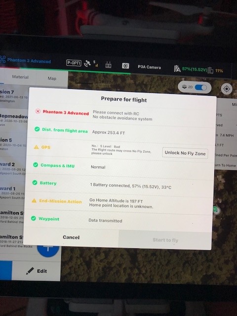

Switch back to DJI GS Pro app and I see the blue text and Phantom 3 at the upper left corner and Connected to "Bird" at bottom. I can see the camera view in the DJI GS Pro screen as with the DJI GO app. Selected my mission and then Fly. "Prepare for flight" dialog comes up and all items come up green as mission is uploaded to the drone. However the top most line for Connection says "Phantom 3 Please connect with RC". Uh? And the usual "No obstacle Avoidance system. (Using F Mode)

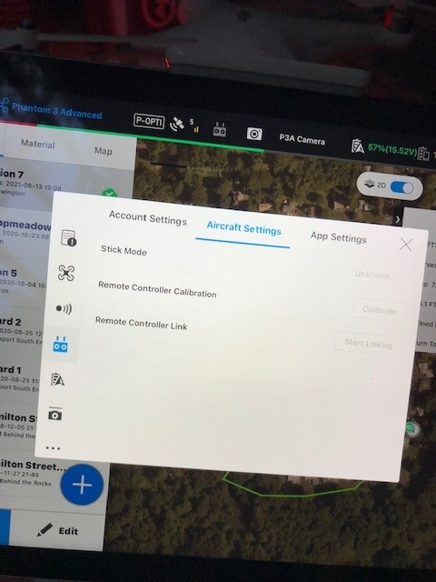

Just for fun I relinked the AC to the RC and same issue. I was asked to do a Remote Controller Calibration. Anyway I can be linked and fly manually with DJI GO. It's just the DJI GS Pro that will not link. See screenshots.
Then I deleted the app and reinstalled it.
Anyway this is what I am seeing before i can launch a mission. Joy, joy, joy.
Tried to do the Remote Controller Link through the DJI GC Pro. Note these are grayed out.

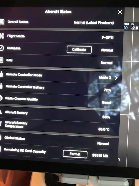

DJI GO has no issues to report.
