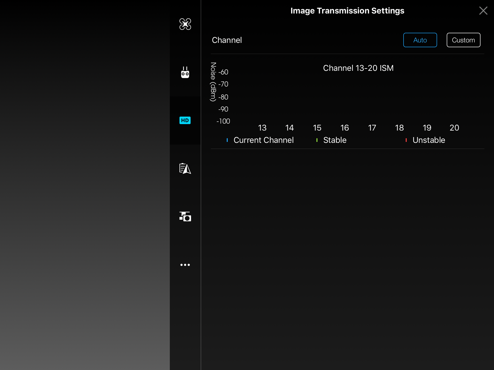

"With The Birds"; This is hos mine looks, bukt not Heen the drone is om, Thien i don't have any option of which channel I can choose! Kind of strange, asking me.. But I'm on Android, are you using Apple?
I'm very new to drones so I'm sorry I sound totally green at times!
And sorry about the double screenshot!
I really appreciate you helping me, really nice of you sir!! :)
Ok. Just looked are your image. You are on manual setting and Chanel 13...
For me 13 and 14 seem to be the most noisy. Looks like good chance you have found your problem.
Your screen should look like this (aircraft connected).
