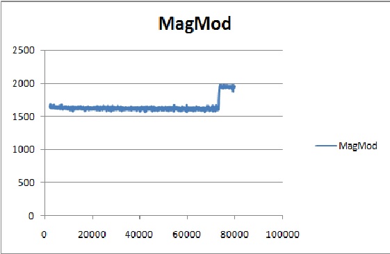

The preflight lasted roughly 133 seconds. During that time a compass calibration was done. This plot shows the MagMOD data during the preflight.
I'll speculate that the increase in MagMod happened when the calibration was finished. I.e., this calibration actually resulted in the magnetometer being further out of calibration. I don't think this was the cause of the crash though.
BTW, I've noticed that MagMod data usually shows a higher value than what is seen while the P3 is on the ground before launch.
That looks very much like a bad calibration. Resulting value was way out of range. This is a good example of not being able to depend on the P3 to tell you when the compass is not calibrated properly.
