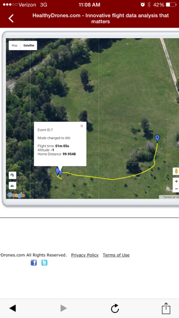

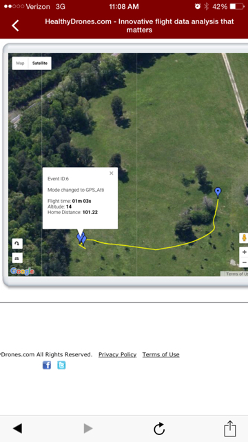

Bud what about the below screenshots of the flight map that show the descent. It seems like it something had power all the way down.

. Also Bud can you post the two .csv files somewhere not file sharing site? I cannot access dropbox or other file sharing sites....really want to see though!

Bud what about the below screenshots of the flight map that show the descent. It seems like it something had power all the way down.View attachment 35681View attachment 35682. Also Bud can you post the two .csv files somewhere not file sharing site? I cannot access dropbox or other file sharing sites....really want to see though!
I saw that. I suppose it's possible that the file got truncated either on the upload or when I retrieved it. I'll have to check later. I'll also post those .csv for you. If you had the .DAT you generate them yourself

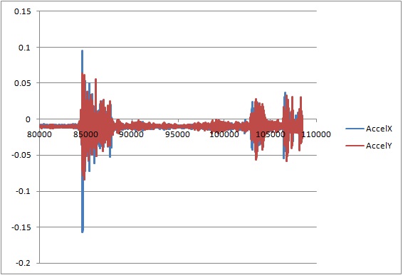

I looked at the .DAT some this morning. @McVenturesRC had uploaded it to the flylog.info site and I retrieved it from there. I used a new tool, called DatConverter, that I had made available on the website yesterday. It's an offline version of the website converter. The .DAT has more data than can be plotted by Excel. I used DatConverter to produce 2 .csv files; one for the preflight where a compass calibration was done, and another for the flight itself. This post addresses the flight. The preflight was actually kinda interesting; I'll address that in another post.

I've included some plots that I made with Excel. First are the X and Y accelerometer data
The horizontal axis is labelled with the clock tick#. The clock runs at 600 HZ so this plot, starting at tick# 80000, coincides with 133 seconds. The event at 81000 is the take off and the events at around 105000 are the maneuvers at the end of the flight.

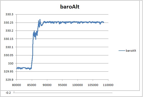

The barometer is shown here
Note, that the recording terminates with the P3 still at altitude indicating a loss of power in flight.

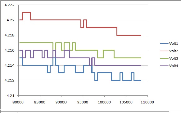

The battery data is shown here
Here are the two .csvs. I checked and there doesn't seem to be a problem with files getting truncated either on the upload or when I retrieved it. Of course it could be a intermittent problem. Let's think about this some.....
