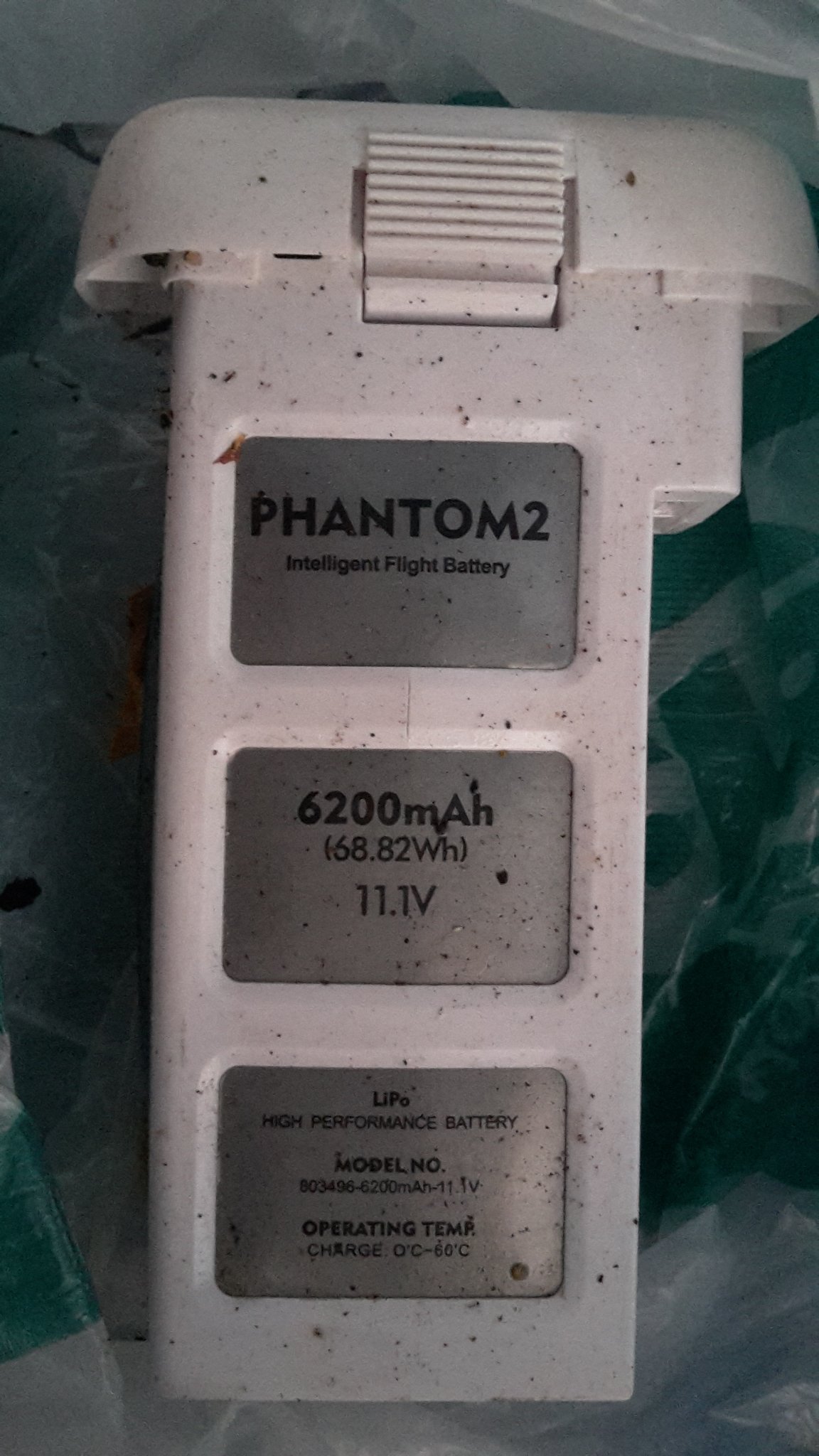

hi Guys, look what happened to my battery.....
However it still showes the correct voltage and was still flying kind of ok only that I had compass issues and the drone was drifting away but this must have something to do witht he GPS not the batterie, or?
But crazy how it poped open, now it doens't fit in the drone anymore ggrrrrrr
Wow , probly good it don't fit know more,unfortunately, not seen one swell that much without bursting,not sure much with p2 but mayby heat played a part in compass issue,,,???...yes I would put that battery outside so don't catch fire,,,this time your going to have to buy another unless it under warranty,,sorry,,how long was the flight,long,short,that batt been working hard doing something

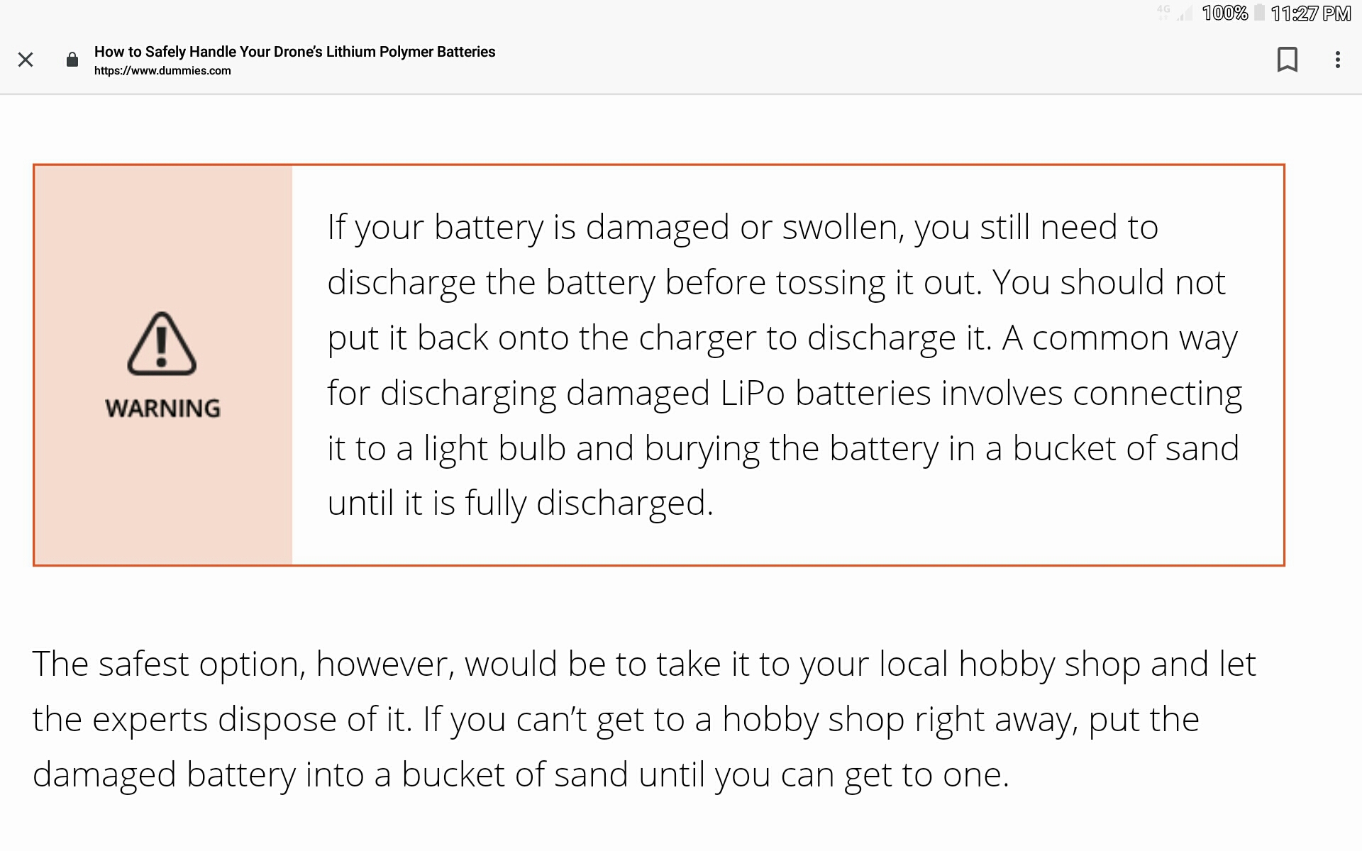

take that battery outside and put on a brick or similar ... take a car headlight bulb and connect to the battery (no need for fancy connectors ... solid strand copper cable pushed into the main battery ports is fine ... switch on battery and leave it to discharge through the lamp. Note : When lamp extinguishes - it is NOT finished ... its just not enough to make filament glow.
Leave that for at least half a day or more. The battery board inside will switch off at lowest limit unfortunately so please take care - that battery will still have life in it.
Some will tell you to dump into a bowl of salt-water .......... that is so slow as to be virtually useless. BUT in the case of the battery board switching off the contacts ... heavily salted water may be only way to get that last bit of energy out ... but it will take a long time ...
Me ? I would open her up carefully and connect bulb direct the battery cells themselves bypassing the board.
Final act is to dispose of via proper battery site ... not in household trash.
Please do not be tempted to put in the Supermarket battery collection points - unless its a remote one out in the car park ! ... they are not designed for high energy LiPo's disposal.

Don't panic, it's not "Nitro Glycerine" but it *is* a real danger. Until you are ready to dispose of it tape over the contacts and store it outside in a metal container with the lid NOT locked down just placed on. Either take it to an approved battery/hazmat disposal facility if you have that sort of thing there or failing that there are "salt bath" tutorials on YouTube on how to discharge such a battery. It's unlikely to catch fire under water.

ok, I throw away the old swollen battery
Which battery should I get?
I noticed that the old one hat 6200mAh
but I find now online only 4500 mAh and 5600 mAh
strange, I can't find any with 6200 mAh
does it make a difference (except the duration of the flight) to the copter?
A easier way to dispose a lipo battery is to fill a bucket up with water and add salt to it.
The salt will activate the ions in the battery and it will drain to 0%
Reactions: Graeme64
Are you sure the old one was 6200mAh? That's a big battery by Phantom standards and I personally haven't seen one that big. The larger of the two Phantom 4 offerings is only 5870mAh. In any event, I don't own that model Phantom so you might be right.
The answer is of course, yes go for the largest one you can find as long as you can afford it. I have a preference for genuine OEM batteries but I have been told that some aftermarket ones are worth while, I guess it's just a matter of doing the research to find out which ones are not going to be a rip off. There's bound to be some people here who can answer that better than I can.
You are correct, the only appreciable difference is going to be flight duration.
Regards
Ari
Right you are then :) As I said, never owned a P2.
The original answer still holds, bigger is better. Bigger = more flight time.
Batteries are sealed so there is no access to the chemistry. Salt water provides enough conductivity to allow a slow current drain via the discharge and balance connections (if equipped).
