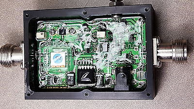

The 2400SAX. They are automatic gain so I won't be able to tune them, but I doubt it will matter much. Another plus is that they are 5volt. Since they are the outdoor model, you're supposed to inject the power on the RF line, but the seller had cracked one open and took pictures and it seems that the only difference between the outdoor and indoor models are the waterproof casing so there's a jack input, just have to drill out the casing to access it. Or at least that's the plan!
Is the concealed 5v jack input the large object in the lower right in this photo?

Ok, received the amps today. In a word, they are hefty. Six small screws are all that holds the bottom plate on so they are easy to get open. The case itself is quite thick and the board is covered in a waterproof coating that's probably about an eighth to quarter inch thick. There won't be an easy way to expose the jack in any sort of an aesthetic fashion, but you can probably use a dremel to slowly work your way around it. I'm going to opt for simply drilling a hole in the side of the casing and soldering a USB cord directly to the +5V terminal and a ground point. I should have the rest of the bits I need by early next week. More to follow...

I'm watching closely. Seller accepted my offer on the antennas, too. Added $5 in CA sales tax, though! However, I believe the magnetic mount we want for a mobile setup to attach in place of the DBS-02 antenna to the RC is this one, with the SMS plug: Black (Domed) Magnetic Mount - RP SMA Plug Connector - HMA3-RSPA10 My 5V battery uses the plug type jack like the Sunhans, which might be behind the casing. I have the 4A bird logo amps now, that weigh a ton, too! Hefty is the word! I have to use a tray under the RC to keep the weight of them mounted underneath from pulling the RC apart on a neck strap alone!
