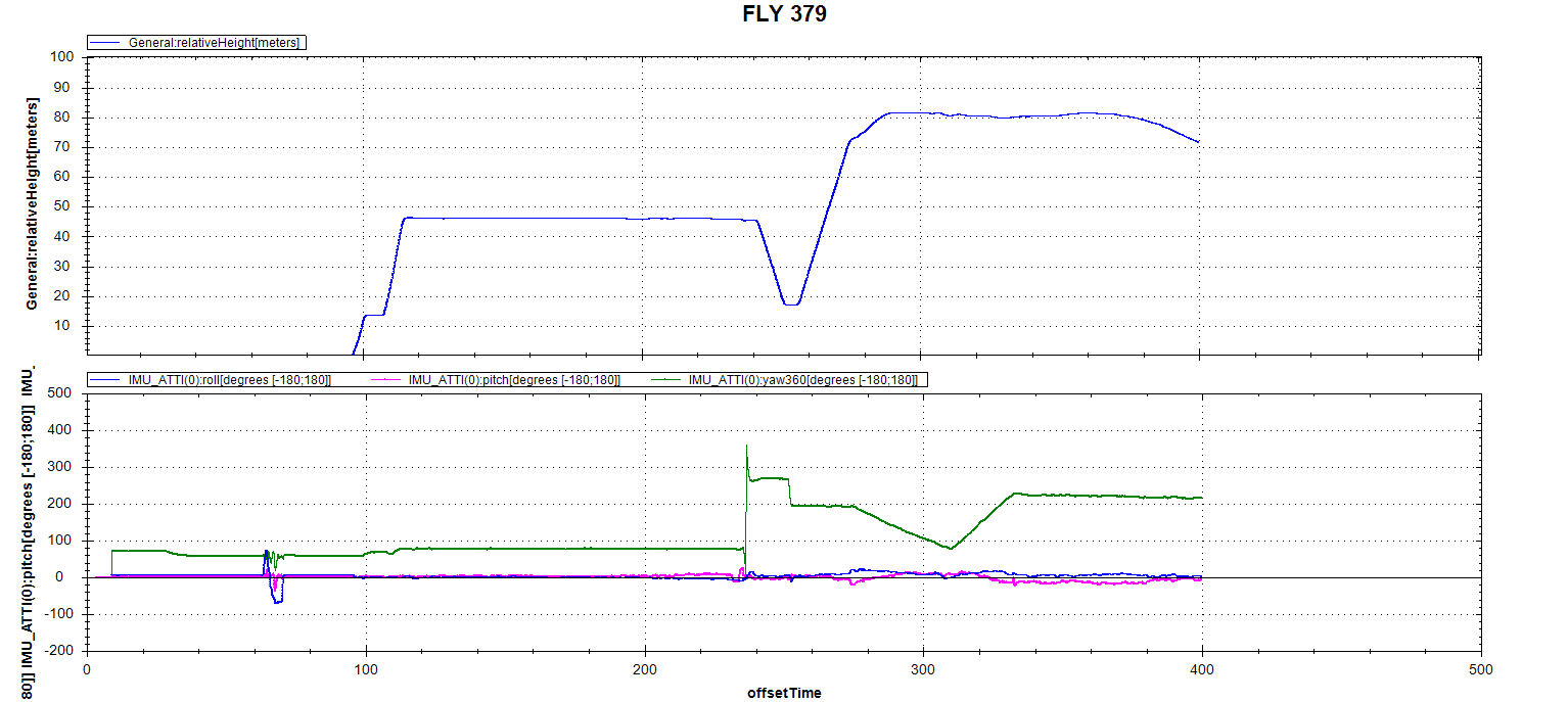

Agreed with @Meta4 as stated above. There is no data in FLY 379 that would indicate a collision or another issue that could have caused the incident. Fly 379 simply ends abruptly @ approx 70 meters in altitude. Fly 380 does not help at all. The aircraft is already on the ground. It doesn't make sense at all that the recorder simply stopped and restarted a new file while on the ground. Below simply shows the data end in FLY 379. The last point recorded is shown in the last image. Maybe @BudWalker can explain the recording end.
Don't have anything to add here. A CSC would be recorded in the .DAT
