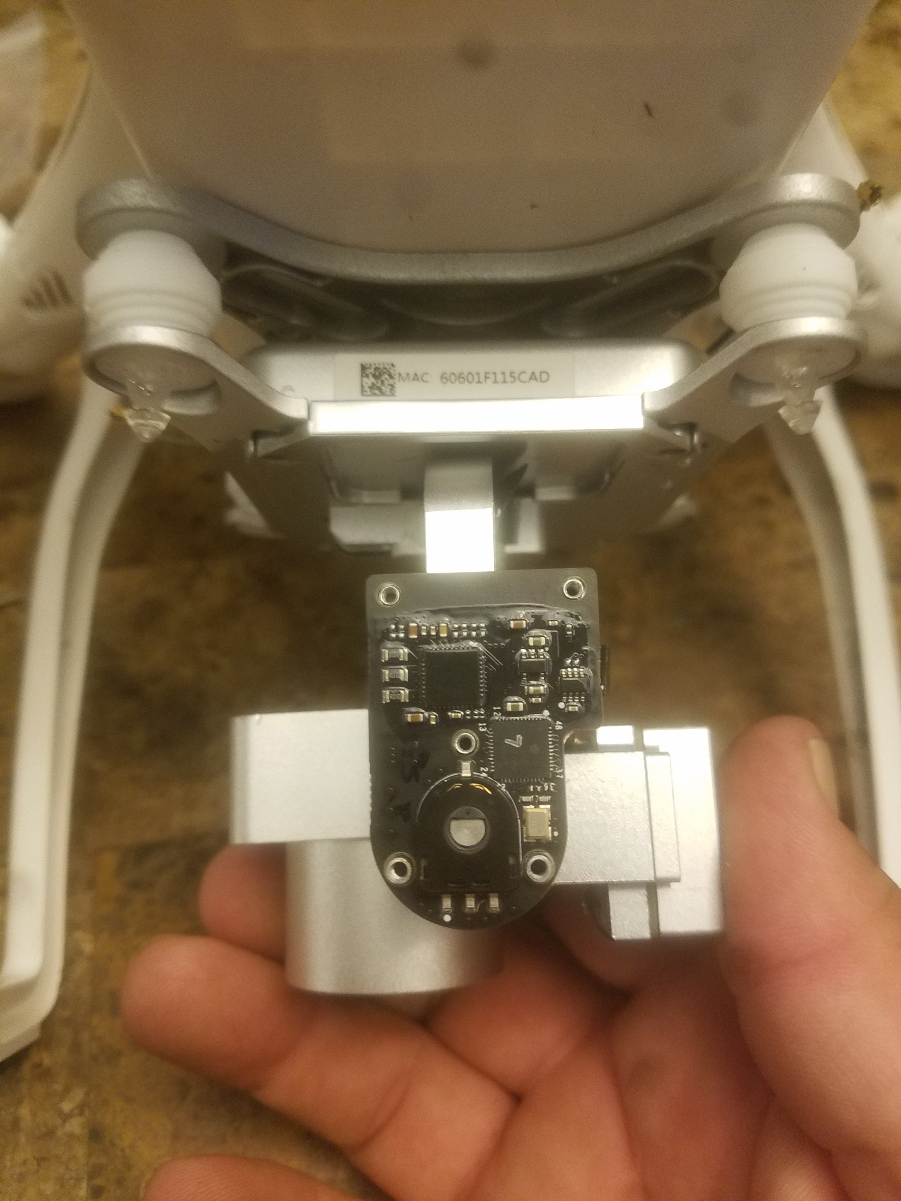

Pull cover off of the roll motor and make sure the flat part of the shaft is in align with the horizon
Pull cover off of the roll motor and make sure the flat part of the shaft is in align with the horizon of
the gimbal base.
More or less this is what you want
Look when I touched one of the arms in the video 1:15-1:18 do you think it could be the motor could be bad bc it doesent return or move when its dancing

I cant say yes or no that the motor is bad. Im kinda in the same boat as you! But after looking around
a lot of user's here have replaced their ribbon cable in very similar circumstances as yours
and had very good luck.
Maybe it is something you can try? I saw that you stated yours was intact. I don't know maybe its
a thought. Hopefully you find your fix, and if you do please let me know. If I get a answer before
you I will surely let you know.

Hey harpo I recently sent my p3s to dji fot the gimbal dance and they emailed me telling me it was the wifi main board on the gimbal so that's somthing to concider.hope this was helpfull

The first thing I notice is that the camera is pointing forward before it’s turned on. It should be pointing down prior to startup. Is it possible the camera was installed incorrectly?
