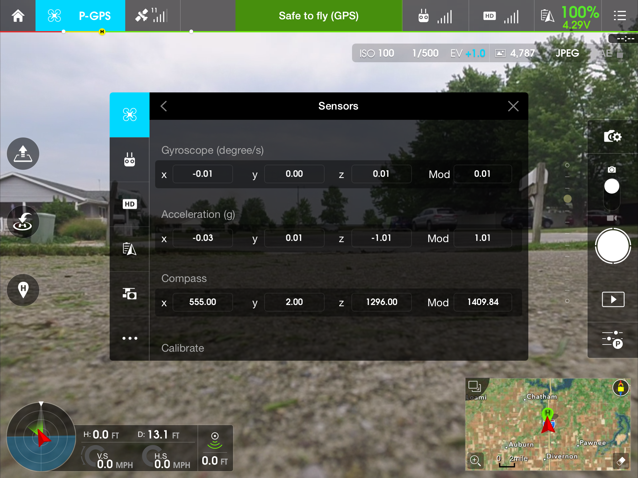

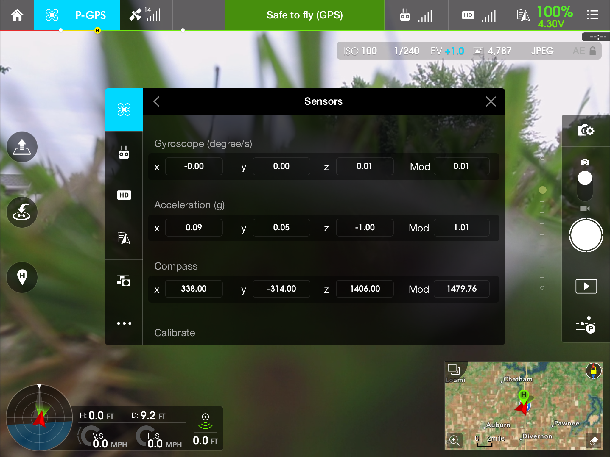

Ok, I agree should not take off from driveway if it has rebar. Mine does not have rebar but it does have a wire mesh. That said, I can take the compass mod reading in the grass and then at the drive and it is very little difference. I can take off and land from there fine as long as I don't land and then fly again without stopping motors.
Mod value on driveView attachment 29024
Mod value in grass
How far away is that from where you did your compass calibration? Most say they wont fly with a MOD value less that 1500. Mine wouldnt even let me spin up when I powered on from the driveway (MOD in the 400s) But Im on BETA FW.. I don't know if that's a new addition, or something from before. My powering up in the grass gives me a MOD in the 1600s
I did the compass field behind me. Usually when I look at the mod values they are around 1530's but when I tried it just now it was in the 1400's in both places. This morning it was 1536 on my drive before I took it out over the corn fields. But I did not calibrate today since I am in same location as I was when I calibrated last.

lol, if you look at my map image you can see that my drone is facing perfectly north in the driveway image but it looks like it is facing N by NE in the grass image. Darn it I am going to have to run out there again and recalibrate and check it out.
