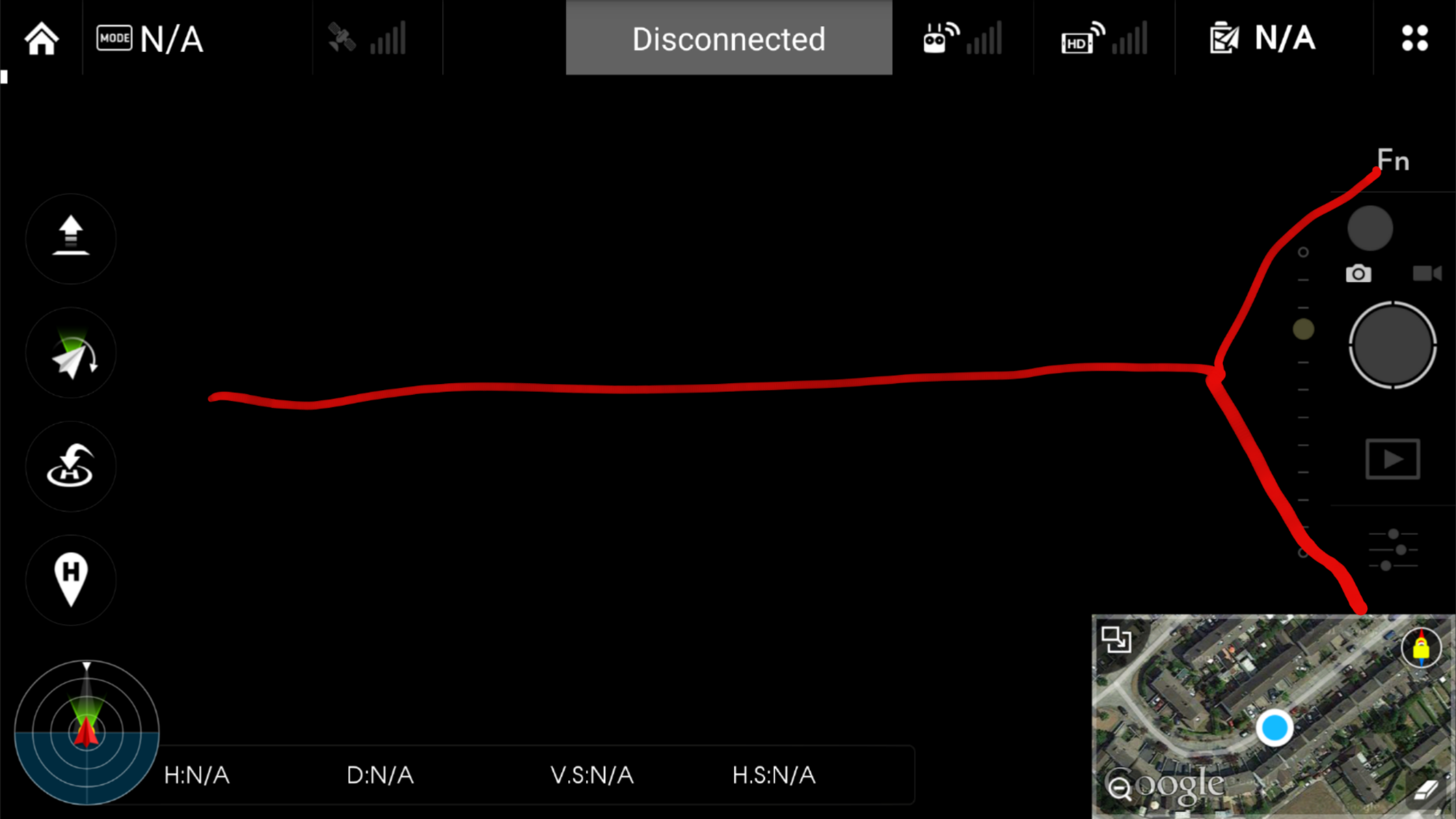

Did you try here?

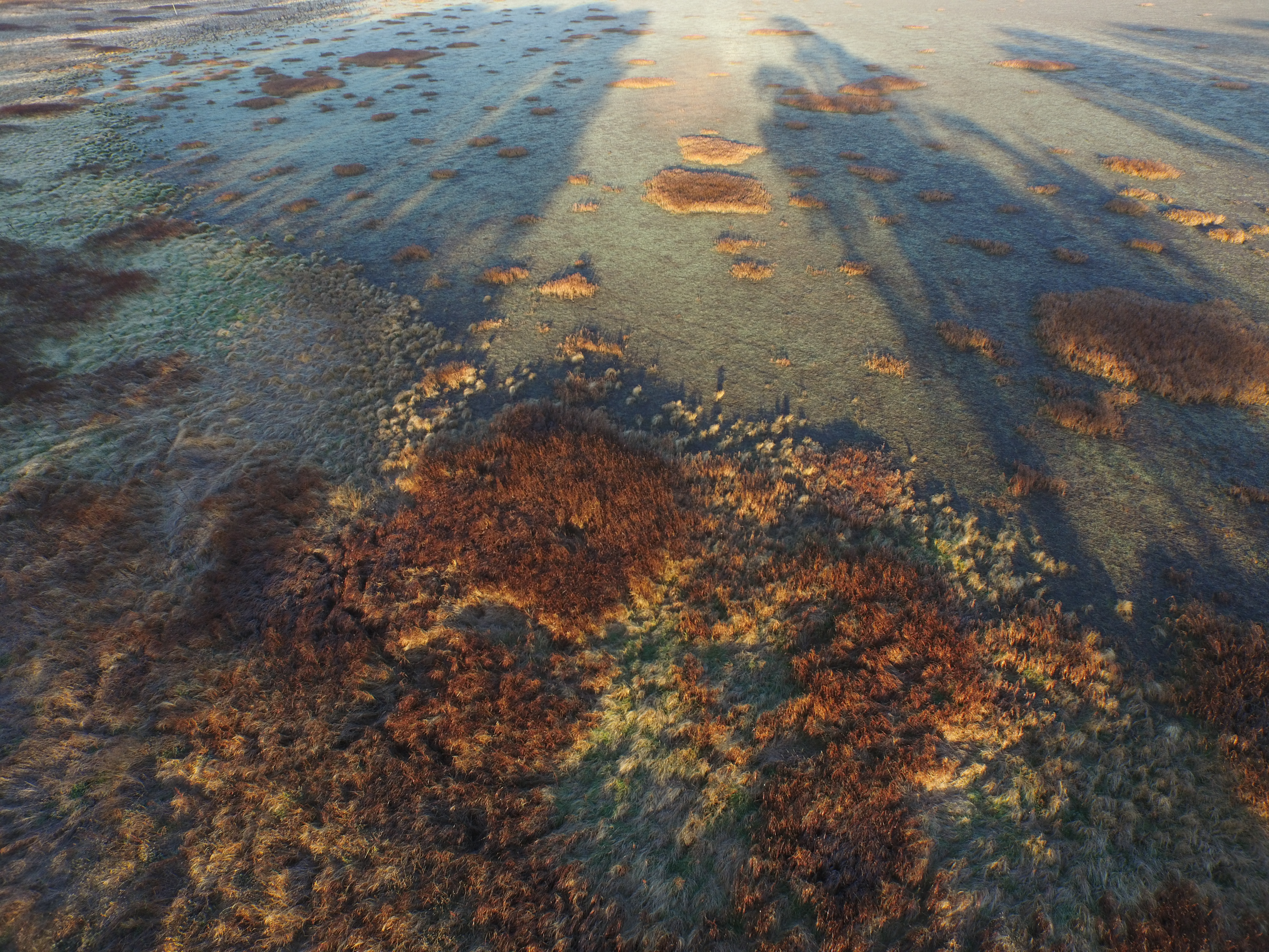

These are unedited........the 1st is from this mornings flight, the 2nd one I just took in the backyard, hand holding the body....it does seem better. Could the flight vibration being causing the softness?
I would try a test shot while it's on the ground and engines off. Preferably at something that has a lot of detail like a dollar bill. Make sure it is perpendicular to the lens. Then you can rule out vibration and motion. If it's not clear on the ground and stable then you might have a problem with your camera. If it clear you might have a vibration issue.

I'm looking at the pics on my tablet and I know they are just jpegs but they do seem a little soft but you have to remember that these cameras are made to take shots from a very long distance away, they just aren't made to get detail close up. You would have to judge them on pics that are taken further away. They are tiny cameras after all and they now really excel in video more that photos. If it's close up stunning aerial photos you need I'd be looking at an s900 that can carry a gh4
Those images mean nothing without explaining the settings you have the camera set at.
I doesn't take much to make ugly images, especially with improper settings.
