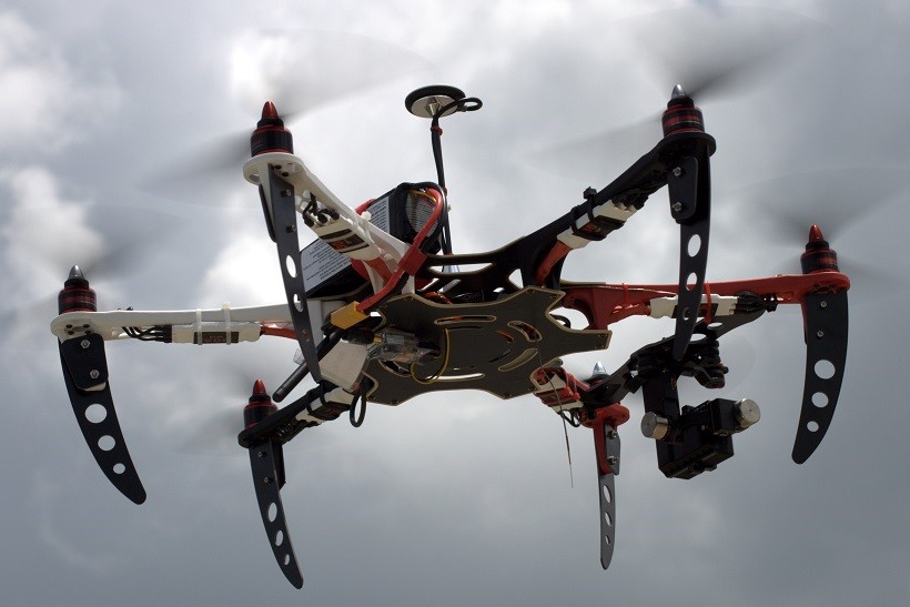

FangsCPO said:
Looks like a **** spider or a crab....not sure but looks cool. LOL!! Where does your battery sit?

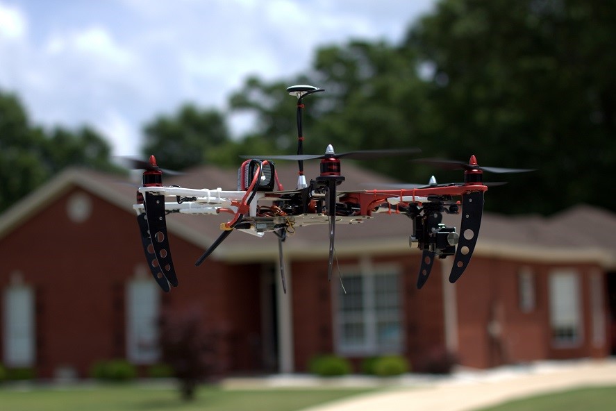

Couple action shots from today...
