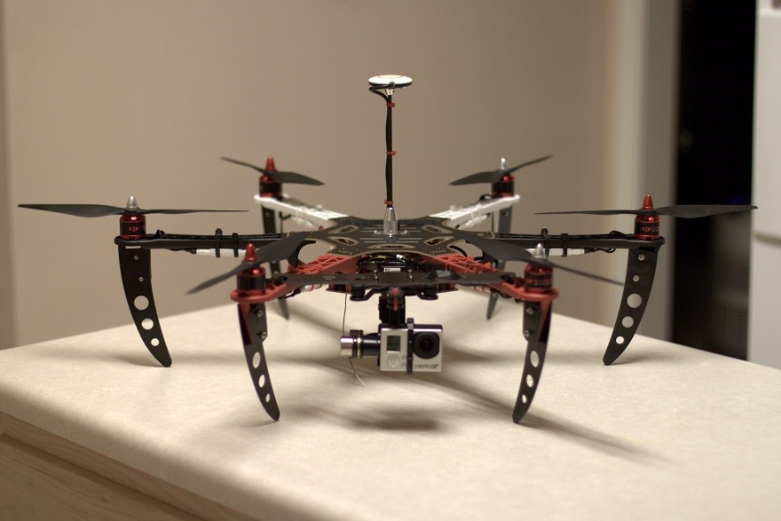

I've been flying mine bare bones for a month now and finally installed gimbal, iOSD Mini and IRC 600 TX today. I think I went a little too far forward with the gimbal in an effort to keep the props clear, so had to move the battery from the top plate to hanging off the back end to get the CG right. Moved the Z axis to -20 and it seems to be doing ok. Will probably bump up the gains a little next to compensate for the lower CG.

Love your modified 550 dude! Those aluminum arms are da bomb! Any idea what the total weight of your rig is with battery?

Nice 550. Are those e300 or ? What kind of flight times do you get? (I know ... you just configured it... but let us know when you get a test flight or two in).

@ U.M. - No idea on weight yet, still looking for a scale!
@ ladykate - Yep, that's the E300's that replaced the stock motors I burned up using the too-long screws. I wanted to thoroughly flight test it before hanging anything on it and was getting about 11:45 flight time naked (except for landing gear) with 3S 5,000's and landing with 22% battery. Anxious to see what the new flight times will be with the camera, gimbal, iOS and TX! Will report back soon..
