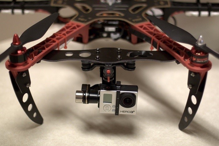

Is anyone else here using something like the batwing? My mate made me one out of some carbon fibre plate he had but I'm getting some serious jello and shake.
It's sitting about 3cm's behind the moters, below the arms and I'm using the black dampners. I'm going to try adding some foam between the batwing and arms and see how that goes.
I also tried using the white dampners, more or less the same.
I'm actually surprised with the batwing, didn't improve my field of view as much as I thought it would.

I'm happy with mine as far as overall weight savings, but like you I was less than impressed with the field of view the Bat Wing provided. Had it mounted as far out on the top of the arms as I could when first installed. Worked great except I was getting the props and the bottom inch or so of the left landing leg in frame with my shots so I moved the Bat Wing to the bottom of the arms hoping that extra 1/4-inch would negate some of the props I was seeing. It did help some, but it really needs to sit another inch lower. I'm looking at making a spacer to drop it down even further. As far as jello... I've had none in my videos and I've used only the black rubber isolators thus far. Have you balance your props?

Yea mines sitting below the arms at the moment. I did balance them back at home but I have traveled by plane a few times and it wasn't very "secure" in the case. I'll check their balance tonight, I like your idea of adding a few spacers to drop it down more. I'll probably do the same.
Hopefully it's not my moters, I don't have anything or any idea on how to balance those :/
There is a video in youtube on how to balance motors. In my opinion, that is too much work to do but it is possible. Good luck.
