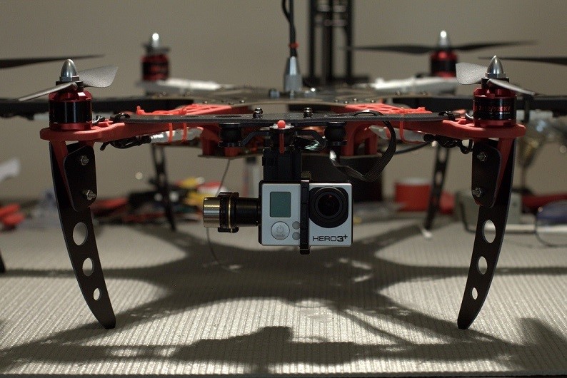

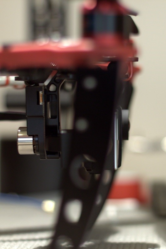

Hey U.M., any chance you can post a pic of the Iris Batwing installed? I looked at it on their website but can't figure out what it looks like mounted?
lgeist said:
On a high note I received and installed my Iris Aerial bat wing and landing legs today. Previous all-up-round weight of my 550 with the Neewer FPV skid was 2340 grams. After swapping it out for the new stuff I'm now down to 2160 grams! I think once I add the iOSD mini and my 400mW transmitter I'll still be under the 2400 gram limit. Sweeeet! :mrgreen: U.M.[/quote said:
I'm dying to see this also....it looks like you would have the props in view from their website photo but I could be wrong.
I'll post pics as soon as I get home guys.
I installed the Bat Wing as far out on the front arms as I could. I can tell you my GoPro does sit farther forward now than it did with the Neewer FPV skid by at least an inch and a half or more. I was playing with the balance/COG last night and I'm going to have to mount that monster 6400mAh battery as far rearward on the top plate will allow so I can to off set the GoPro/Gimbal weight. I haven't flown it yet because I was/am waiting for the last component of my FPV setup (iOSD mini) to arrive today so I can complete my upgrade.

Here are 4 quick pictures I just took of the Bat Wing on my 550.
Front view.
Top down view.
Side view. Note that the lens on the GoPro is almost flush with the ends of the arms. :shock: Can't get much further forward than that!
Top down view different angle.
Hope this helps and let me know if you have any more questions.
U.M.
