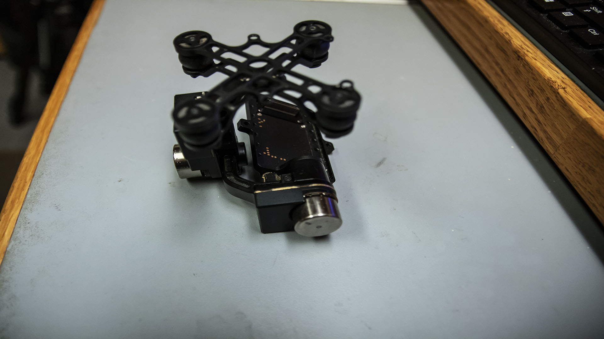

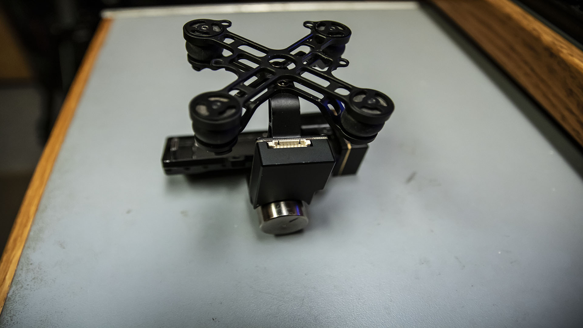

This is a H3-2D gimbal. There's no Yaw motor in the top of this gimbal.
I have both the H3-2D and the H3-3D gimbals. You can find a comparison of both gimbals on google. Here's a link.

yes, i deffinetly have a h3 2d, and the rotor i took picture of is the one that dosent work.that is to say, the one that controlls camers movement on y axis, up and down.
