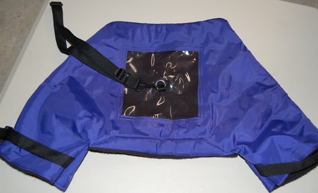

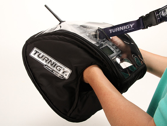

When it gets cold, you might be able to use one of these. I had one years ago and they work great.
