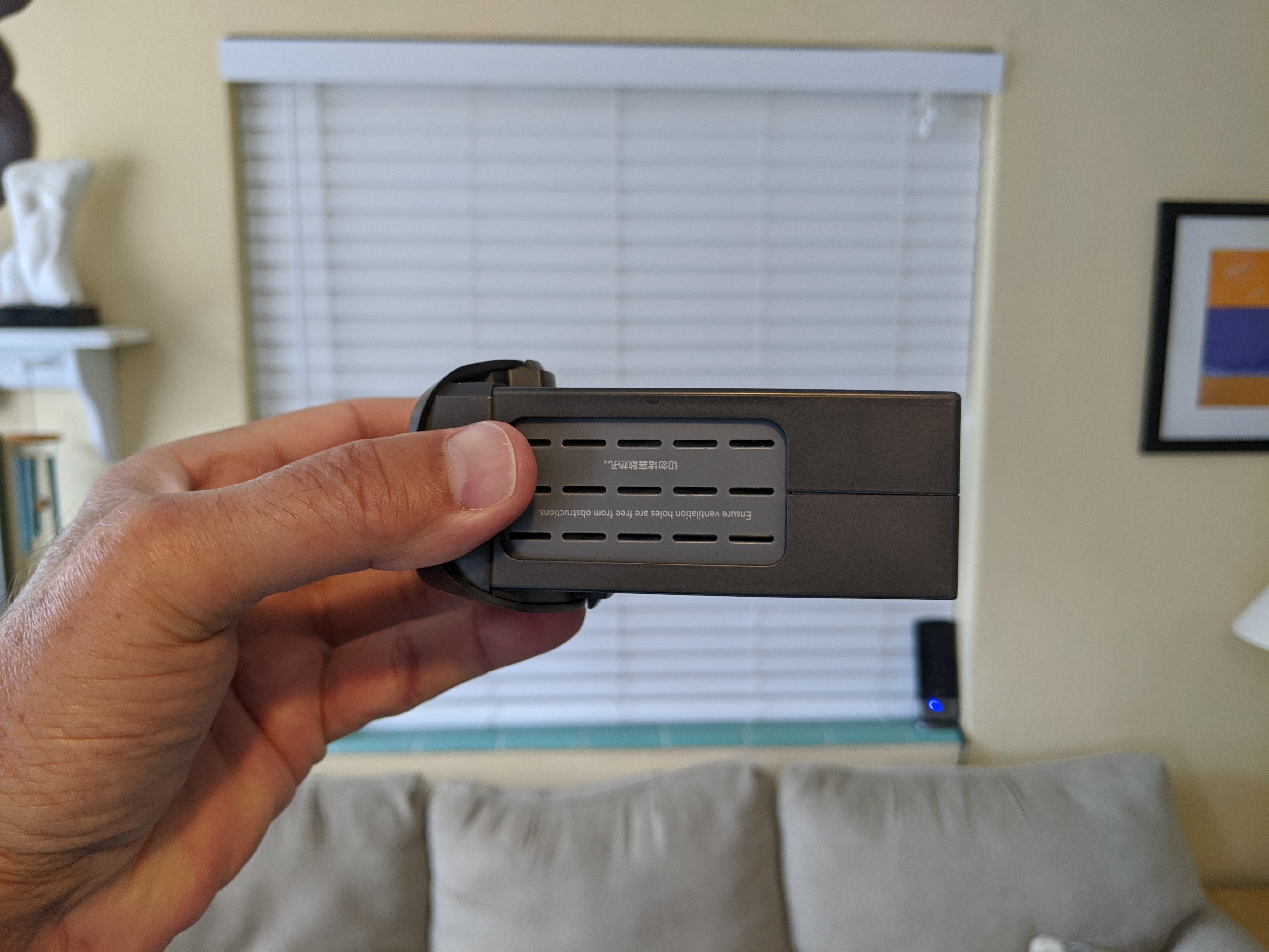

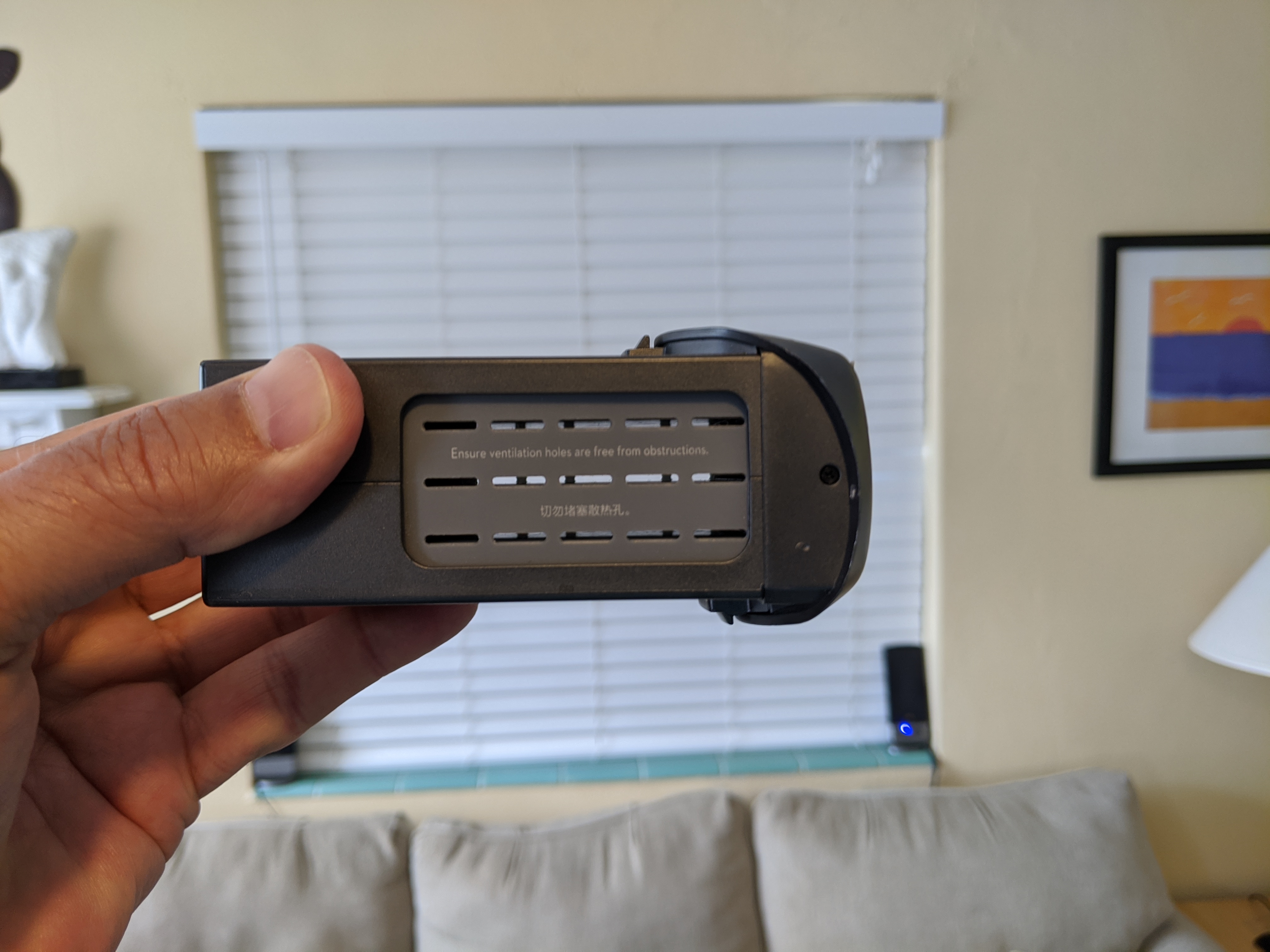

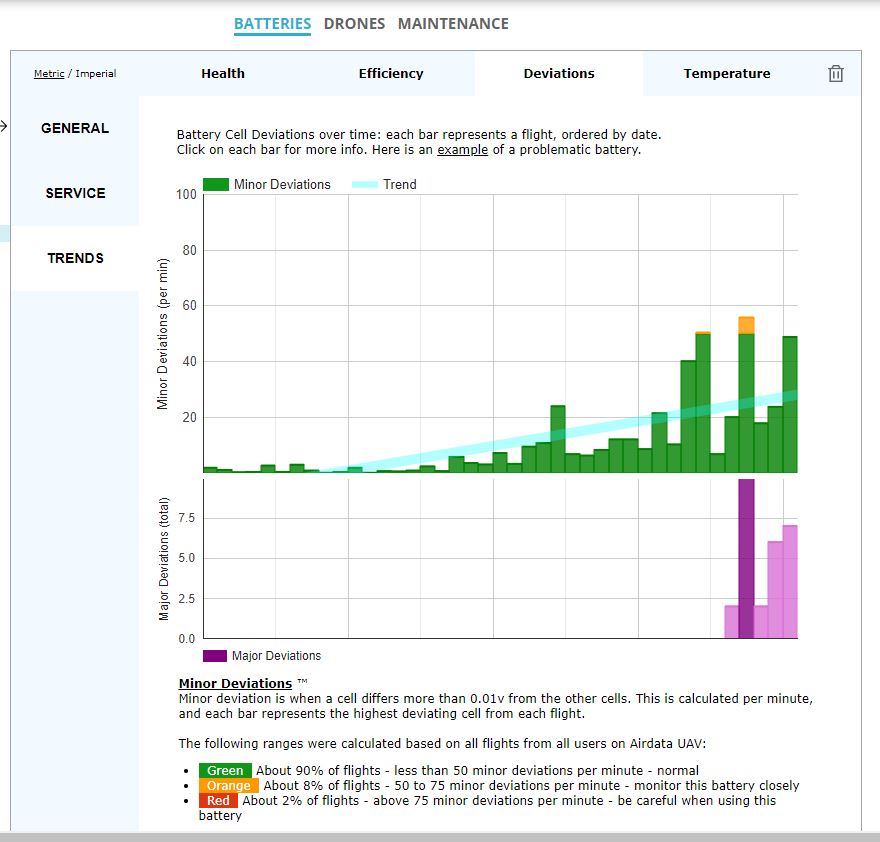

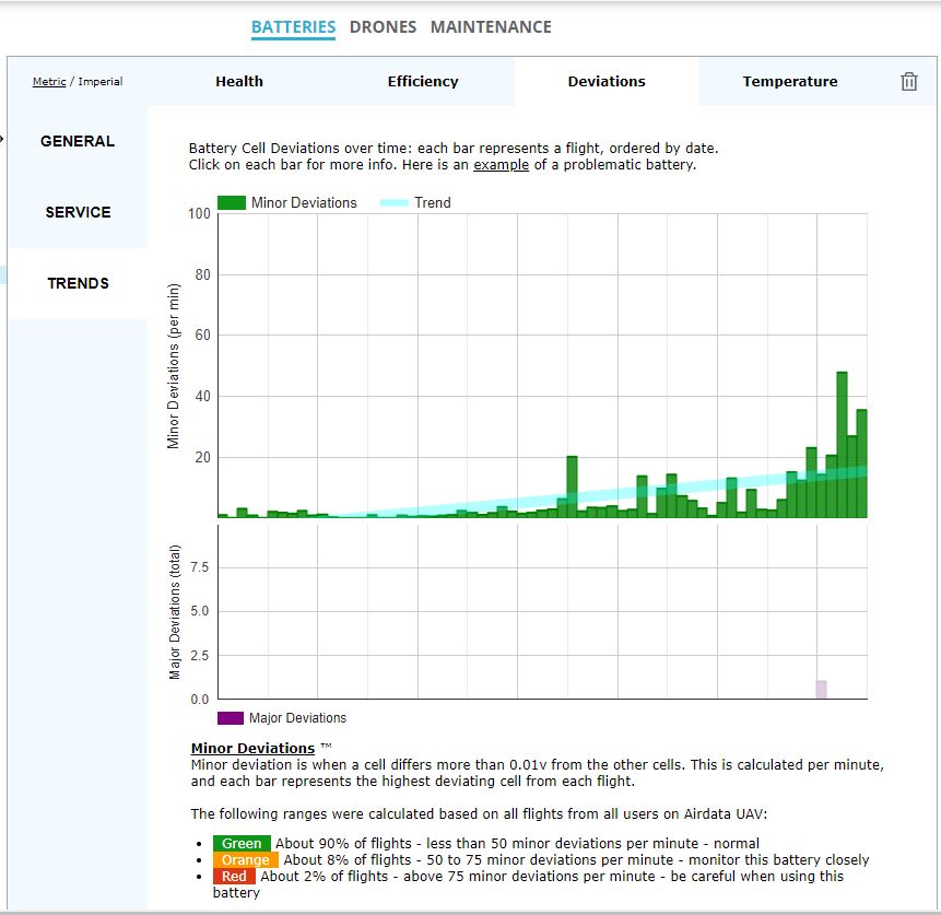

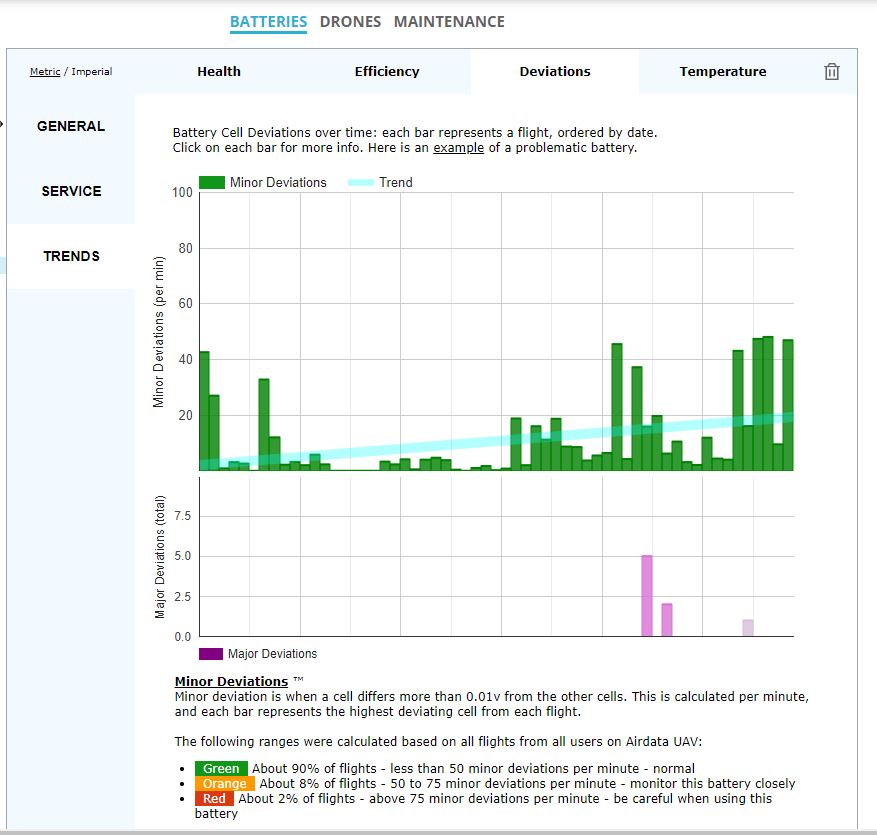

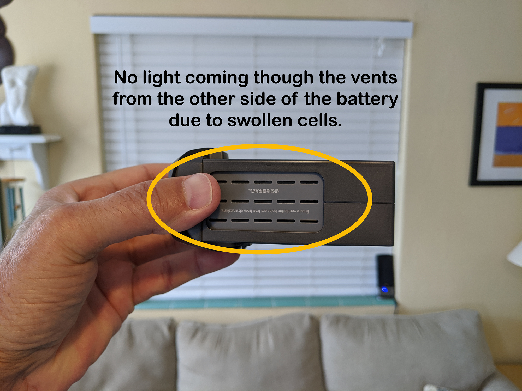

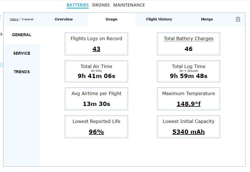

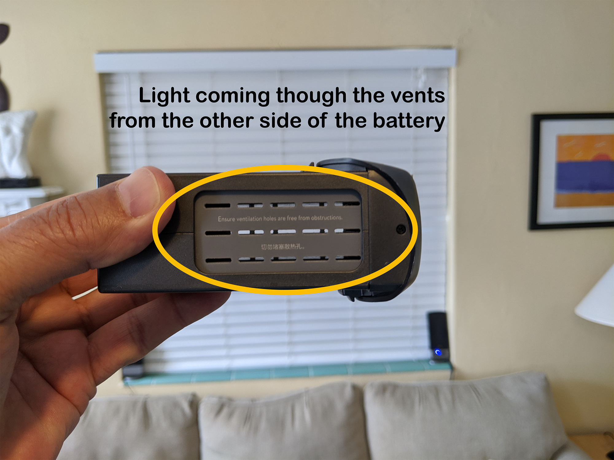

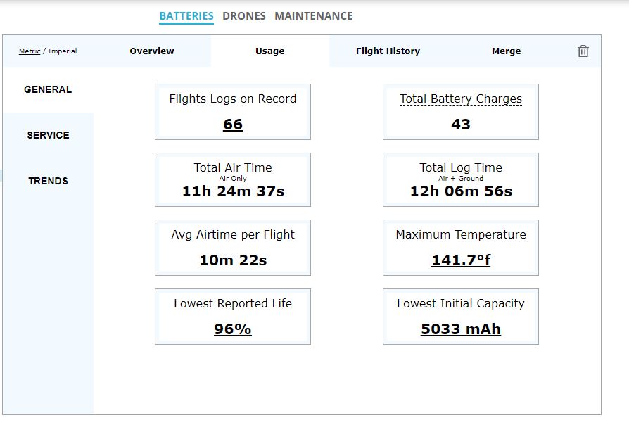

On two consecutive normal flights, the batteries swelled and were difficult to remove from the drone until they cooled. Even after cooling down, the cooling vents remain blocked by the swollen cells. (See attached photos of normal open battery vents and a battery with blocked vents.) I subsequently noticed another battery that has never given me any trouble also has swollen and blocked vents. I have attached AirData deviation charts for all three batteries for your review. Would you fly with any or all of these batteries, blocked vents and all? I appreciate in advance everyone's feedback and advice.

Swollen batteries indicate you have a leak in the protective skin around the cells and gas has leaked out of the battery. Normally this is due to overheating but old age and marginal build quality can also cause that. It is risky using them even though your system may not show an error. A catastrophic battery failure could occur or the drone could catch fire in flight. You can monitor the battery temperature in your DJI flight app. Here in Los Angeles I don’t fly when it is over 95 degrees Fahrenheit. Flying at 105 one day I lost some batteries to overheating, I took them to a local expert, he said after hot days lots of repairs come in mostly due to batteries overheating.

Zoom in and look closely at the battery photos. The first one illustrates how you can see light through the battery's vents. The second photo shows the vents obstructed by the swelling. You can see in both photos the DJI placard instructing to keep the vents clear.
Thanks to all for your feedback. I'm not going to fly with the swollen batteries. Not worth losing a drone and jeopardizing a job mid-mission as most of you wisely suggested. Will use them for preflight configuring, ground testing, etc. as suggested by R Martin above. Gotta say it's painful though having to bench three batteries simultaneously.

Compare the two photos below that might better illustrate open cooling vents versus obstructed vents. All new batteries have open vents.
