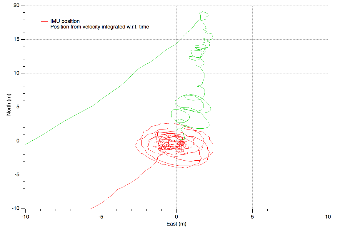

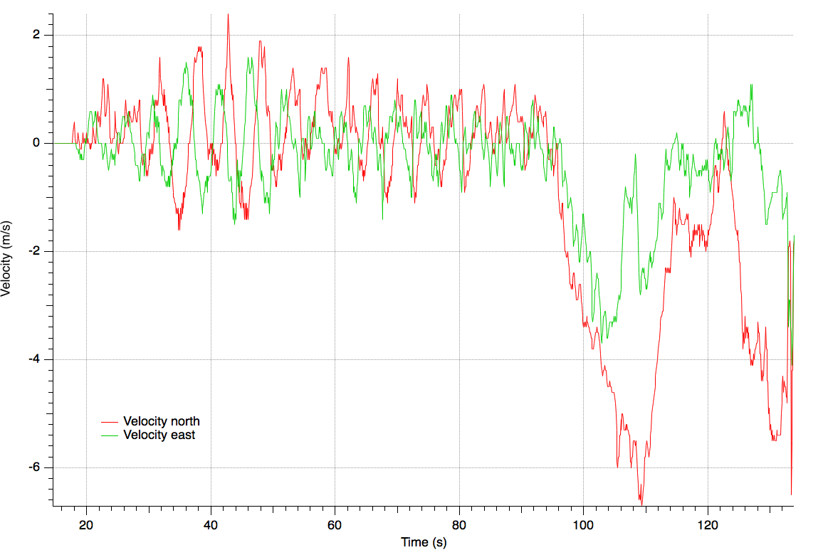

As @Meta4 mentioned, this behavior generally indicates that the aircraft was initialized at a location with a distorted magnetic field, resulting in the IMU yaw value being incorrect at takeoff:
You supplied no elevator or aileron inputs for the first 100 s or so, and the oscillatory motion arises because when the FC attempts to correct for drift but applies thrust in the wrong direction.
That also shows up as a significant discrepancy between the recorded aircraft velocity and the IMU position record that is modified with the GPS location data.
To determine exactly what happened will require the DAT file from either the aircraft or the mobile device, both of which include the raw data from the magnetometers.
