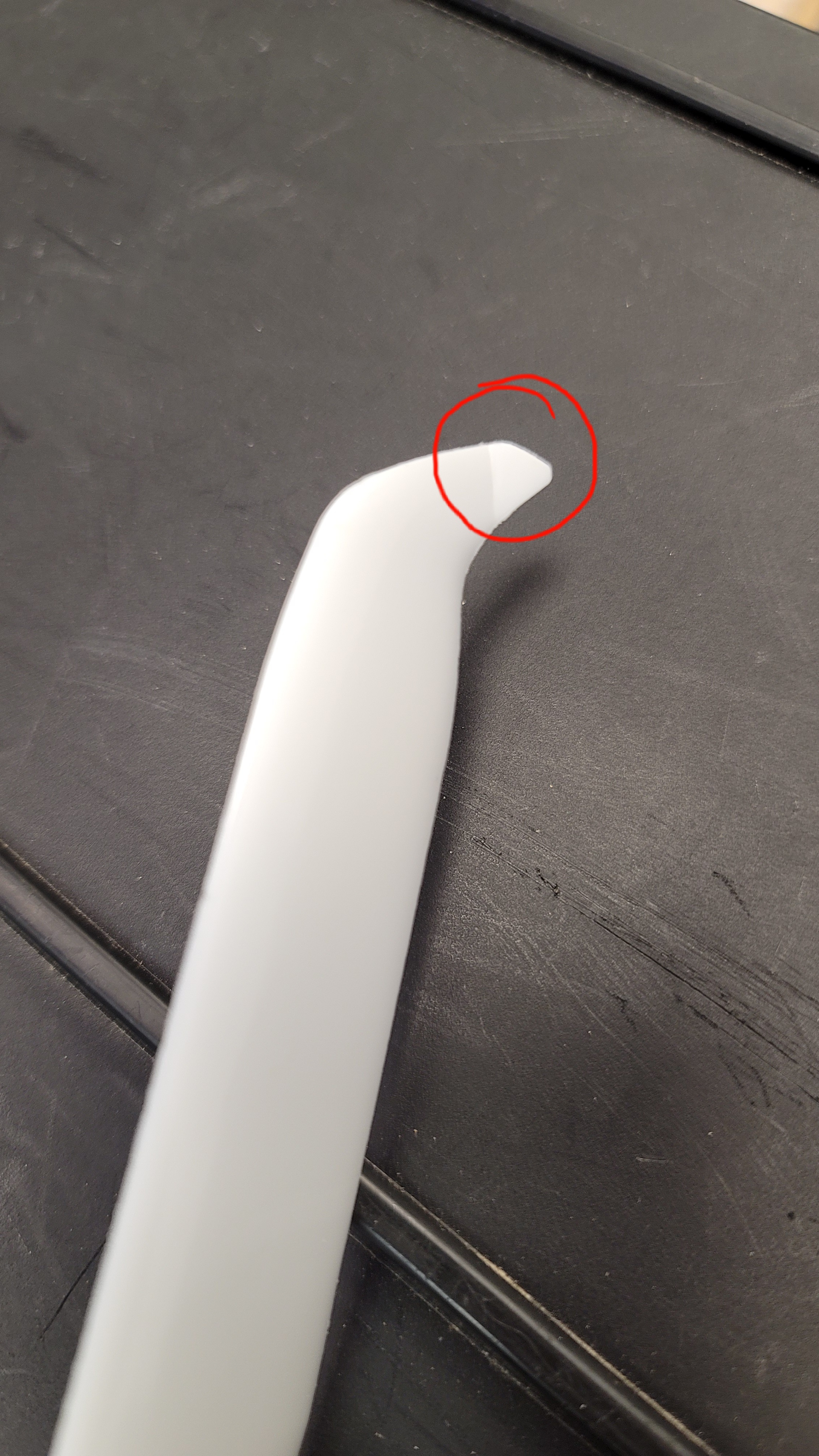

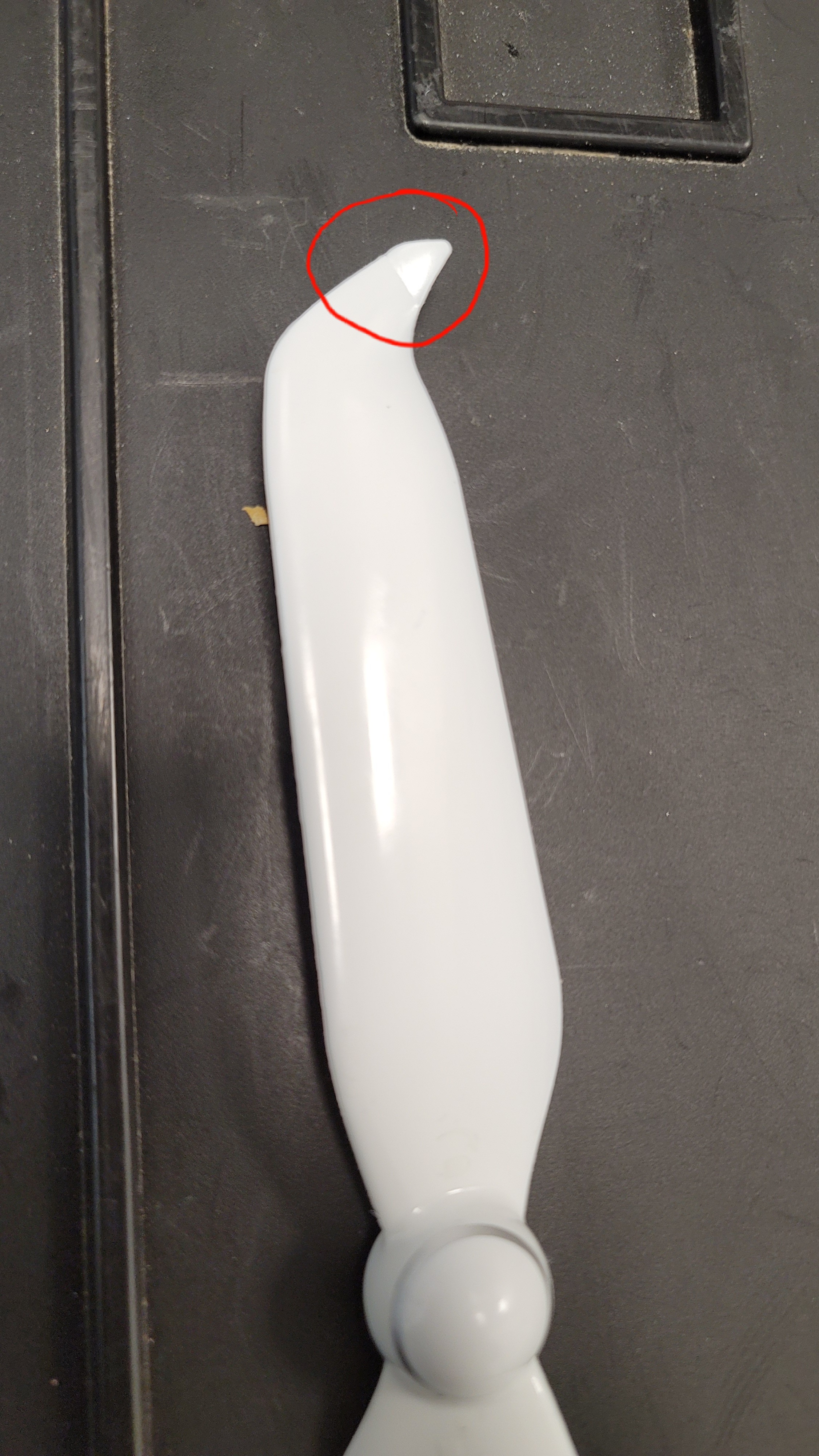

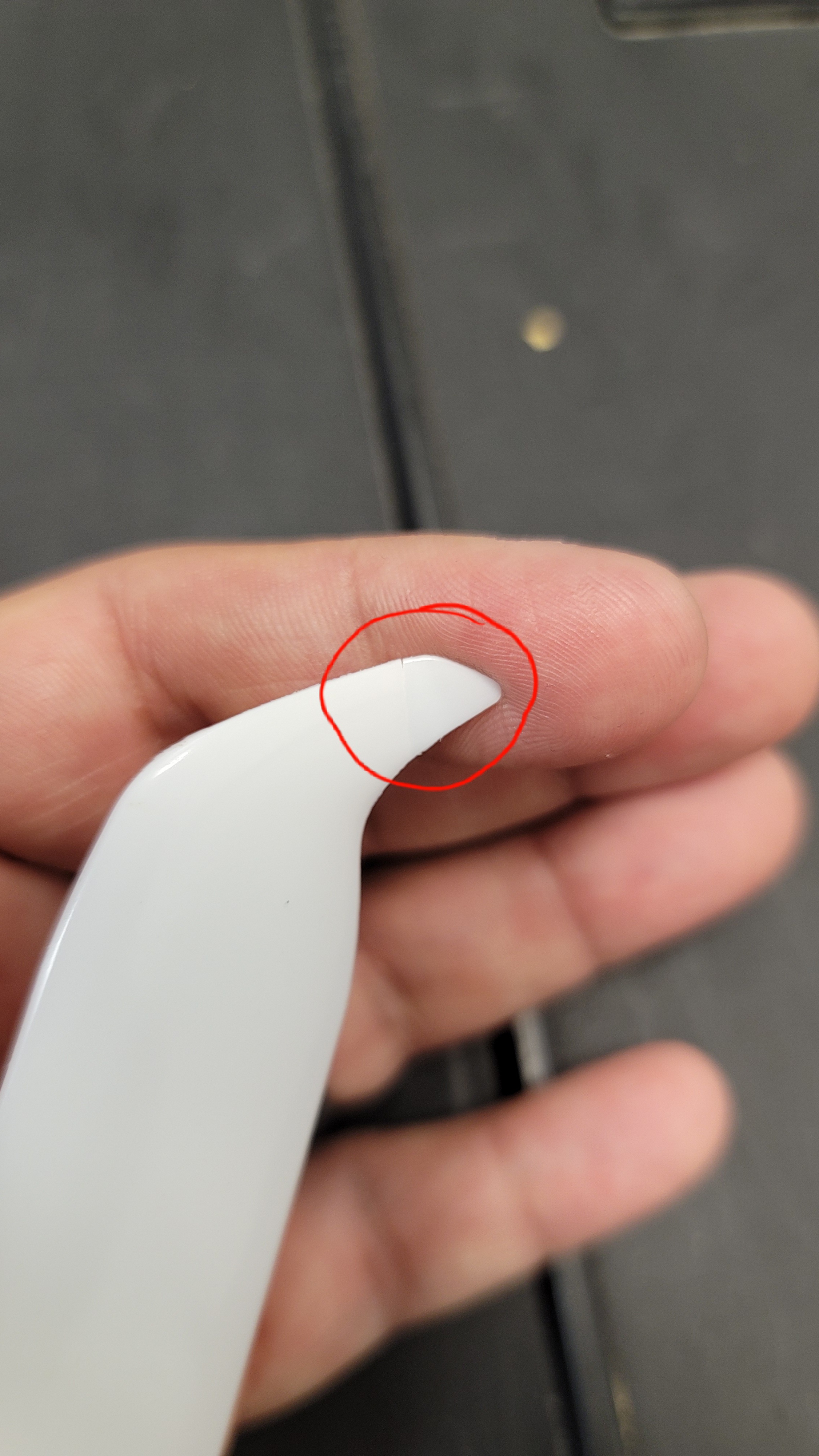

Had a job to do today. Thankfully my preflight inspection found this. Could have resulted in a bad outcome. If you don't have some type of preflight routine i recommend you put something together. I realized i shut my case on the tip of my low noise props. ugh..

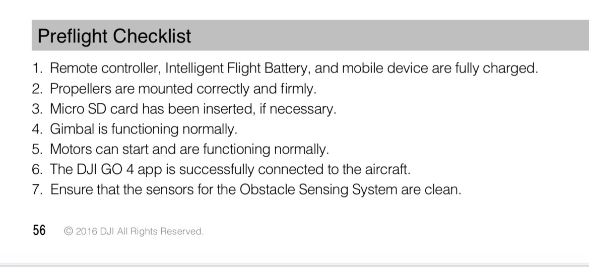

Here is the preflight checklist DJI provides in the manual for the Phantom 4 Pro

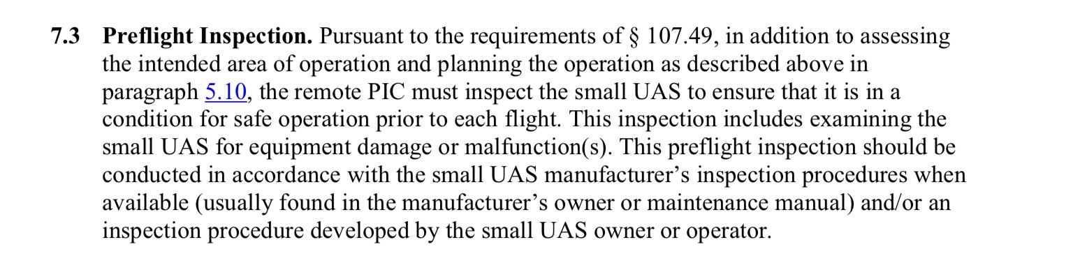

For those who fly part 107 you are required to conduct preflight inspection.

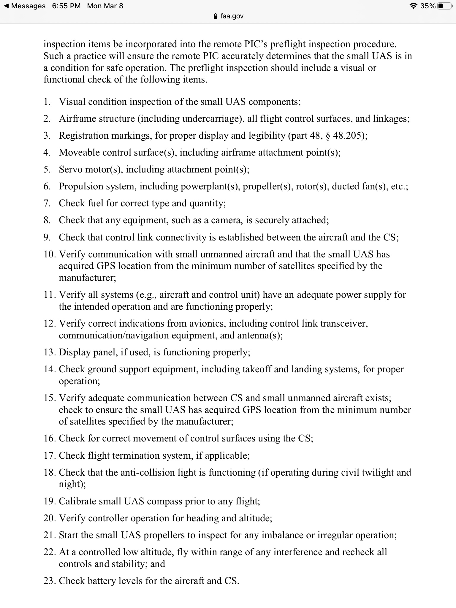

Here is a recommendation from the FAA

A preflight detailed inspection should be mandatory; just like we do when flying a manned aircraft. Also a good post flight inspection is good too. In the summer I always have parts of bugs on the props. These must be removed and checked for damage; just like the photos above. My bet is many just unpack and launch. Probably when so many fall out of the sky.

A preflight inspection is mandatory under part 107. I believe most recreational flyers and even some part 107 don’t preflight each flight. This means preflighting each time you bring your drone home to change batteries. Manned pilots preflight each flight not just because it is mandatory but because their lives depend on it. There are no big consequences (unless one has personal or property damage) for those who’s lack of preflight was the cause of their accident other than becoming great at fixing drones. They are very much appreciated here on this forum.

Good catch on the propeller tip. During my inspections I mostly see blood from the bugs that met their fate at the hands of my Phantom.

#19 not good. Compass calibration not necessary unless app tells you to.
