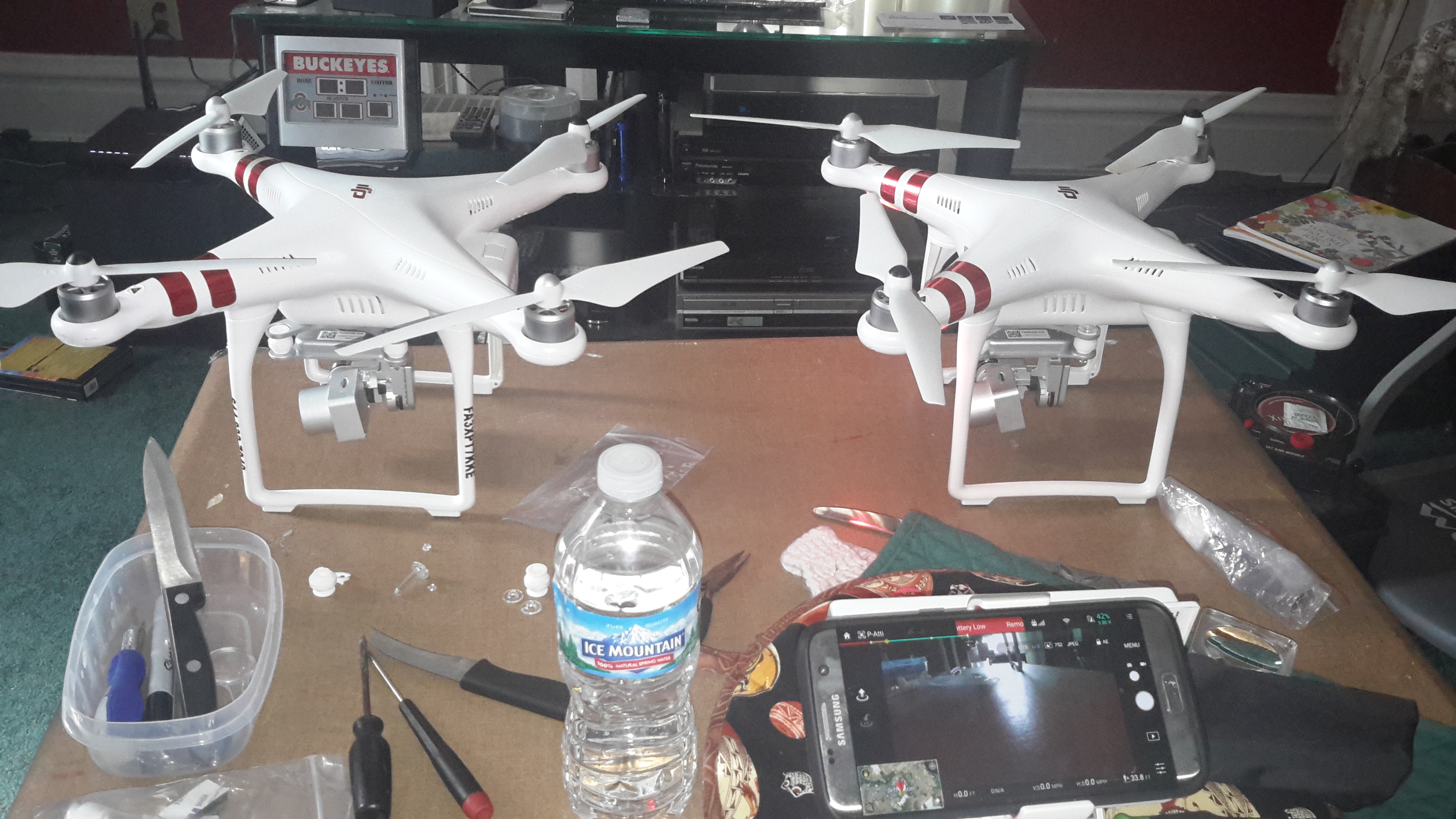

DB is right! I recently bought a open box P3S without a camera cheap. Could not bind the bird. Bought a parts P3S. Put the camera on the open box bird. Works great! Just bought another P3S with only 1 hour total flight time on it that the camera gimbal mount broke off in a crash. Not a visible scratch on the camera. Got a good gimbal mount from the parts P3S. Fun stuff! 20170314_134526.jpg
