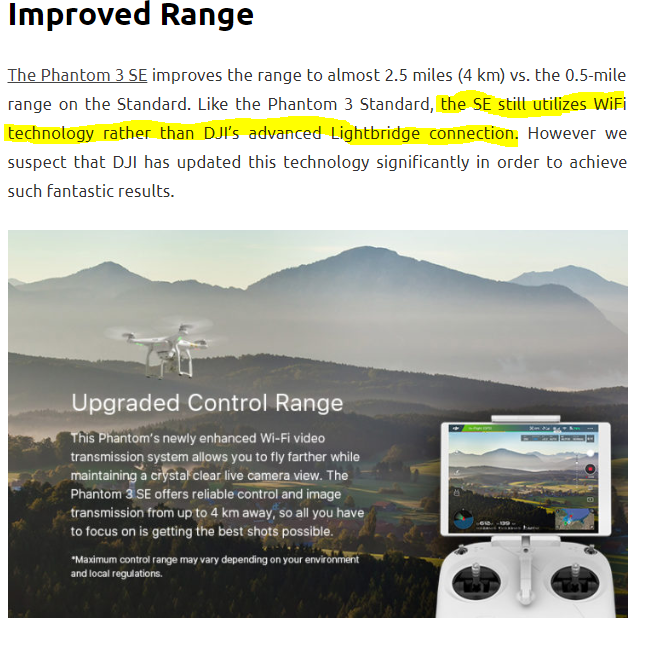

Are you sure the SE has lightbridge? Before I bought mine several review sources said no Lightbridge, it just has 5.8GHZ Wifi to increase the Range. My range is somewhere at 5KM with a Beer-can range extender mod so no problems there but if you look at my above comment i have MUCH more pressing problems.

Yes. It uses exactly the same OFDM module as the P3A&P. The antenna on the remote that was used for control signal on the standard/4K is repurposed and does nothing more than provide for the wifi connection to your phone/tablet. The internal patch antennas in the remote are used for the link to the phantom.
Doesn’t make it incorrect.
It makes the statement "Lightbridge" incorrect. It may have the same and or similar function as far as integrated components go, but the statement is misleading for some.

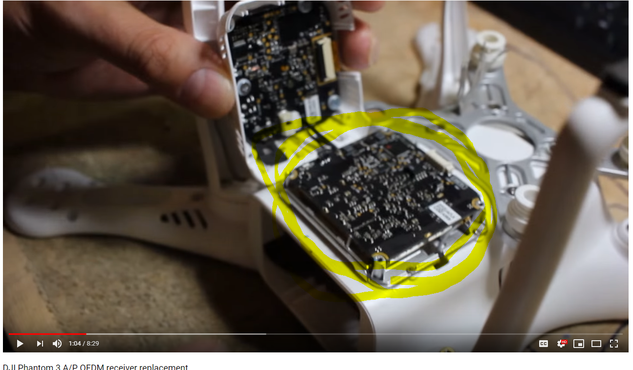

Ah there you go, when my SE was acting up with it's VPS I took off the VPS module that dude in this video is holding in his left hand. That panel underneath is the OFDM reciever. My SE doesn't have this, I know this beacause when I took off my VPS theres nothing but plastic underneath. I don't think we have lightbridge Will The Birds

A picture says 1000 words. My understanding (re the AC hardware) was from a tech at a DJI authorised repair facility who claimed to have had one in for a shell replacement. The remote setup is from various threads here following the SE release.
