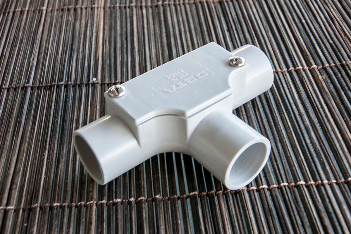

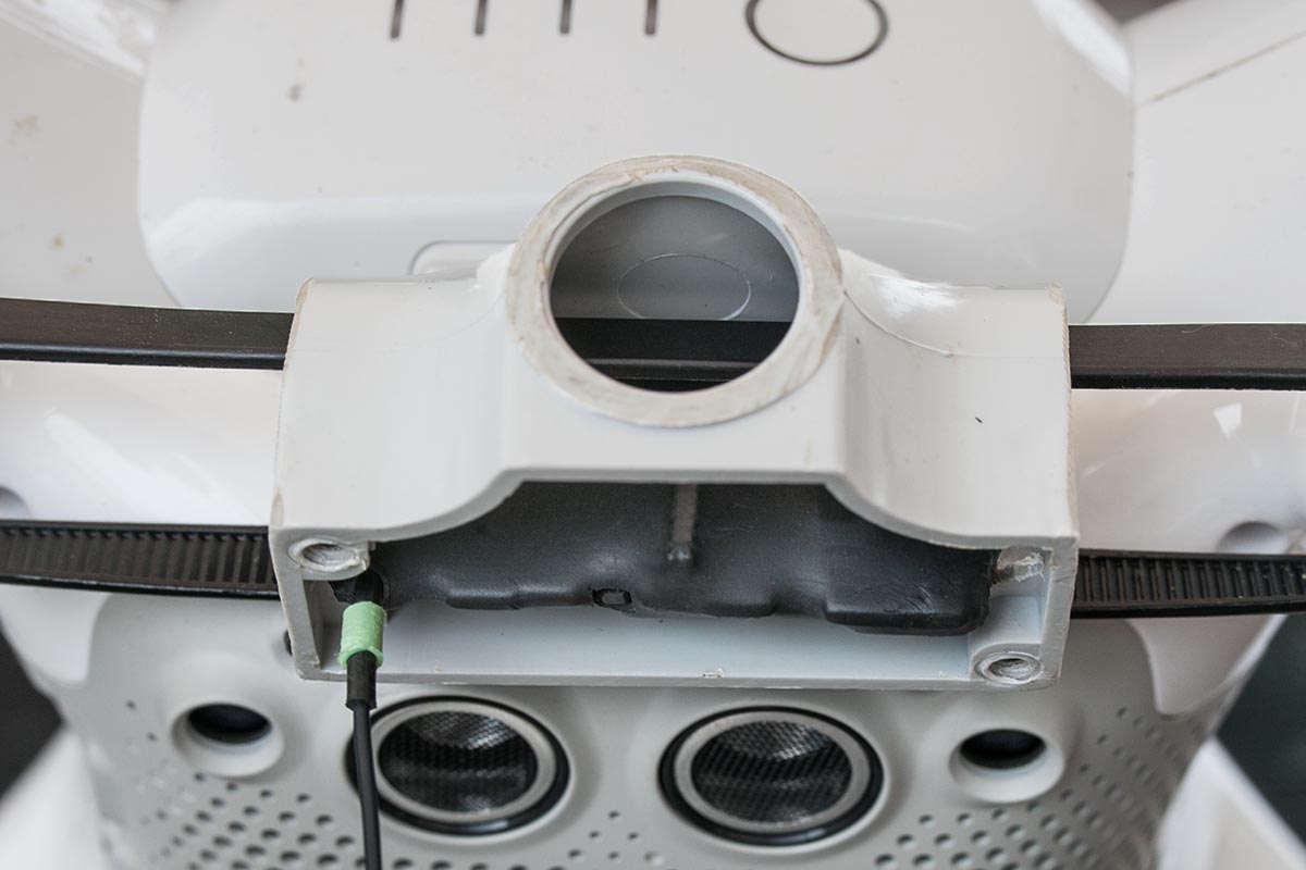

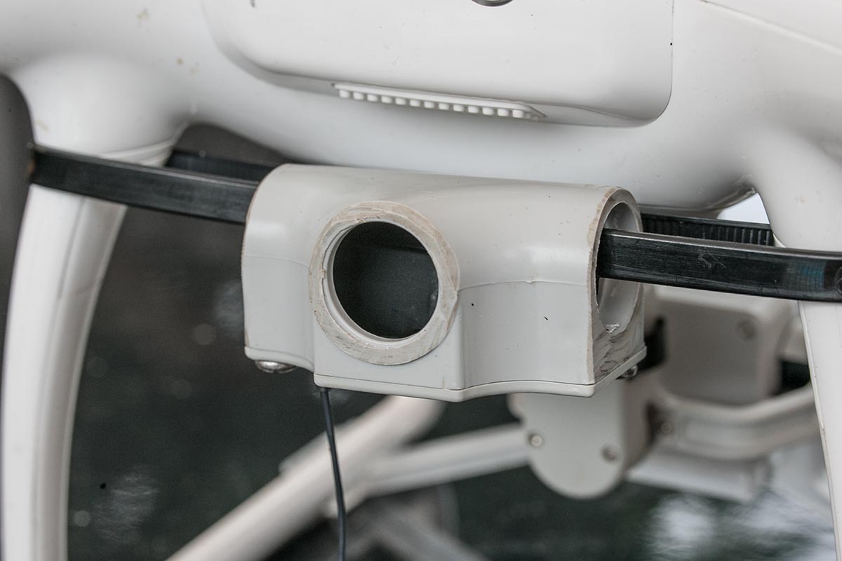

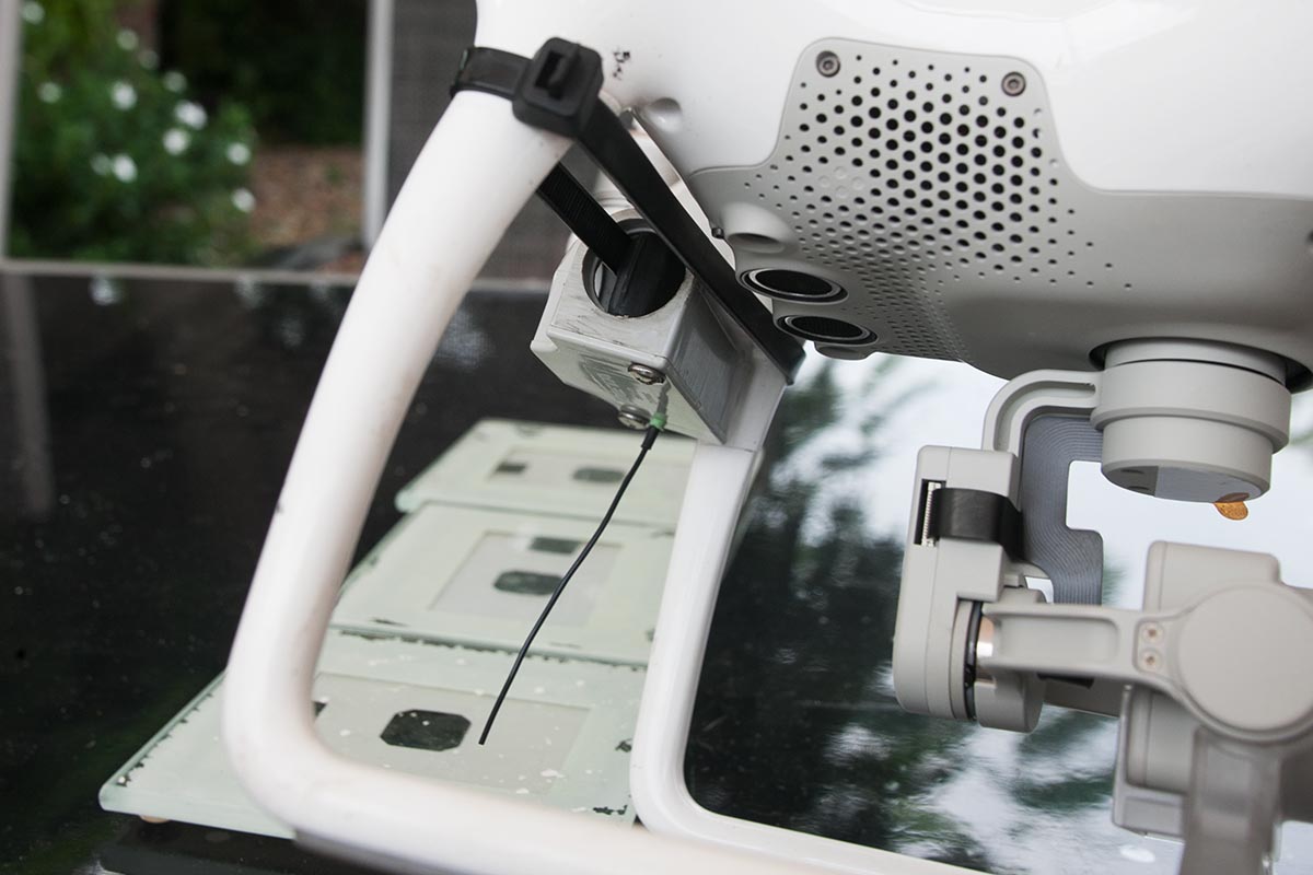

As promised, here are the photos illustrating the method I use to secure the Marco Polo tracker tag to my machine. It won't win any awards for looks but it's strong, secure and it works.
This is the component I modified to carry the Marco Polo Tracker tag.
In Australia it called an electrical conduit tee junction and costs around $2 from any electrical wholesaler.
The female conduit lugs have been removed leaving holes that are flush with the body of the junction. (A hacksaw or angle grinder with a fine cutting blade make short work of this.) Then file off any rough edges.

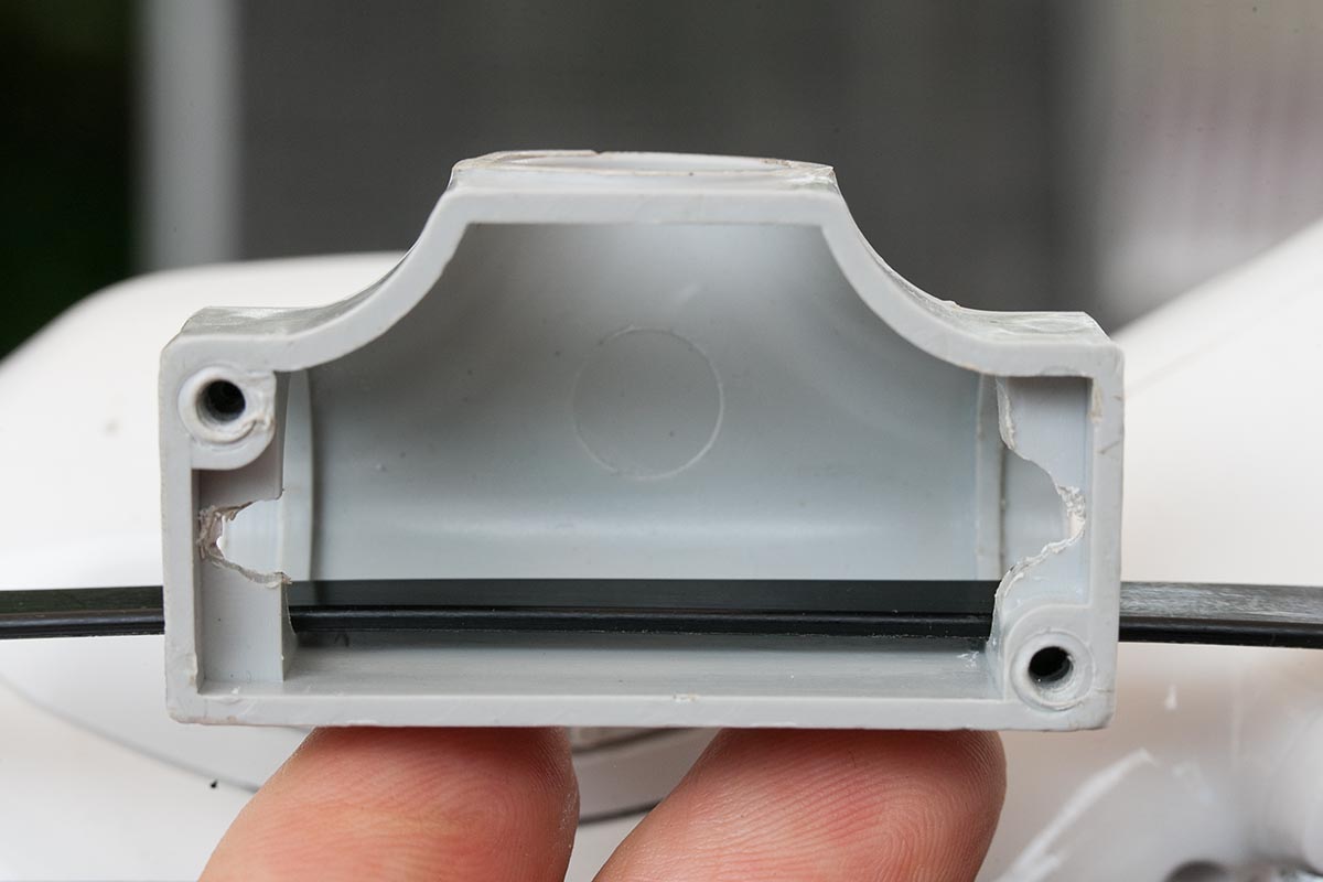

A small modification is also required to the inside so as the tag can be inserted. The photo shows where I’ve filed the plastic away, (none too neatly), to achieve this. The black strip is the cable tie used to hold the tag “housing” to the machine.

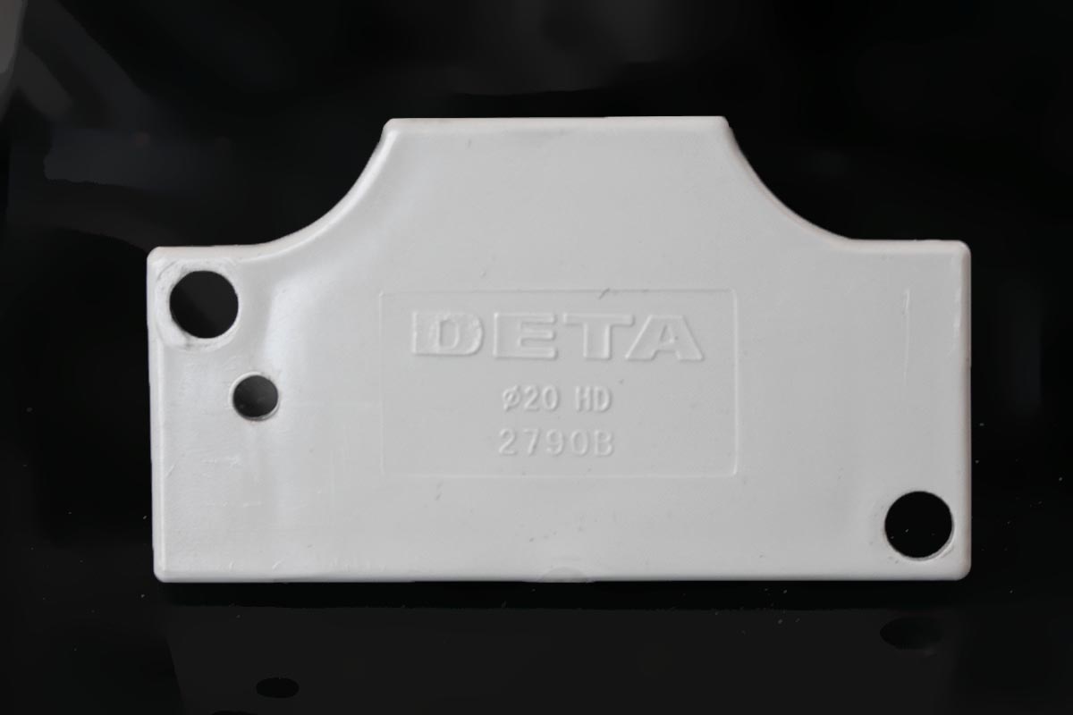

The tee junction cover needs a hole drilled in it as shown, to allow the antenna wire to protrude.
This photo shows the tag in place with the “housing” held in position with a heavy duty cable tie.
With the tag in position, the housing “lid” can now be screwed down.

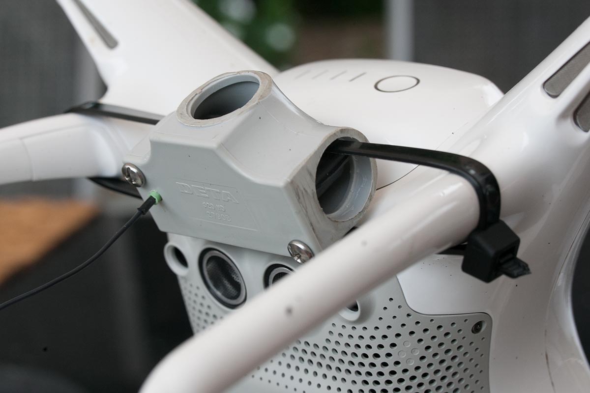

With the tag in place, the cover screwed down and the cable tie inserted thru the housing and fastened, the assembly in complete. (Don’t forget to activate the tag of course!)

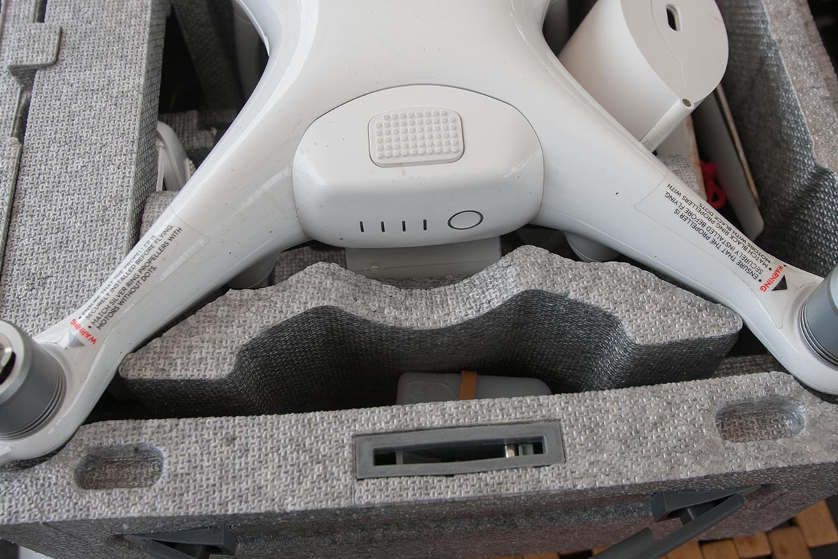

The first of the final two photos shows the completed housing with tag in place and in case you’re wondering, your bird will still fit into it’s case (see last photo), with slight pressure against the cable tie by pushing against the tag housing to clear the styrofoam.
I’ve done dozens of flights using this configuration with no mishaps to either machine or tag. Good luck!
what is the size of that part ? 1 inch ?

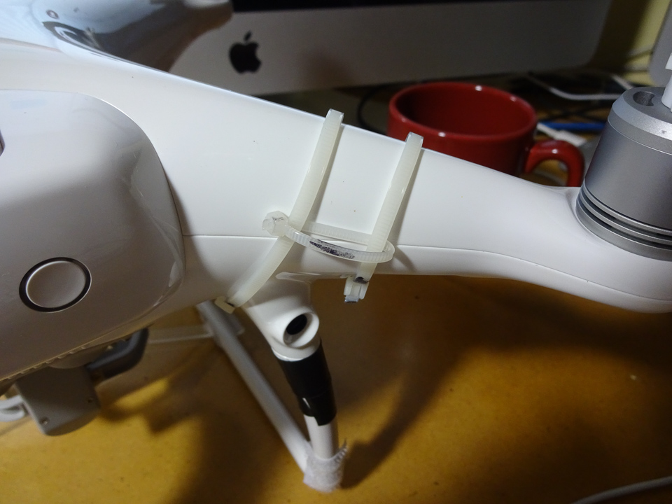

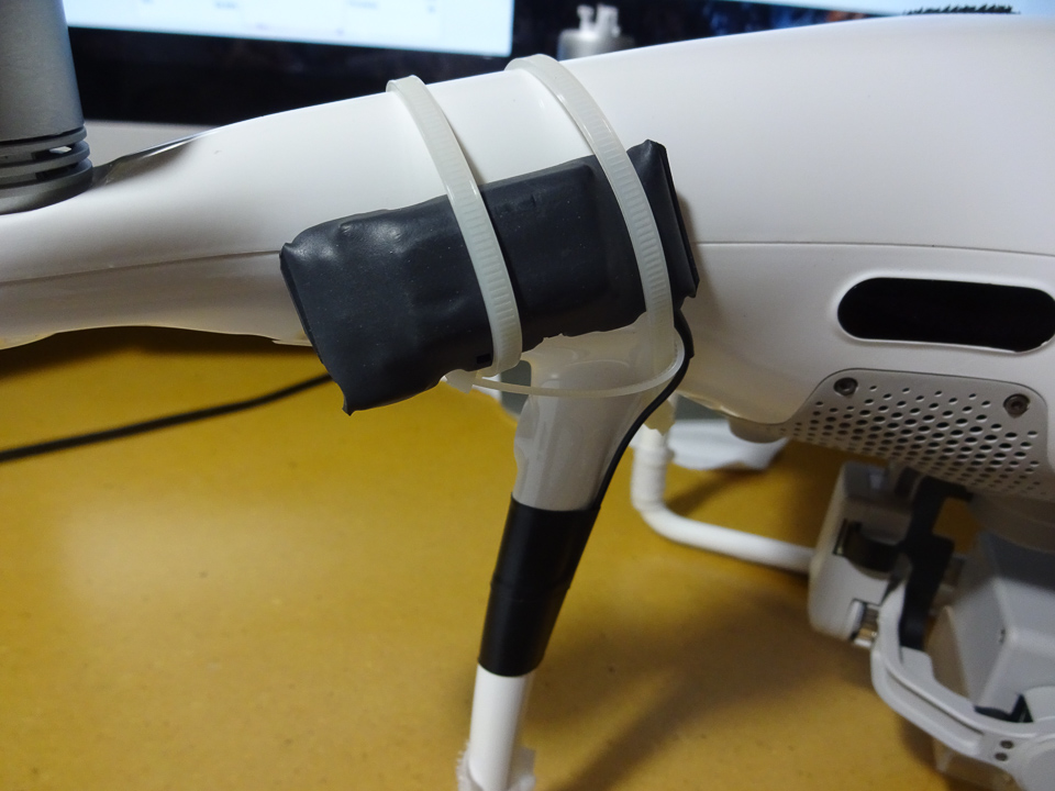

I'm a big fan of cable ties. Here's how I mounted mine, I think I got the idea from another post in this thread. If I ever want to move it to another aircraft I'll have to come up with something else. A velcro strap glued to the MP comes to mind, one more for the antenna.

I think Velcro works better than tie wraps. I've used Velcro to mount MP on my P4P and Mavic, it's very secure, and looks a lot cleaner, not to mention it's easier to remove and install MP and install on my P4 or P3P when I need to.
Better yet, it is a vibration dampener.
Hey John, that does look much cleaner! I should do that too. One mod I might make though is to leave some of the black velcro sticking out as a tab. So when I pull the tag off I'm actually pulling on the velcro instead of the tag, reducing or nearly eliminating the stress on the glue. The velcro had a tendency of pulling off the batteries in my RC planes, not any more. I also did that with the strobes I got from msinger, tie-wrap velcro hooks to the legs and glued a strip of loops longer than the strobe to the strobe. I don't worry about the velcro pulling off the strobes. I suppose I could have used glue on the legs but they're so curved I feel better using tie-wraps. They're visible in my photos.
Good tip on cutting out the notch in the loops!
I like that cut out idea as well, I also called the vender and asked if I could shrink white shrink wrap around what was already on the unit, and he said it was fine just dont mess with the antenna, it blends in pretty nice now on it being almost the same color :-)
