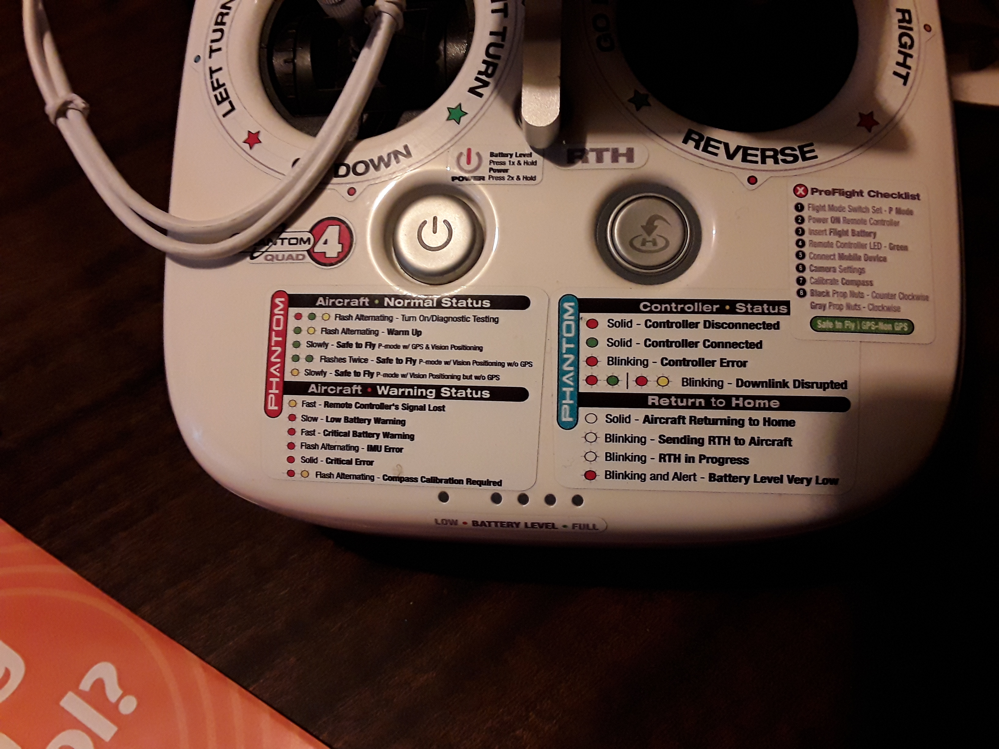

Here a light discription for p4,fast red flash(critical batterie warning)

A sticker explaining the flash warning might help, but who needs a stickers that explains the stick direction? Wait, I know! ;)
