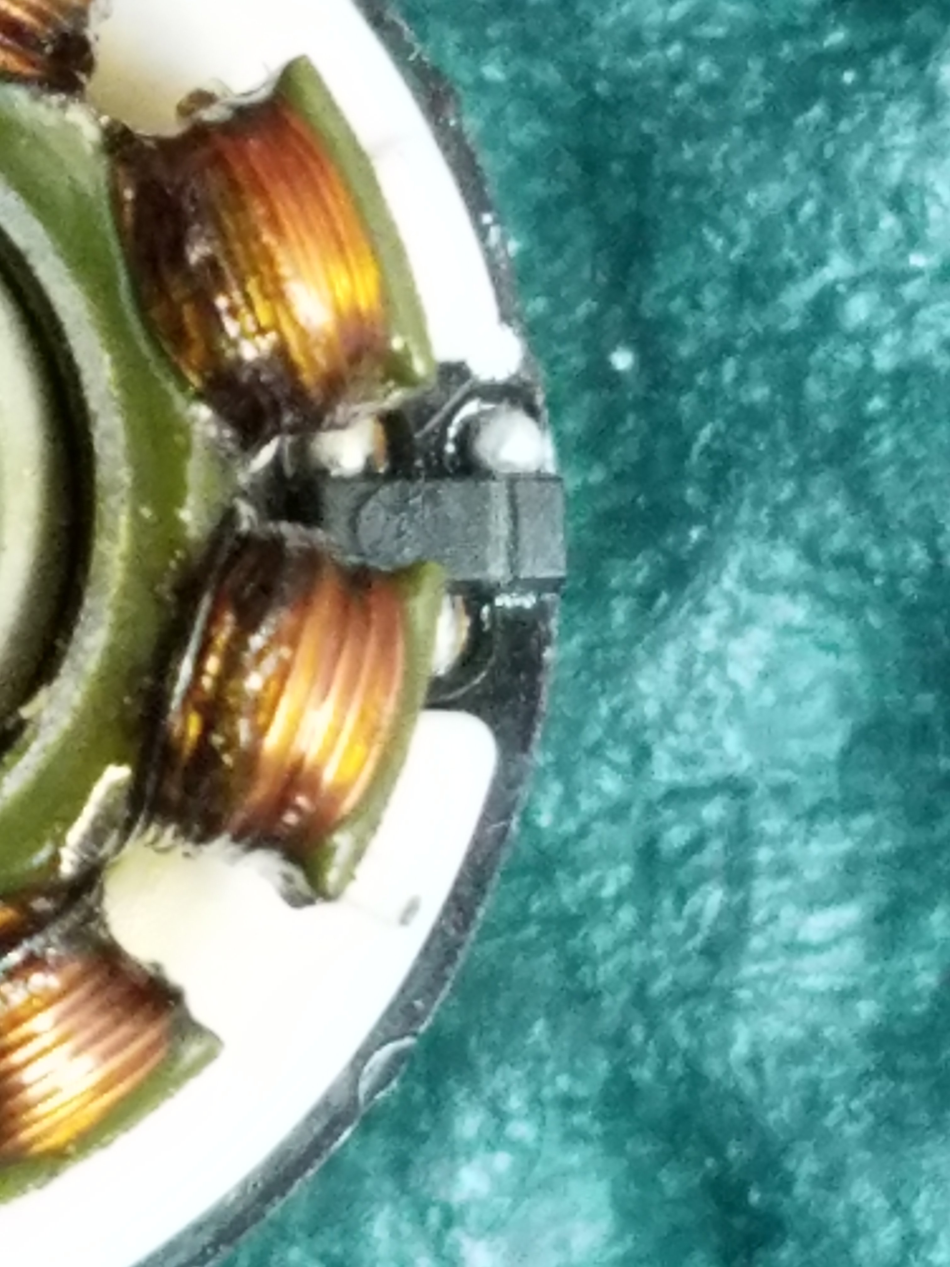

Actually I was talking about the sensors on the yaw motor. Maybe it has sand or dirt in the yaw motor if it has never had a hard landing. Here is a photo showing what sensor damage may look like. I don't think you will find it looks like this. This was caused by a crash
Thanks, I know what you are talking about, those motors are brushless so they use ‘sensors’ per say built in the rotor which in conjunction with the ESC (electronic speed control) switch on-off the motor. But you’re right I haven’t crashed and destroy the gimbal to be able to see the motor inside.
Yaw motors are fairly cheap. I would replace it. If you do be sure to watch this video
