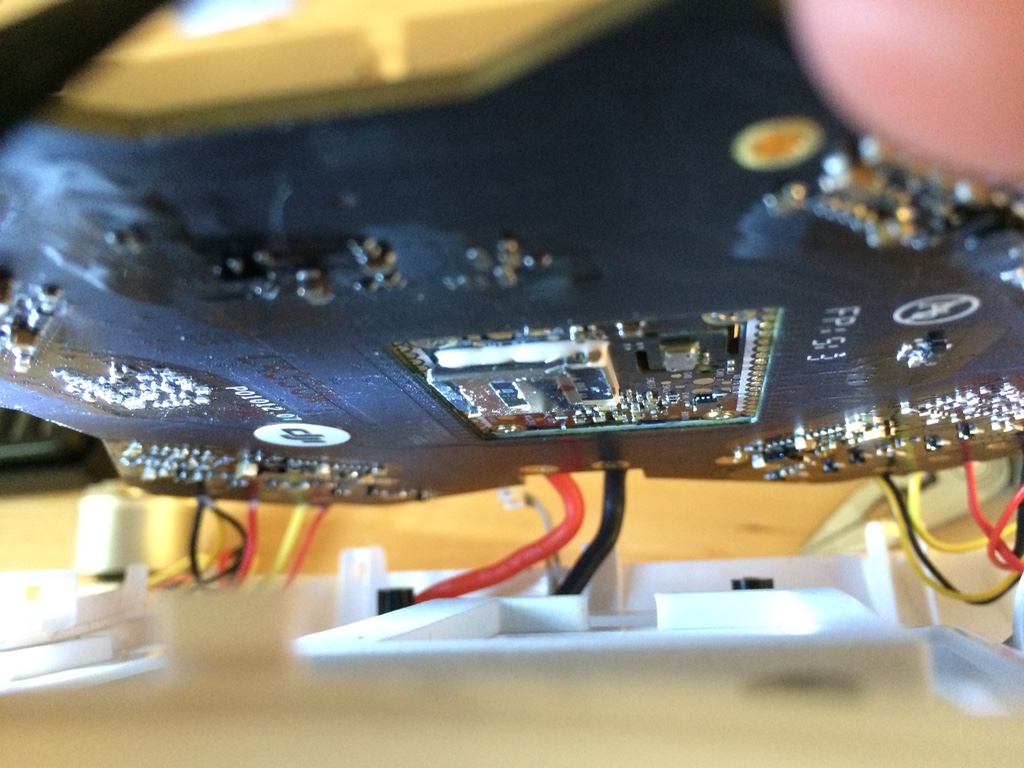

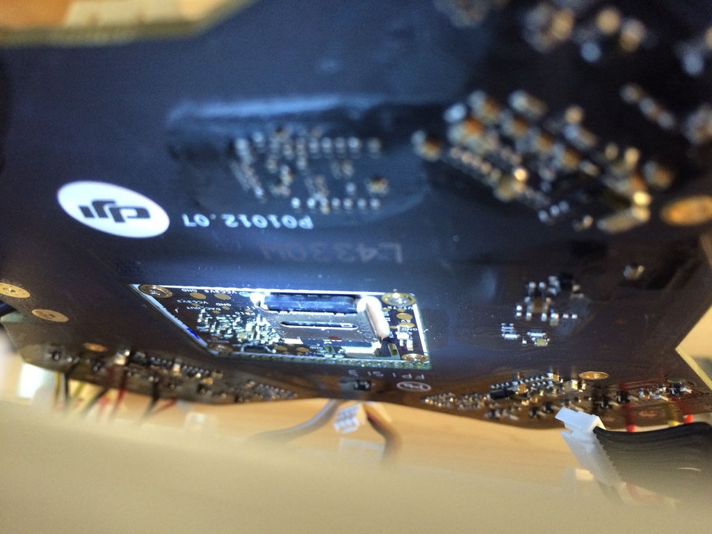

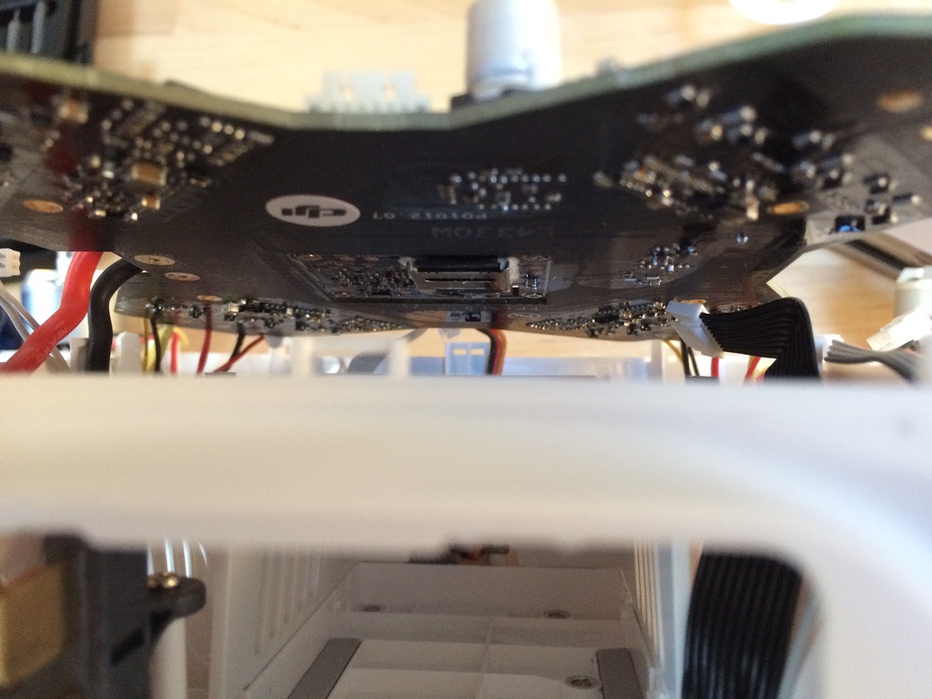

Were you able to get a good view under the black box in the middle of the board to see if there's s CANBUS connector under there? I didn't see it anywhere else on the board that was visible. The P2V+'s had a slot for it.
Either way the P3 will have to be opened up for FlyTrex.
Those pics of the SD card show what's under that box. Basically there's no connectors underneath, I can only assume they piggy back one of the existing connectors - we'll know more once the Inspire version is released which will be before the P3 one as I've heard they're practically the same.
Don't bother. You can see all contents of the sdcard when you connect the craft to a computer and put it in flight data mode.

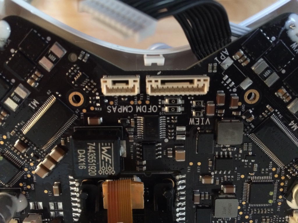

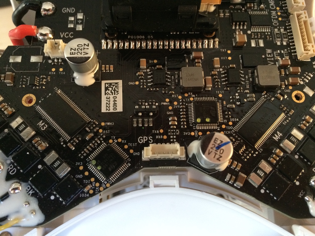

The black box is going to be the IMU. The WE 744xxxyyyy is a good current shunt (inductors for motors isolation from RF circuitry). I can't see the MCU ? ****, may it be on back side ....??
