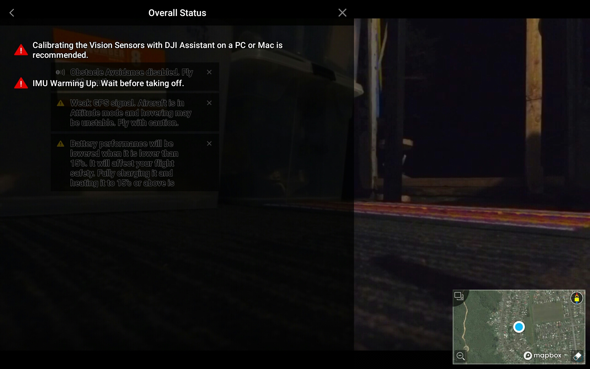

432E6B3F-8C0B-4520-96B0-857CEB758202.png Is this the message you are getting on your P4...i kept getting this on mine even after calibration
