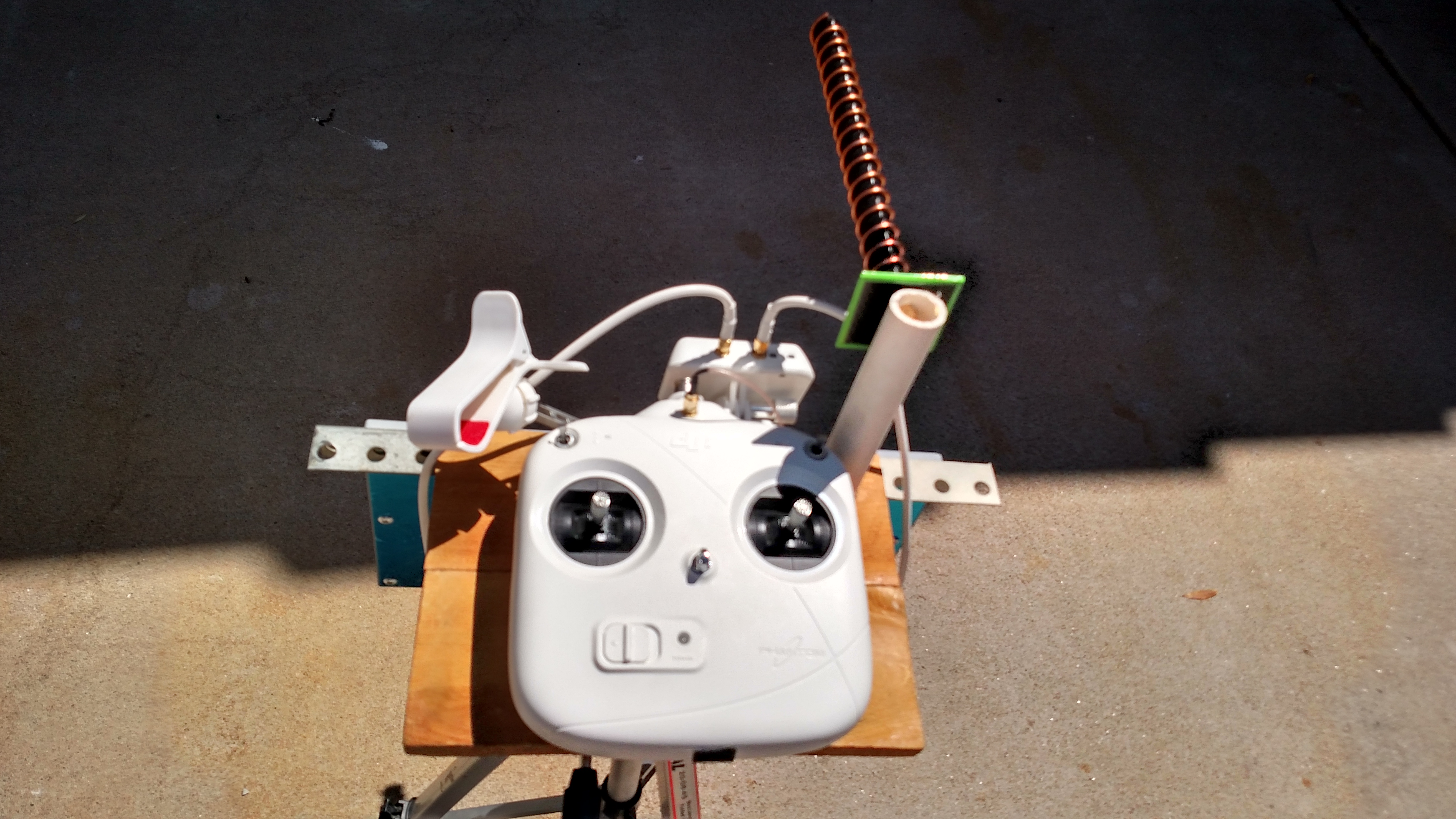

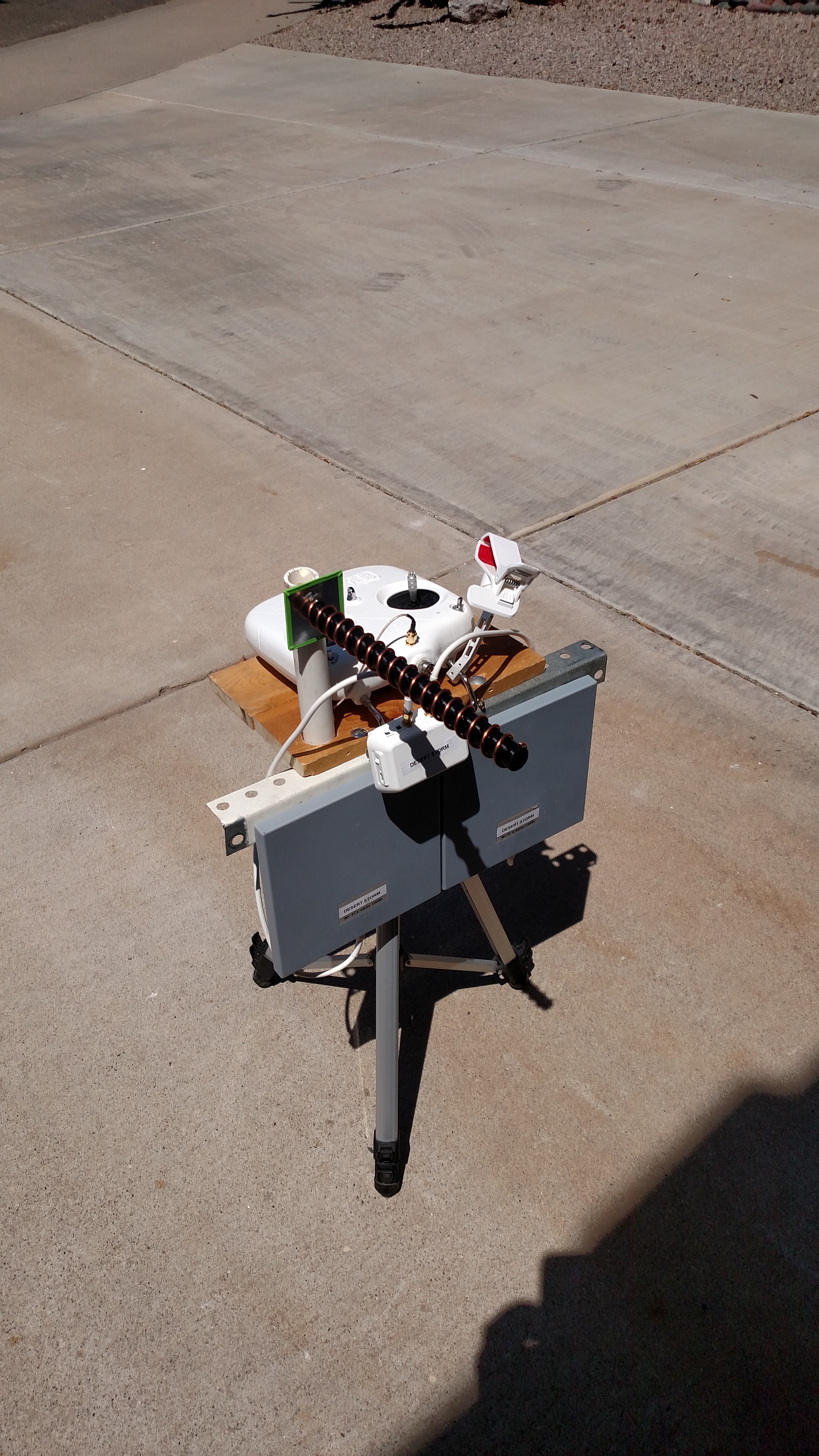

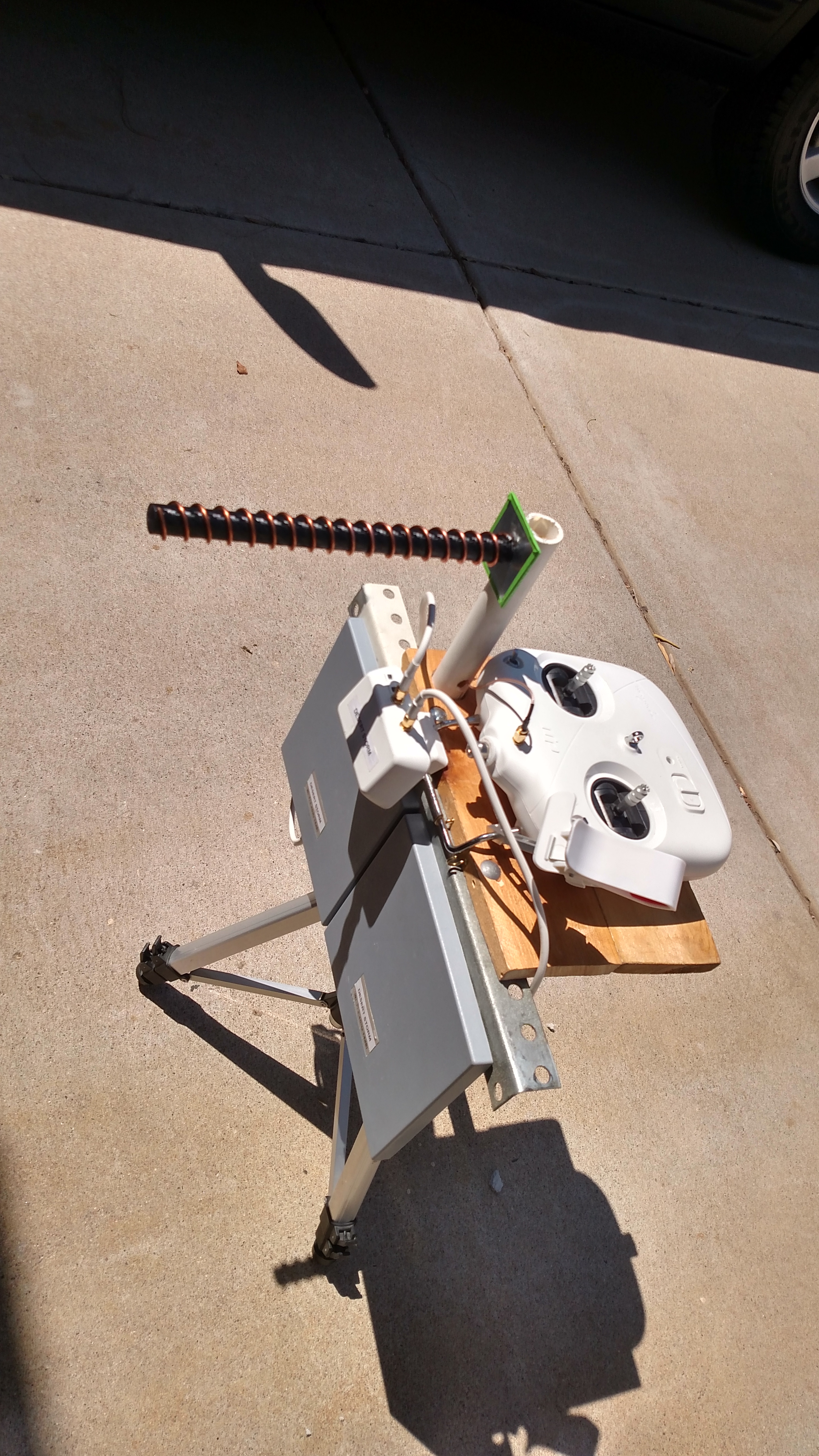

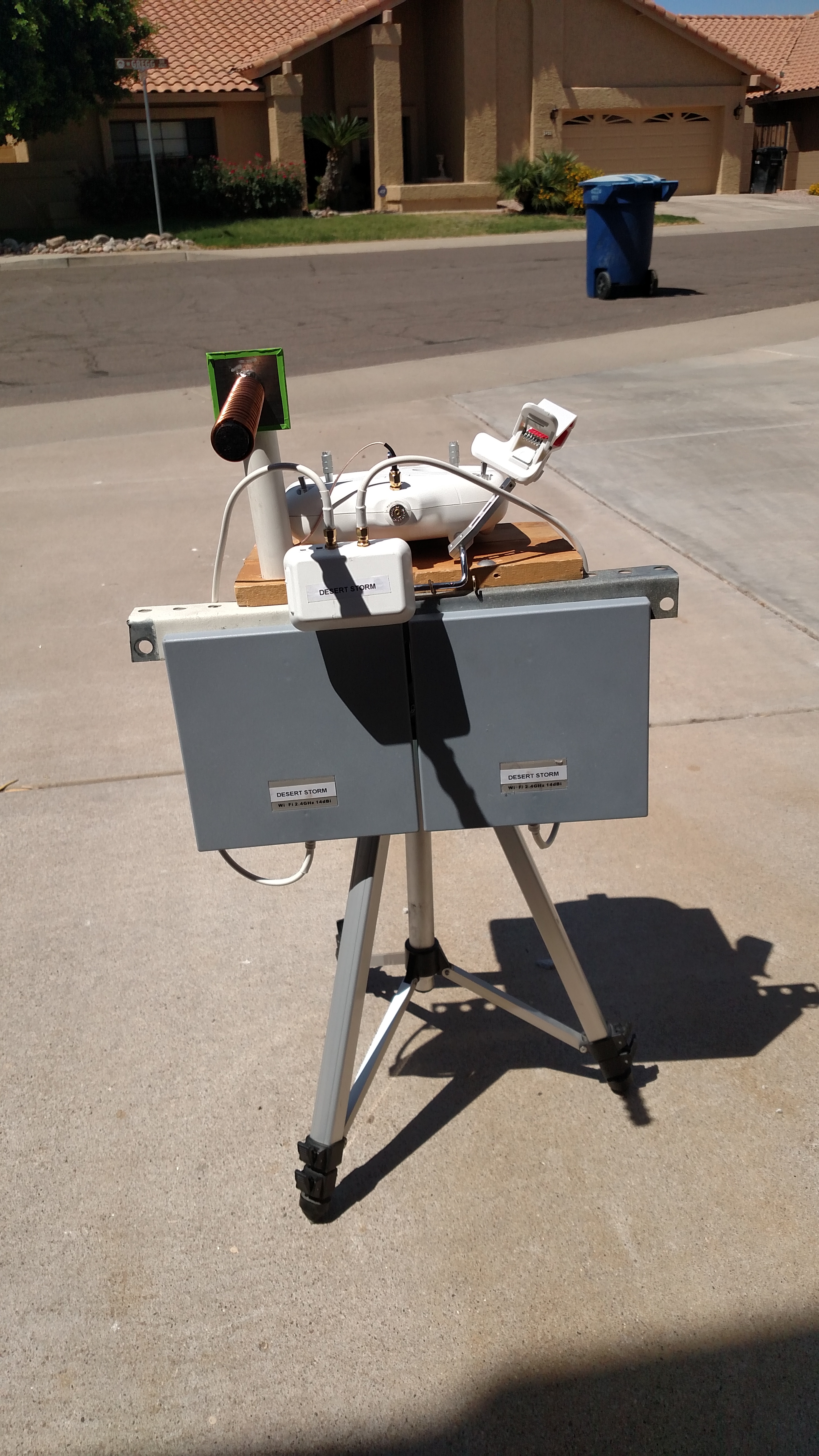

Ok got my earlier Christmas present from Procharged97 today. This is some Serious **** man. And a note to Pro I beat your kids hated you if you did the present at xmas time, I'll give you 125% on wrapping. Db I don't know on yours but it took me 15 minutes. Here are some pictures. I have some different cables coming in Thursday, but I like the setup.
Hey man! what did you use to attach that antenna to the PVC pipe?

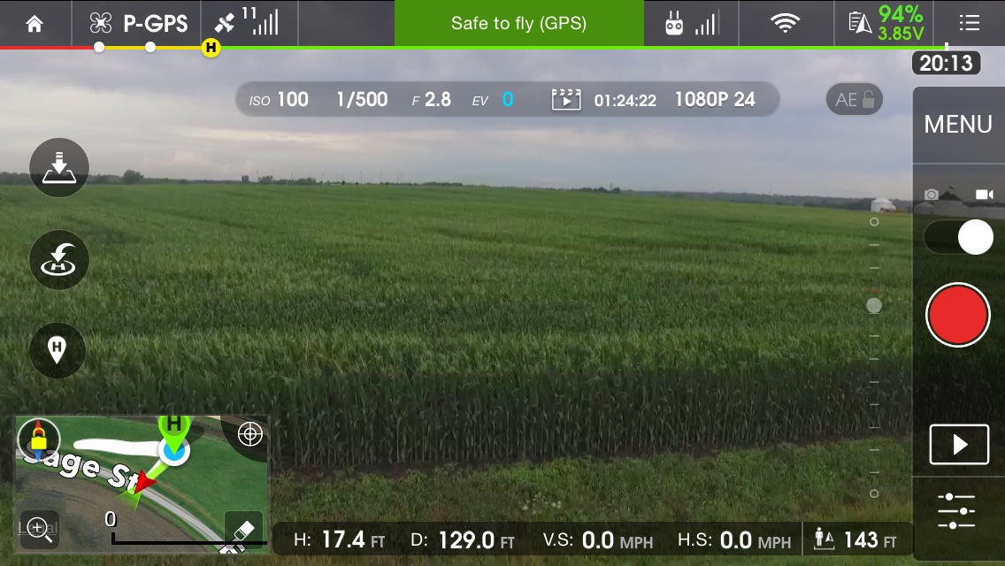

I had an Oh **** moment right at the end of the flight! I was within 1000 feet and starting the land when I got motor max speed errors, and the aircraft started spinning around three or four times, even though I straightened it out it was trying to autoland directly over a large cornfield! I've had this happen only on the standard when I load it down with too much batteries/weight!
With some half skilled, half luck piloting I managed to bring it over to the pasture I was standing in. Here's where the lesson begins! It landed upside down and still had preview and safe to fly GPS, so without shutting the controller off I walked over to it and when I picked it up the motor started to spin again and I was 500 feet away from the controller,so I had no way to dissarm the motors!! All I could do is hold it with one hand while trying to unplug the external XT 60 connectors and shut off the main battery with one hand! I managed it but it wasn't fun. I'm just glad I was able to Pilate it over to the pasture or else it would've landed in 8 foot tall corn that looks like a jungle[emoji41]View attachment 59105
