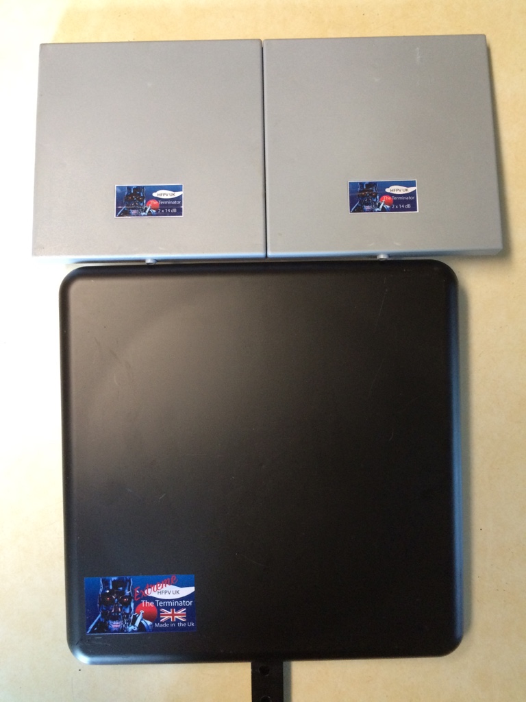

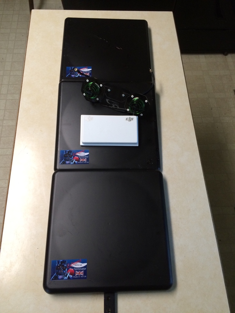

Just got home and got to say hello to the family, but here's an unboxing tease for size comparison!View attachment 57672View attachment 57673
Those look sweet!
db, they look bad !!! So one panel is the size of the Terminator then? Also, will the CTH fit all three panels? They look durable!
Those look sweet!
db, they look bad ***!!! So one panel is the size of the Terminator then? Also, will the CTH fit all three panels? They look durable!
I didn't order the stand from horizon. Just be glad that you did BeauS, because this is one massive set up!

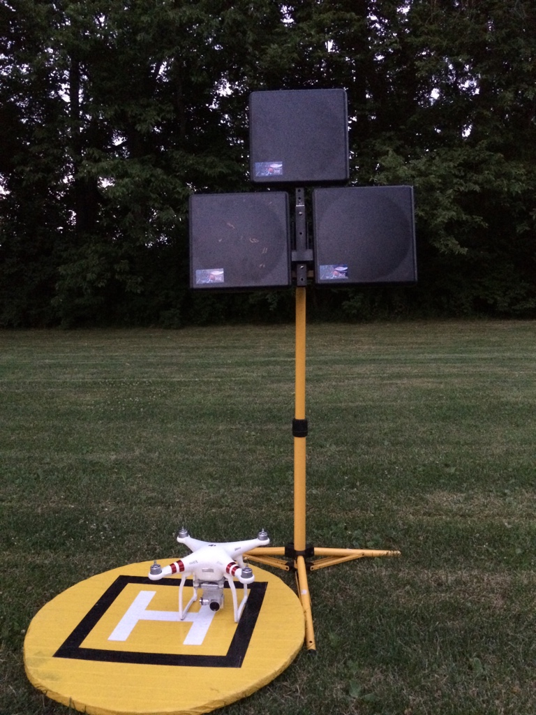

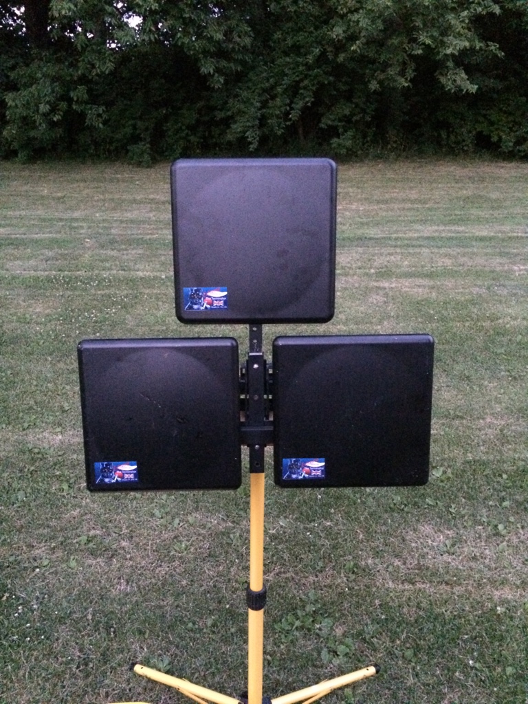

Here's a teaser of what I came up with, I may get to do a flight here in a little bit.
I see you already got a heavy duty tripod! Is that the way to do it, 5.8 on top, both 2.4's horizontal below? Can all three be set linear?
It comes with a heavy steel bracket that aligns it this way, and it should perform well this way.

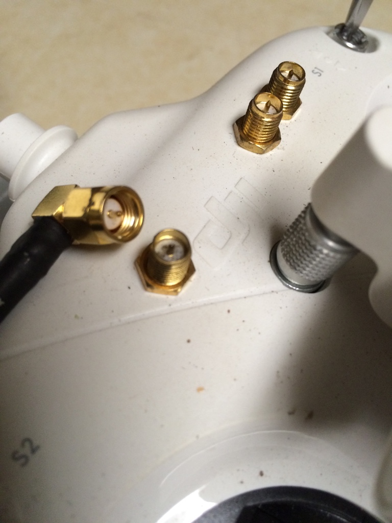

****, all that set up and then find out Horizon didnt use the fittings that EVERYONE of our controllers are ready for! SO disappointing!! I dont think I have (3) of that style of coupling adapters & even if I do I hate using adapters! **** you Horizon, what an oversight!
So just to clarify in case you're not following my other posts, this set up is not intended to go directly to the controller, rather it's intended to go through amps to make up for the possible signal loss of the extra long cables. That's why the cable ends don't match most of our controllers.

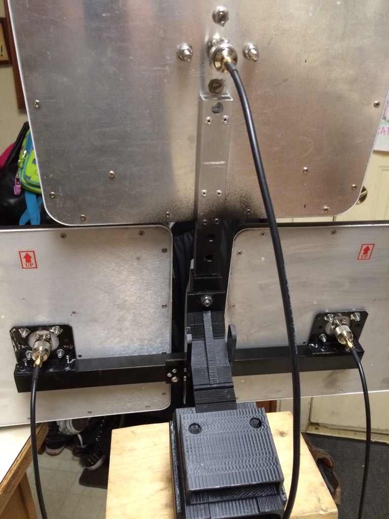

Its the other way round that's the RF input end to drive the AMPs the other end of that cabe ( RPSMA ) is for the RC side !.
Connecting procedure is , RPSMA end of the long black cable from the RC unit to the Input of the RF AMP ( SMA ) output of the RF amp using the supplied Silver plated cablesboth RPSMA, there is also an adaptor to the Panel as they use N type , so there is and adaptor on there to convert N type to RPSMA.
Correct , that the way its used. "That's why the cable ends don't match most of our controllers.'
They do match you have to plug them in correctly.
If you want to drive the panels direct then connect to the short silver-plated cables !, these are RP-SMA both ends.
