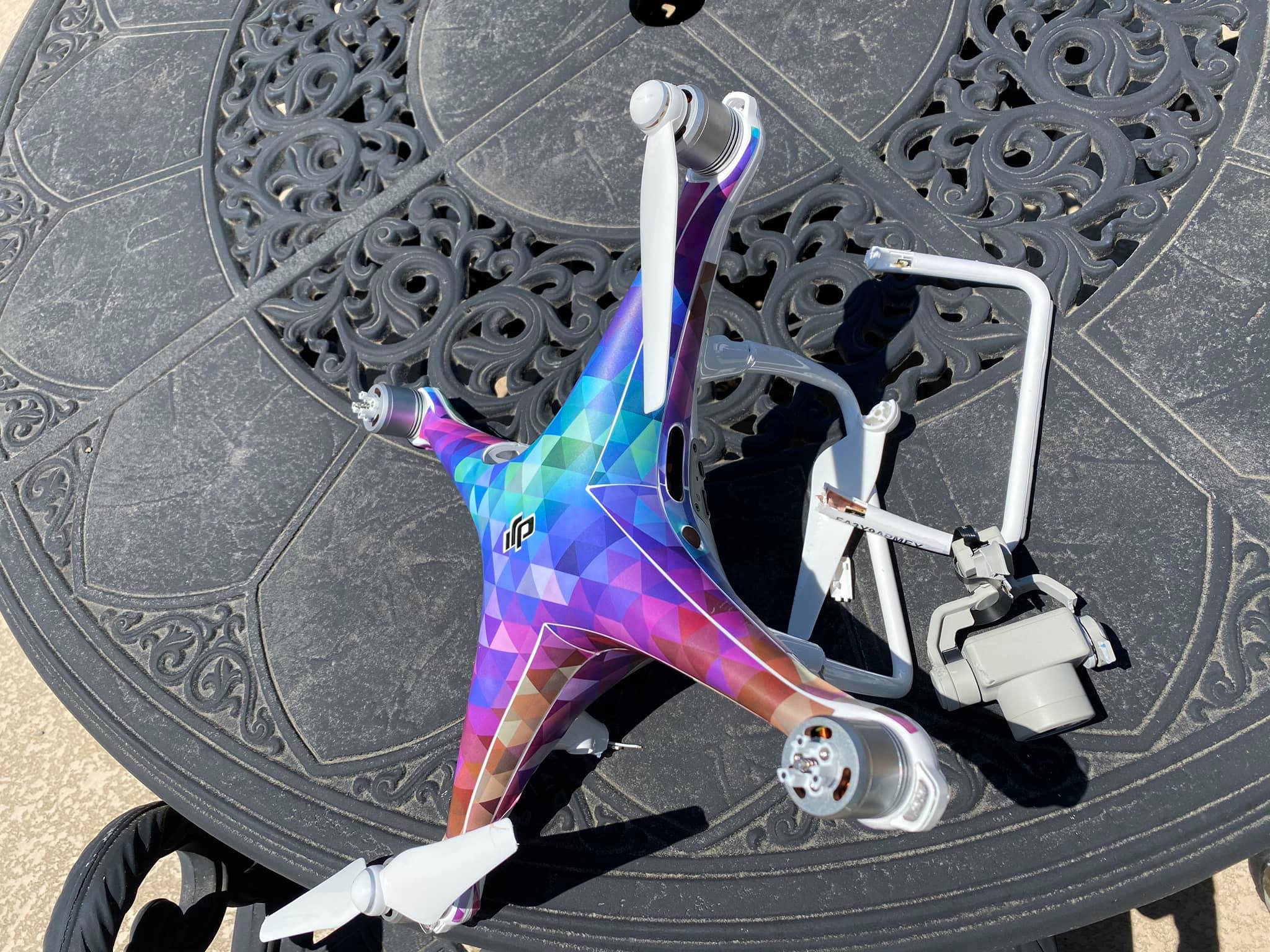

Hey guys - newbie here. Haven't done a forum in ages, but today on a real estate shoot after about 5 minutes of flight time, my P4 Pro+ lost power and just plummeted from about 200 feet up and crash landed on the roof of the $1.7 million dollar lake home I was shooting. After googling, I was able to pull the flight log, but have no way to transpose it. Also seems to be a common issue with these? Thanks in advance. View attachment 118580

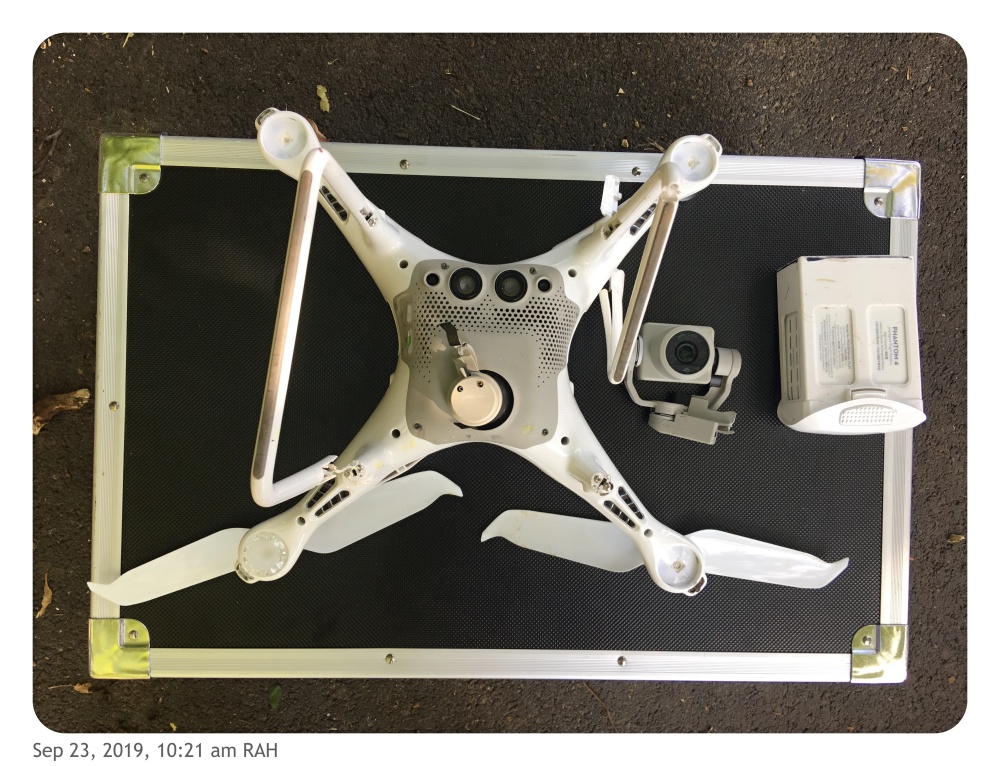

I'm confused (nothing new). Was the battery actually out of the compartment or dislodged when it crash-landed? In other words, why is battery ejection being discussed if the OP does not mention a missing battery (which it doesn't)?
I am so sorry to hear about your Phantom 4. I have read similar stories of the battery falling out. The batteries are know not to lock in 100% of the time. Part of my pre-flight check is to make sure that the battery is secure and will not come out. Not touching the release buttons I try to pull the battery out. It shouldn't! if it does then you may loose it. I also check my props to make sure they are secure too. It doesn't take much time but well worth it when you can bring your bird back home safely!
