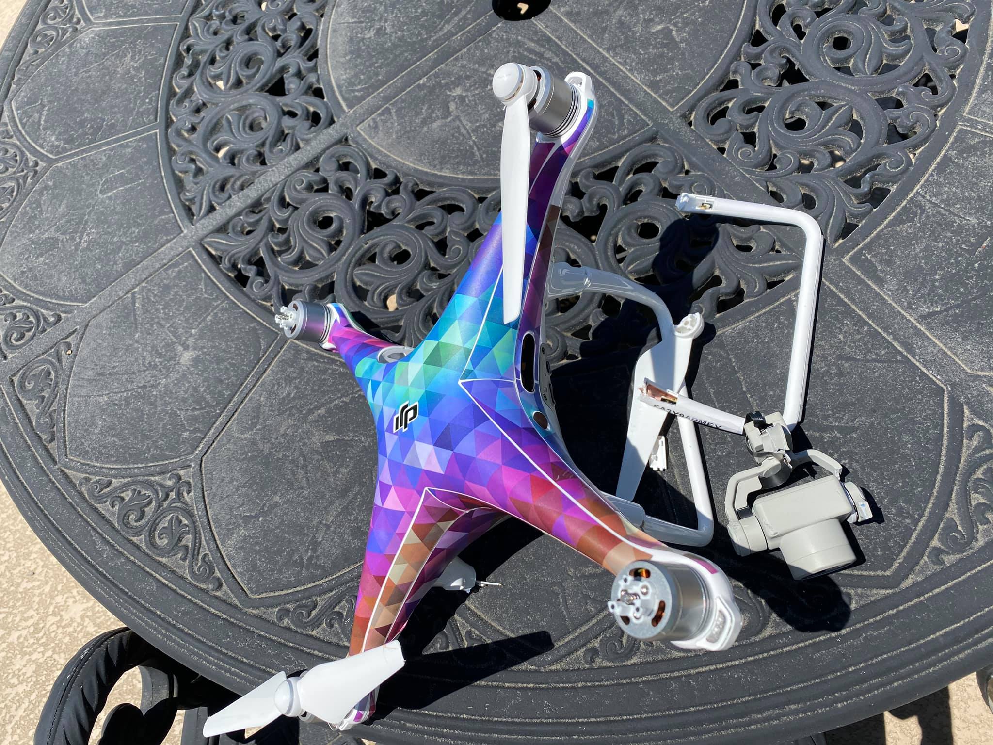

Hey guys - newbie here. Haven't done a forum in ages, but today on a real estate shoot after about 5 minutes of flight time, my P4 Pro+ lost power and just plummeted from about 200 feet up and crash landed on the roof of the $1.7 million dollar lake home I was shooting. After googling, I was able to pull the flight log, but have no way to transpose it. Also seems to be a common issue with these? Thanks in advance.

Hey guys - newbie here. Haven't done a forum in ages, but today on a real estate shoot after about 5 minutes of flight time, my P4 Pro+ lost power and just plummeted from about 200 feet up and crash landed on the roof of the $1.7 million dollar lake home I was shooting. After googling, I was able to pull the flight log, but have no way to transpose it. Also seems to be a common issue with these? Thanks in advance. View attachment 118580
