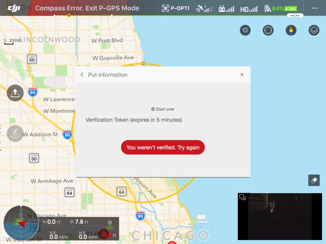

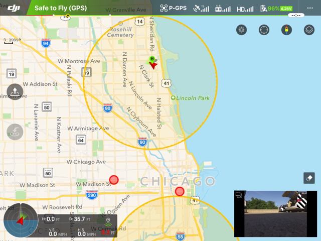

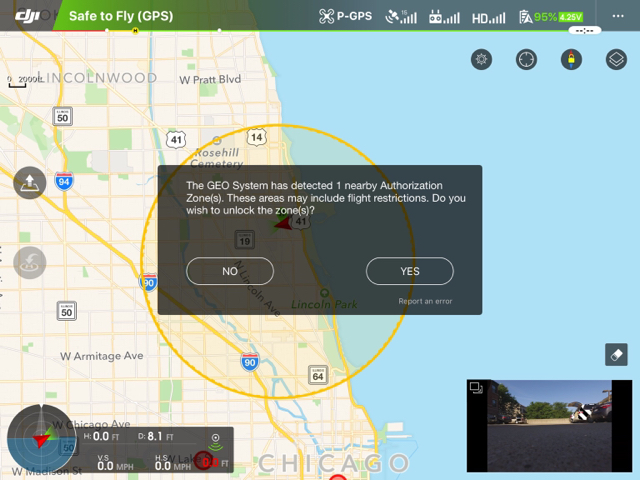

This morning in Chicago I'm having a problem flying because of a DJI restricted zone where there isn't one. The FAA has no TFR is in my area yet there's a large area of north side of Chicago that it won't let me fly. I don't know what to do.
Asks me for either my mobile number or a credit card, then when I try to verify the verification fails.
Again there are no TFRs in my area and I am plenty of distance away from the nearest sports stadium, Wrigley Field, there's no reason why I shouldn't be able to fly.
I did a restart of my iPad and the go app and that didn't help.
View attachment 62964View attachment 62965View attachment 62966
And what fixed it was to Delete the Go app from my iPad & download a new version & install.
Fixed!
