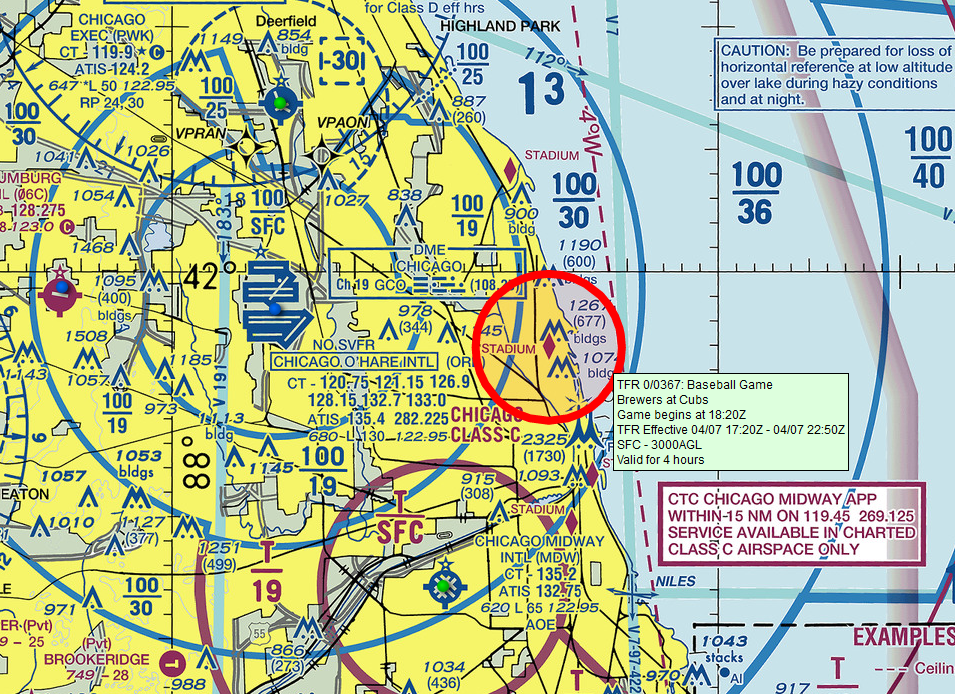

Skyvector.com is showing today's Cubs game. Might be to early for the Sox game TFR to post.
Appreciate that MM.

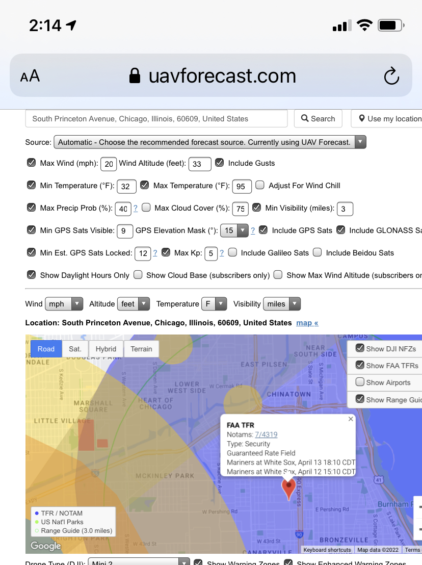

OK, May have found something on uavforecast.com. Looks like the TFR is # 7/4312. and if I read this correctly it begins Tuesday 4/12 at 15:15 CDT. - Which is 3:15pm CST right? But I believe that's game time. So doesn't seem correct. I' think the TFR has to start earlier as people will be filling the stadium a couple hours before game time
But am having a frustrating time finding where I can search for upcoming TFR's. And finding this particular TFR on any of the FAA sites.
Anyone have a link for where I can search for a NOTAM by number or upcoming date and location? It should be easier than this.....
Ok then. I am still baffled that the only place I could find evidence of the TFR fir 3 consecutive days at Guaranteed Rate field - 4/12,13 &14- was on UAVforcast.com.
Even on tfr.gov the last TFR shown was 2/28/22.
On DJIGO4 there absolutely should be a huge red zone that shows the dates/times of the TFR.
Am I the only one experiencing this?
Also - still asking- is there a way to search for a NOTAM by its number? As shown in above screenshot, the NOTAM number is 7/4319.
I’ve not find a way to look that up.
